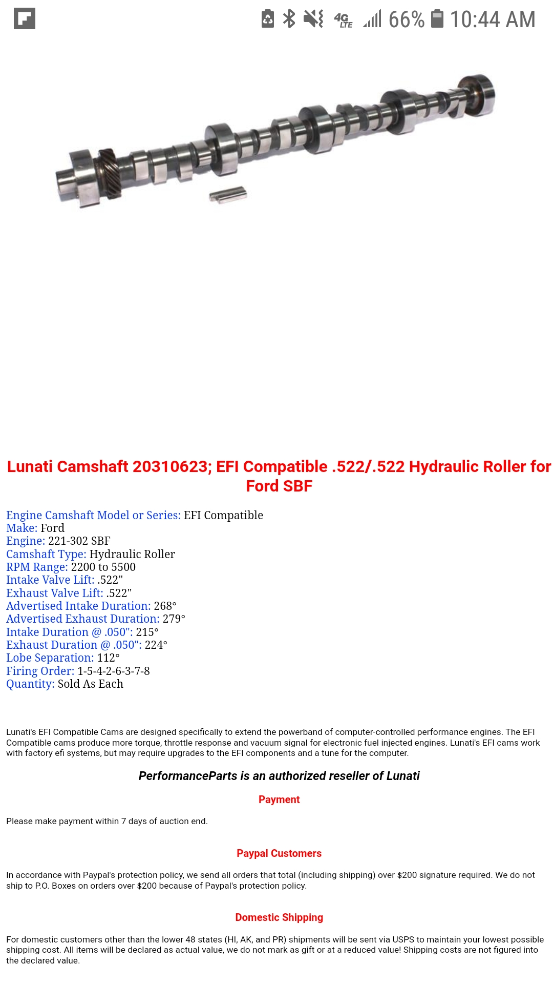

This is the one I'm looking at.

Absolutely a must check. The clay method is cheap and pretty quick. I would do at least two cylinders. My Gt 40 heads cleared my trw forged replacement pistons. My AFR 185s with larger valves hit.
I'm not a cam guru, but that cam looks okay for a stock 302. My Crower is a little higher lift and duration (with my 1.7 RRs) with no issues using 3-bar GT40s. I agree with others that the clay check method is best bet.
