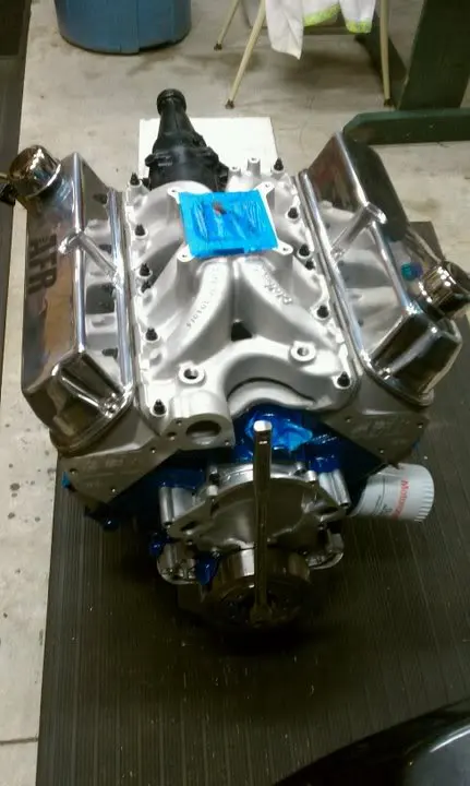

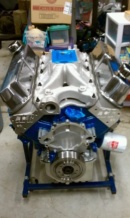

I ordered an Eagle 408w kit from Frank at super engine builders up in IL. Ordered it with a few options, eagle armor, L19 bolts, 0 balanced, sfi flexplate and SFI damper. Picked up a plethora of stuff from Summit as well. AFR 225 58cc's, Eddy Vic. Jr., AED 850 H.O., Meizere electric w/p, msd distributor, etc.

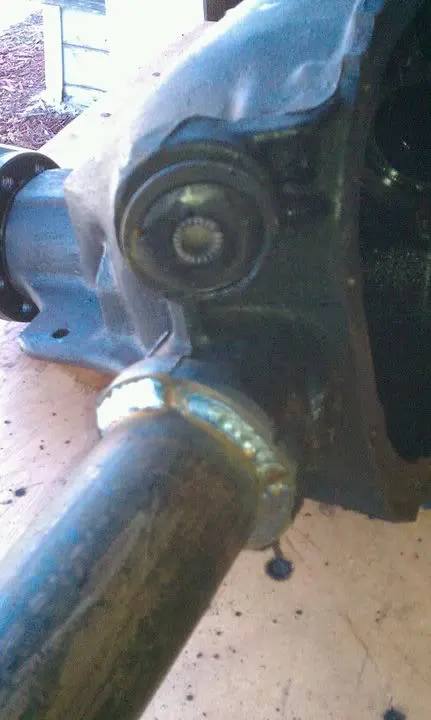

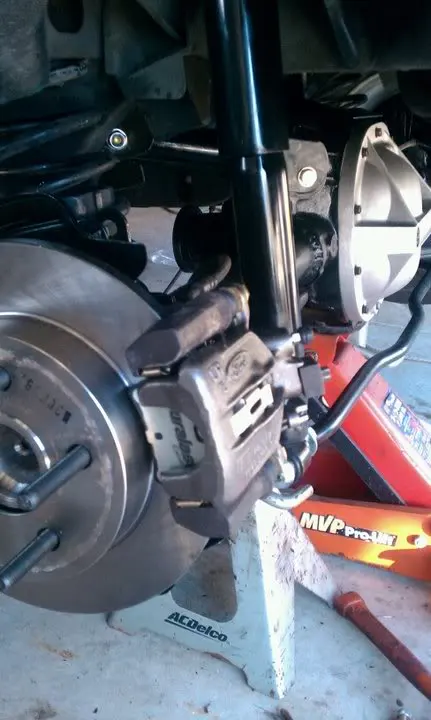

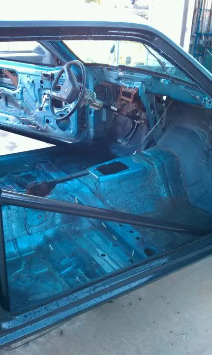

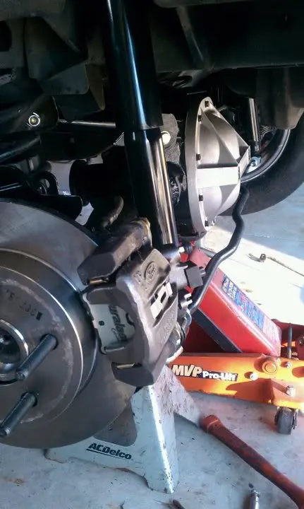

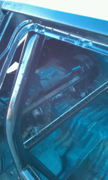

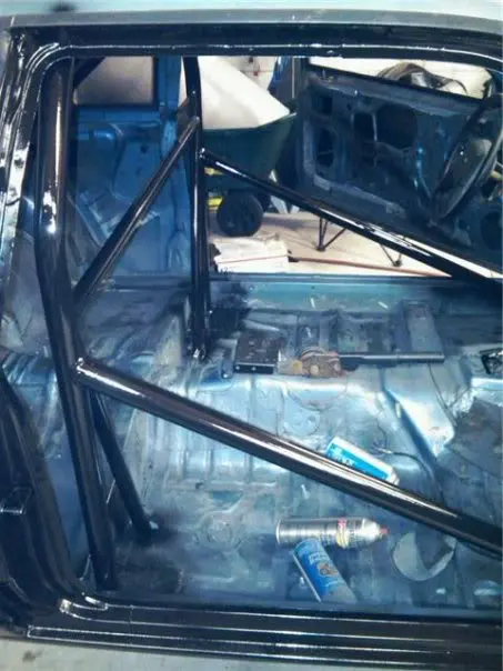

Ordered a roll cage from Jegs along with a set of BBK subframe connectors with the seat brackets. I bought a 94 GT roller and took the front spindles and rear brakes. I did a total rear end rebuild. I used SN95 length Moser axles in 31 spline, with the 31 spline FMS Cobra carbon fiber unit. Topped it off with FMS 4.10's. I welded the axle tubes, and swapped the rear disc brakes over to my 8.8 housing after fitting it with all new bearings and seals.
I did a torque box reinforcement kit from UMI yesterday and welded it all up so I could install the rear end. I bolted it in today with some tubular upper and lower control arms. I have done much much more than I have typed and I'm sure I have left some things out.

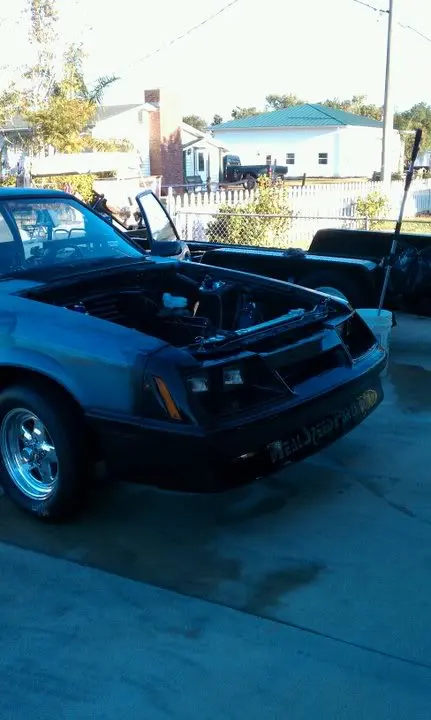

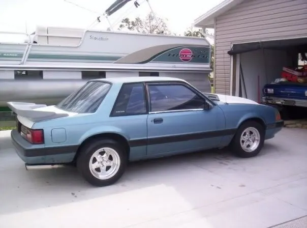

I will start off with the oldest picture of the car I have.

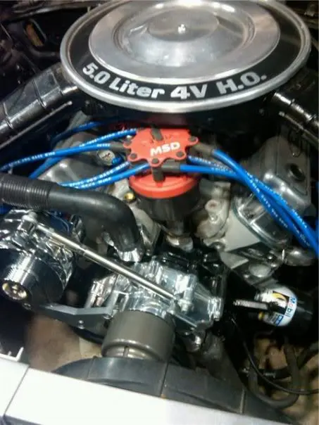

Old engine 302 GT40X TFS 1 and T5.

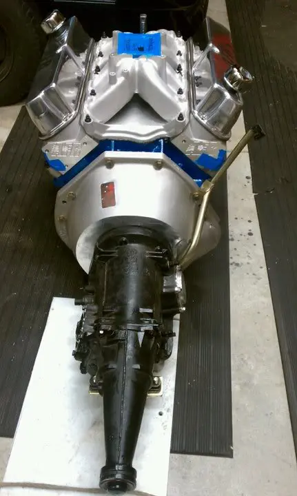

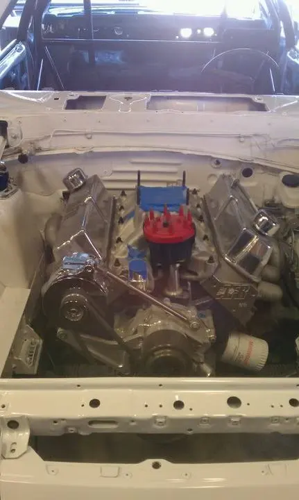

408w

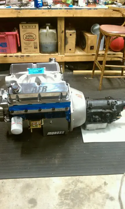

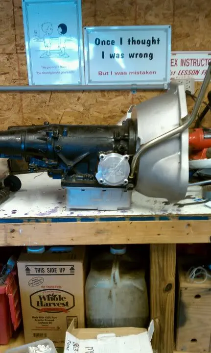

PA Super Comp C4 w/3800 Stall

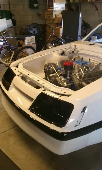

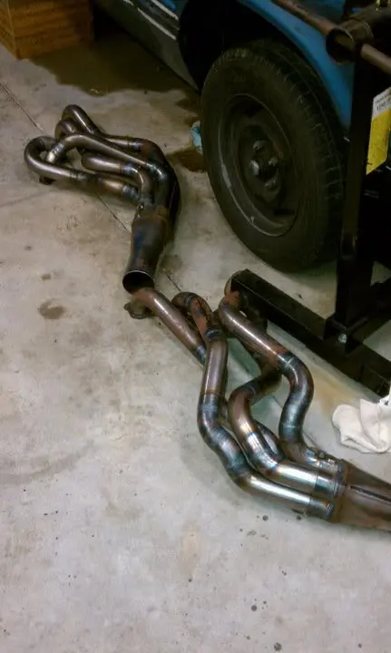

D&D built headers for 351w based fox 2" tubes 3" race collectors.

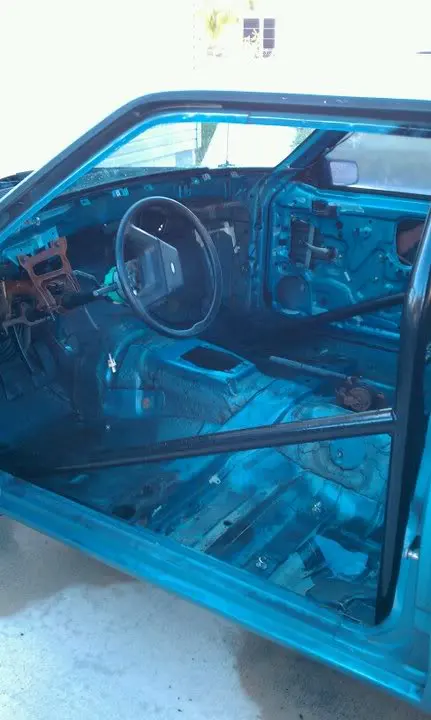

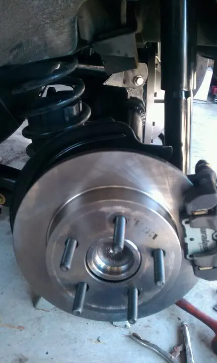

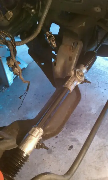

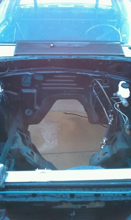

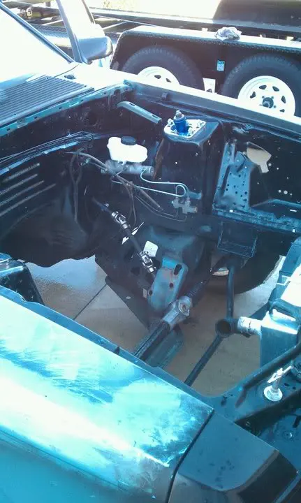

Manual rack, steering shaft, 94 Gt master cylinder, gutted PV, Maximum Motorsports 3-2 port conversion, BBK caster camber plates. engine bay is getting holes filled and smoothed and repainted next weekend. Bought the scott rod panels in Aluminum and bought a welder for the rest.

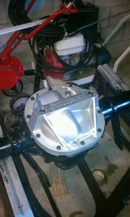

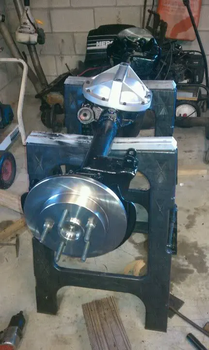

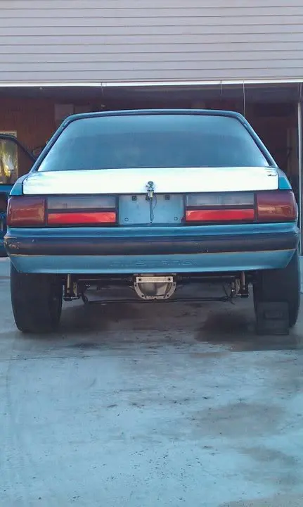

8.8 Rear

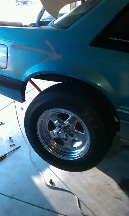

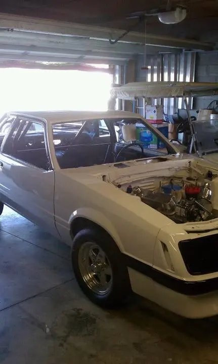

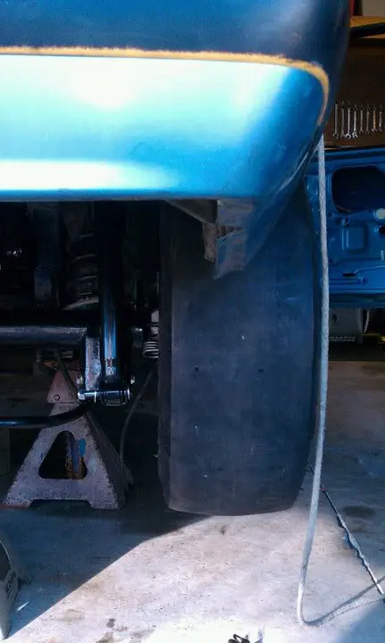

Wheel and tire fittment 15x8 Summit brand star wheels rear and 15x4 front
M/T 26x8.50x15 rear and 25x4.50x15 front tires.

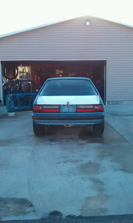

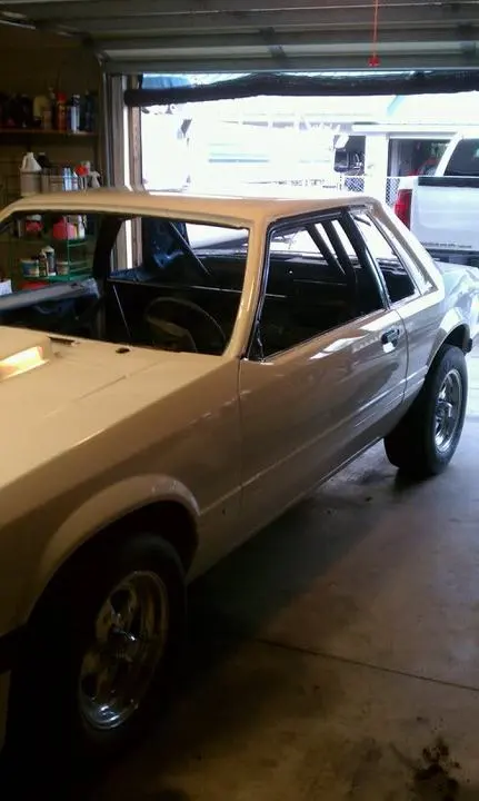

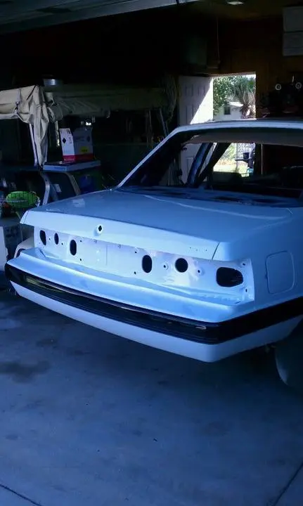

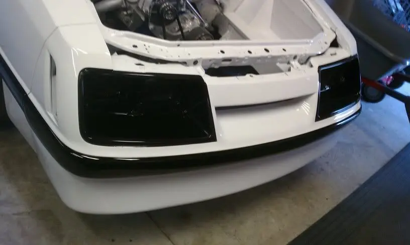

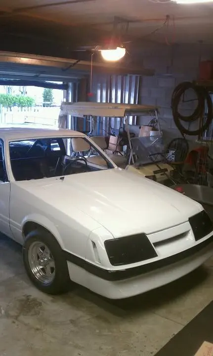

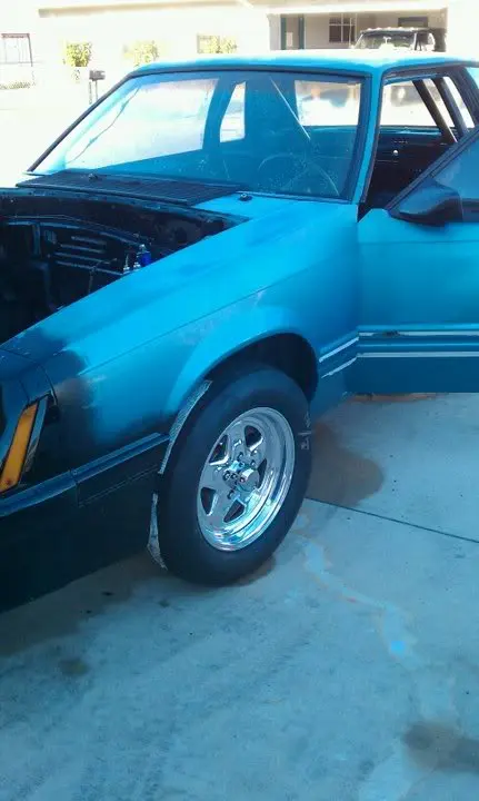

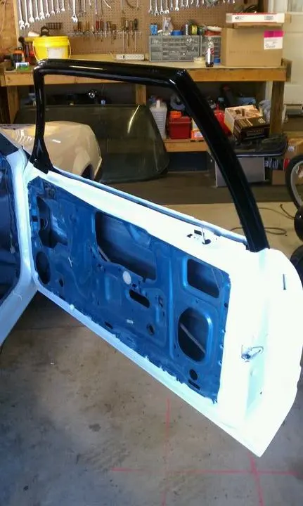

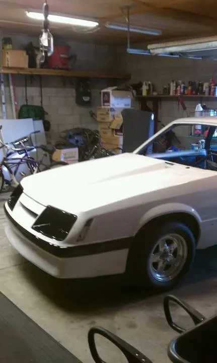

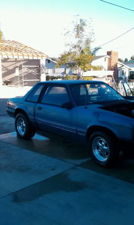

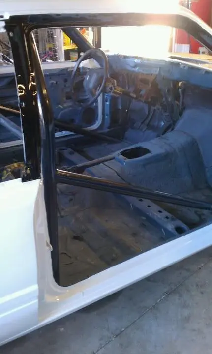

Couple of the body shots before paint.

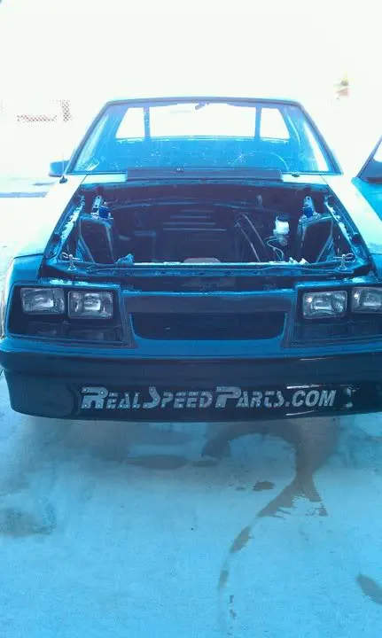

I am not affiliated with this company, bought the front nose used from craigslist.

I had Bob at D&D make a custom set of headers from my fox since AFR 225's have the larger bolt pattern. Along with the custom headers, I needed to install a manual rack and flaming river shaft for clearance issues.

408w
