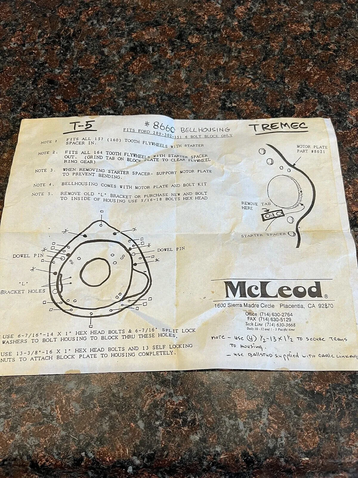

While investigating the same bellhousing I found this photo of the instructions.
In the lower right there is a note regarding the bolts for the transmission.
