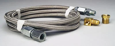

also i've seen those braided lines, where would i get one of those? it seems like it'd be kinda hard to route the copper around under the dash, like it'd bend/break, anyone have any problems with that?
people with copper have complained of it chattering. braided is really nice, but $$. im interested if anyone has links to places with cheap braided line. :)
The copper's not difficult to route, or to keep from bending/breaking. Literally millions of cars with a/c and expansion valves have small diameter copper line routed behind the dash with no problems - between the valve and the a/c switch. Braided's great stuff, but you needn't worry about running/routing copper if that's what you want to do. Keep in mind, the braided stainless covers the tubing carrying the liquid - it's usually a teflon or nylon material inside the braid. I'd just route a wire.
You could go the braided line route but it is more expensive $49.75 VS $8.95. Also I have found the copper tubing a lot easier to run because of it's diameter being so small. It is like running something a little larger than a coat hanger over a bulky braided hose. This gives you more room to work with especially when trying to mount the gauge on the A-Pillar. But if you choose the braided tubing kit you can buy it Here .
