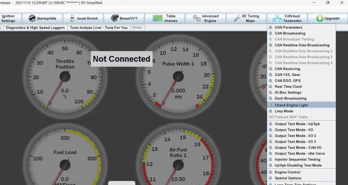

Yes, you can enable a CEL with Tuner studio that will trigger the check engine light. It doesn't quite work like a normal check engine light.
The menu for it is under "Canbus/Test Modes"

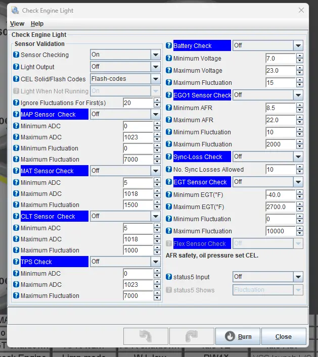

Under "Light output" you can see what pin on the MS it's wired to the output of.
As you can see, what you are really doing is setting MAX/MIN specs for various sensors. If it ventures outside that range, it will trigger a CEL.

Thank you!! I will check it today!

Well, I’m unable to find anything in tuner studios for light output or check engine light under canbus. I’m using a MegaSquirt gen2.
Check this for Esses and Geez:
If you don't see the Check Engine Light option:
  • Ensure Advanced Menus Are Enabled:
    • Go to Options > Preferences.
    • Set the interface level to Advanced.
