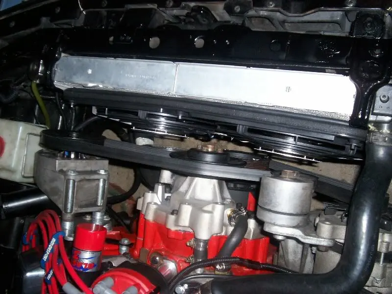

I have custom brackets from work that i will fab up to make it work. Heres what it looks like right now (dirty as hell) with the 5.0 thunderbird water pump pulley on there for standard rotation. I gotta come up with a different routing now that im going with the CSI pump:

Thanks man thats a neat setup, you don't have much belt wrap around the water pump, knowing my luck it would slip haha ! hey if you get something fabed up with power steering let me know i wouldn't mind running an electric water pump......... thanks again sorry to hijack your post
