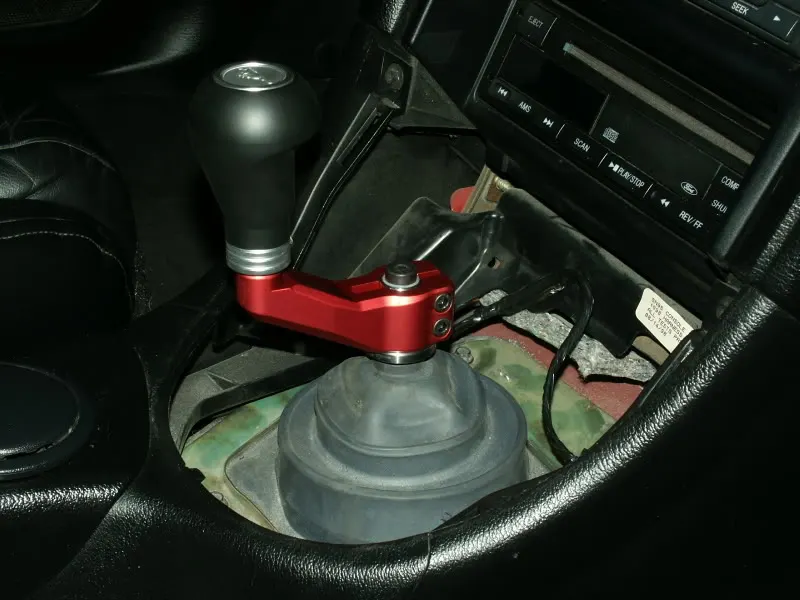

Hey GDawg, is that the MGW composite knob in the pic? If so, me likey. I also ordered that one but with the GT logo in silver. Can't wait for it to arrive.
Yes... I was going to get the "GT" one cause that's what my car is but I decided on the pony instead. It goes with the developing style of my car.
They are really nice knobs and...
...the best thing about them... is the "Pistol Grip". I can grab hold and slam my shifts comfortably. I love it!!! :nice:
