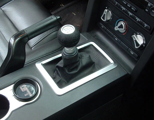

Gripper
If you don't mind. Post a bunch of photos of it installed and give us a review. I'm running the MGW Black Ball but want something else and that's my first choice as of right now.
Hope you can see this
I like this shifter knob a lot. Very nice in the cold of winter or the heat of summer. Like all MGW stuff, top shelf.
