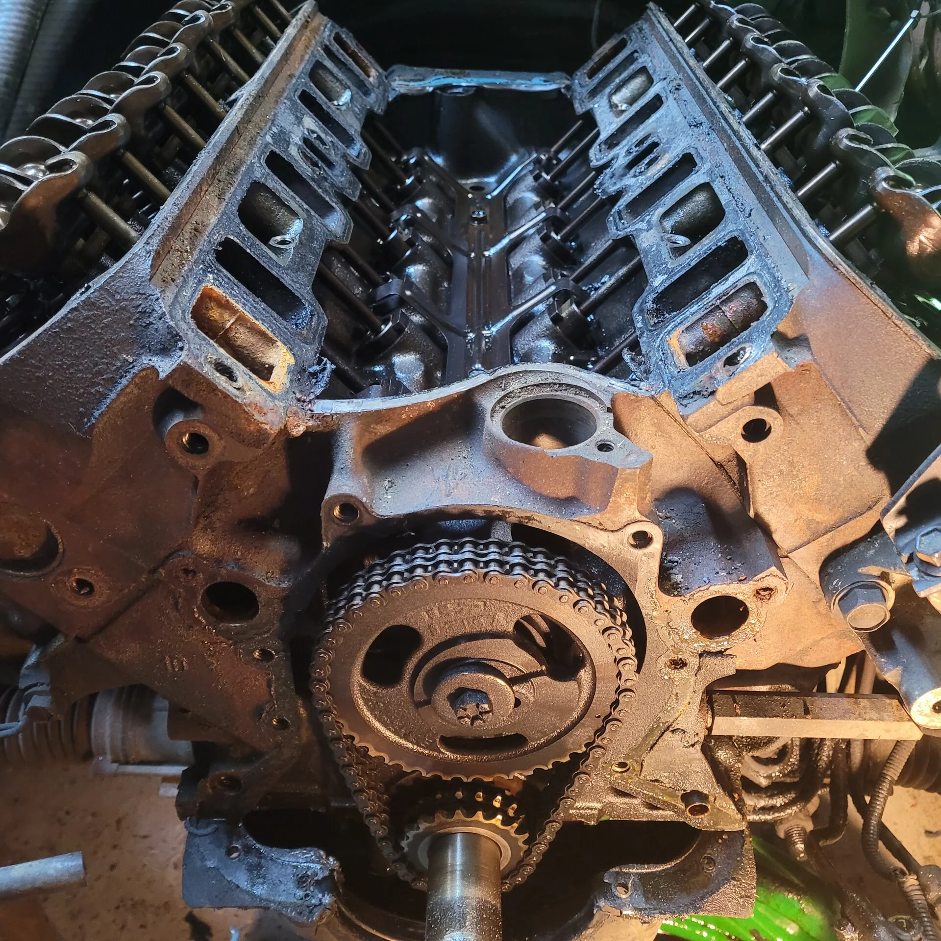

Finally has time to do the tear down. As suspected, no eccentric. I'm assuming I can bolt on an aftermarket one. So now that I'm down to the block basically, are there any no brainer simple upgrades I should make before I start bolting everything back on?
