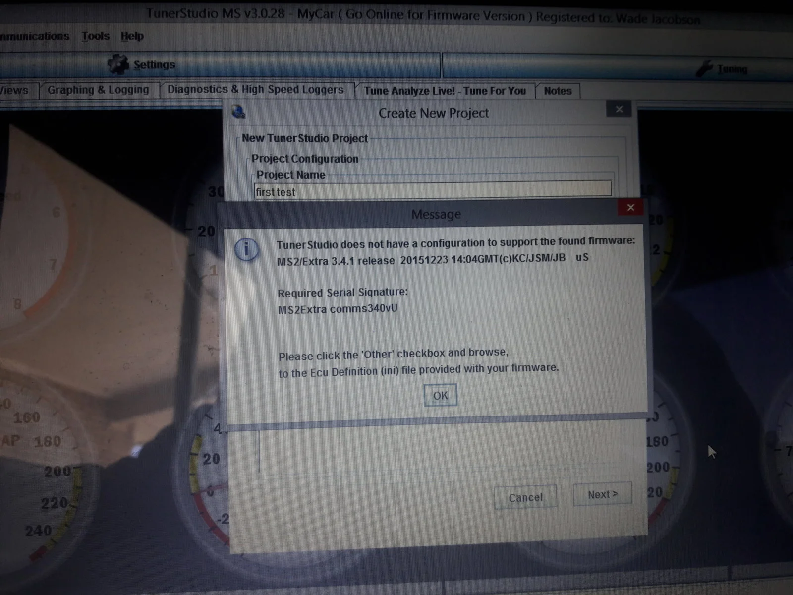

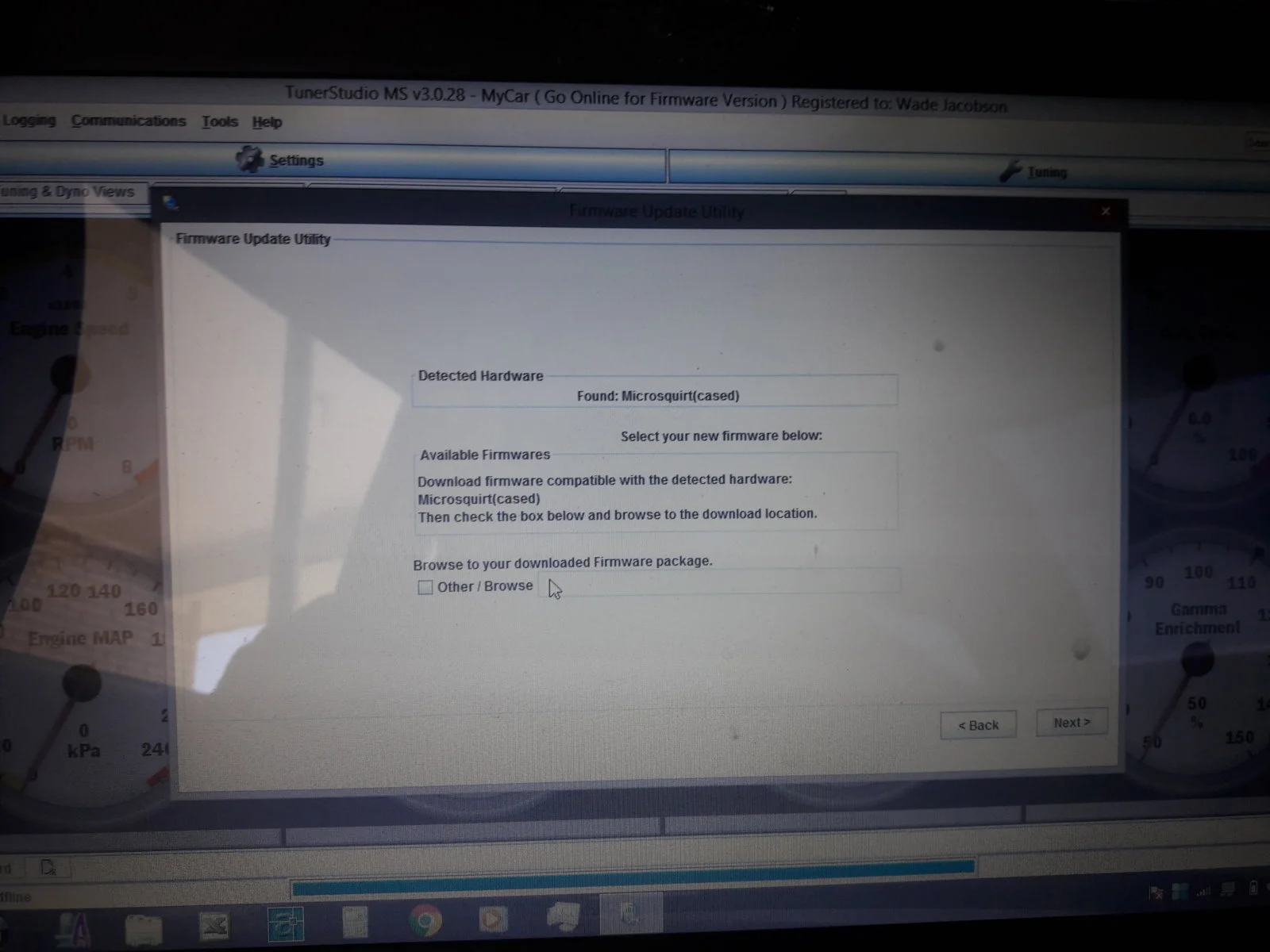

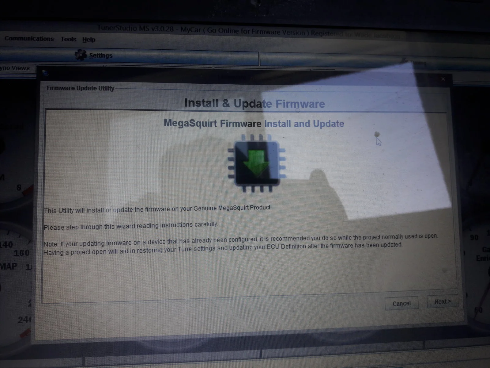

Ok I played around with it and got it to connect however now it's saying "TS does not have a configuration to support the found firmware MS2/Extra commms340vU Required Serial Signature: MS2Extra comms340vU (see pictures) not sure if I should click on these? do I need to get updates for TS first? sorry this is not working smooth as I thought it would I just don't want to click the wrong thing!
You need to find out what firmware you are currently using. The firmware number is at the top of the screen when you are connected to the ECU.
You have to download the firmware from the website and place it in a file you can find on your PC, you may want to read the manual found at msextra

so I was able to get it all working but I had to go buy a 150 ft Ethernet cable and run that out too the car so I could get internet service to download the correct files so now it's working ish not running all that well so I'l have to play with it some more! really wish there were better YouTube videos out there on how to do the initial set up and tuning on a stock 5.0, all the good videos are from guys with turbos and they are just showing what they have done not really instructional how to vids, and for the most part there's no instructions!
