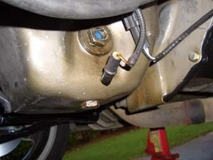

might be why its stalling...wtf is it

Umm this might have something to do with it stalling/surging/hunting/hot starting... what sensor or valve is this and why isnt it plugged in the side of the oil pan? Just had a clutch in doubt they would take it out. would oil be shootin out of that driving? oil level said ok??? what is it?

agree oil level, don't think you will get anycodes from obd2 for a oil sensor it's only for dash, but you might get other codes that might get you your problem. Run a KOER Test.
I took mine out... and mounted my Oil temperature sensor in that spot. So far, I haven't had any problems but I also have not tried dumping the codes lately.
I get no CEL / Check oil lights with it unhooked and disconnected.
Dump the codes and see what the computer says is wrong…

That would have absolutally nothing to do with your car stalling/surging/whatever. It will however piss you off if you ever run out of oil. No oil should be shooting out of there, and if you see any coming out you need to replace the sender. Is this from the 306 in your 2000?
