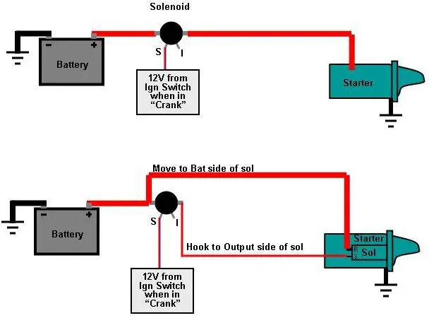

You probably fried a wire. Make sure the solenoid is grounded (bolted to the inner fender) and put a test wire from the Bat + to the "S" terminal on the solenoid. does it click? If not, the sol is probably bad, if it does, then the wire from the ign key going the the "S" might be the fried wire. Check it out, it should have 12V when in the crank position. A volt meter is OK, but a test light or the solenoid itself is a good way the check it. Also don't forget the park/neutral safety switch if you have one.
Here is a diagram of the before and after wiring:
edit: I now see you have a '89, I don't know what the solenoid is like, but I assume it's very similar to the type from the 60's and 70's.
