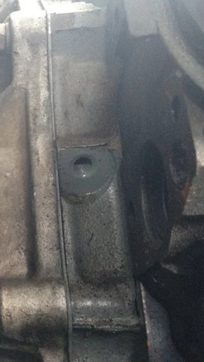

I found this bolt hole behind my pass. Side head. It's on the block next to the bell housing. What is this??
