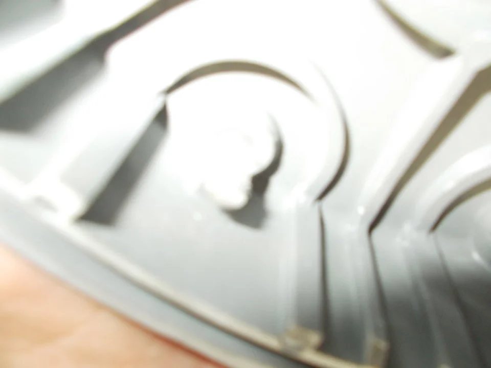

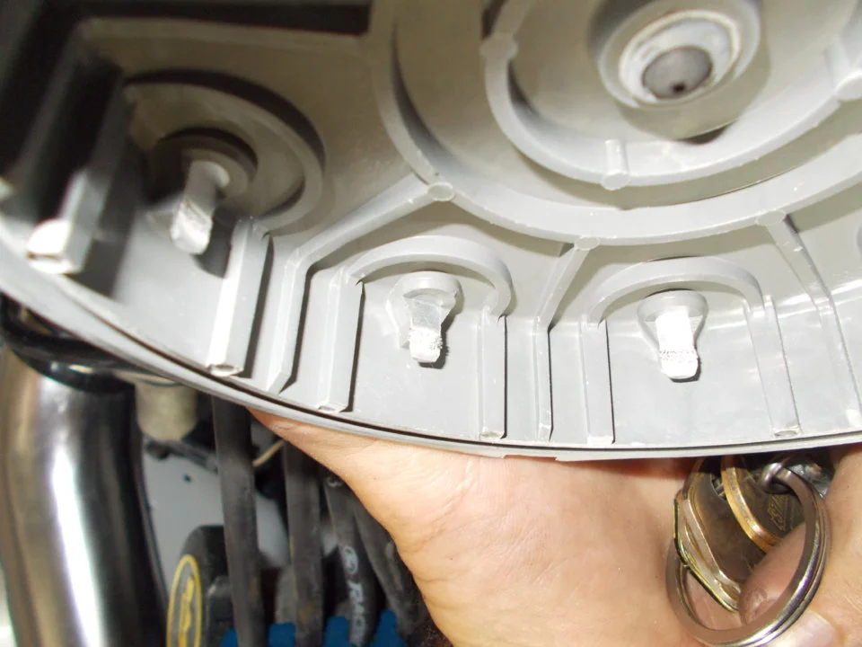

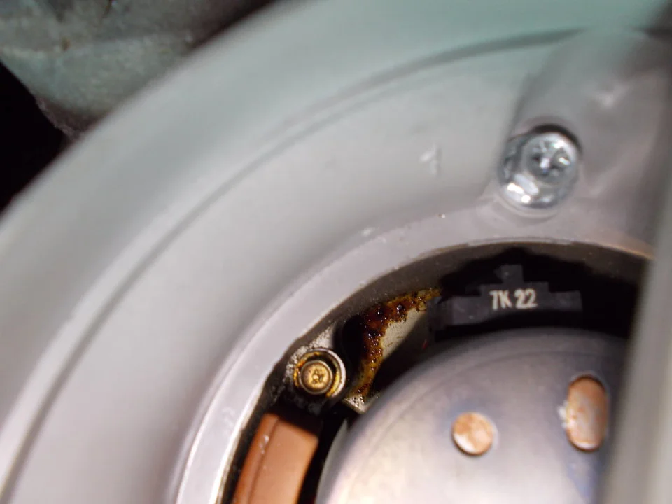

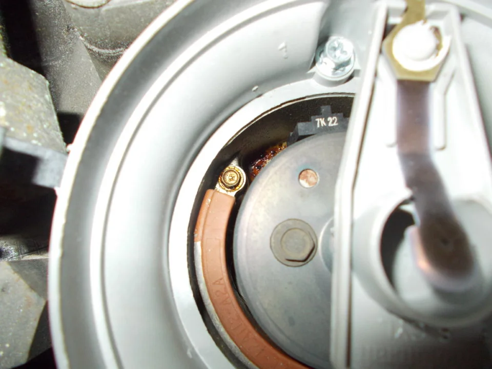

So today I pulled the cap and discovered what appears to be oil (?) in the bottom of the distributor. Now I'm no master mechanic but I don't ever recall seeing oil down there. Also, all of the contact points on the bottom of the cap and the rotor contact area were covered with a white chalky substance. This car has always had the smell of running a bit rich but I figured if it wasn't broken I wasn't going to mess with it. My main concerns are the apparent oil and white on rotor and cap. I'm assuming the iginition system is getting hot and causing the build up? I've attached few pics. Let me know what you guys think. I'm figuring this is the source of my issues but what is causing it.

The build up is normal. Clean with scotch brite or if you haven't done sui in a while replace the cap and rotor. As for the oil, is it on the outside? If it's on the inside well I've just plain never seen that happen.
