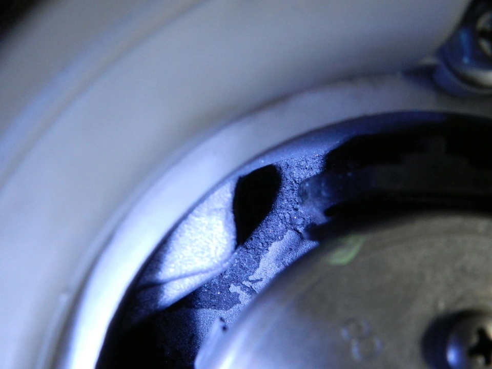

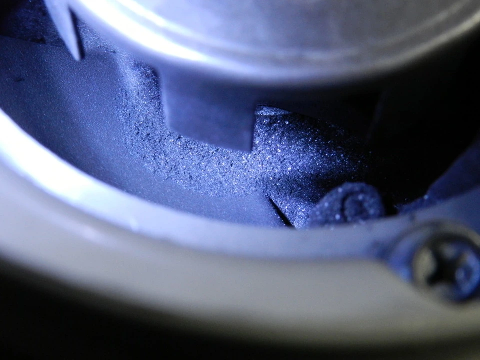

Just poppped the Dist. cap and looked for problems...Found this...

Car has a brand new distributor. I know new parts fail but I dont have money to start replacing all these brand new parts again...
Brand new as new or new to you. Was that a reman distributor? My guess is if you pull the distributor you will see signs of where the PIP sensor is making contact with the vanes.
