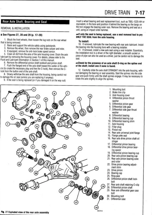

When I replaced the pinion bearing closest to the pinion nut mine had a very flat washer behind the pinion seal A.K.A. (oil slinger). I wouldn't think it would be a problem to run without it but I guess it is possible that gear oil could leak past the pinion seal . Part #13 of the diagram in the link below is the oil slinger.
http://www.3.8mustang.com/forum/attachment.php?attachmentid=25817&d=1076033800

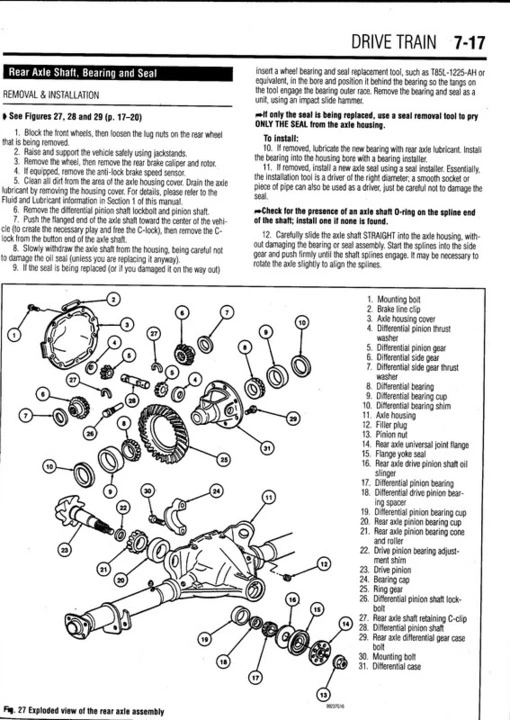

yes there is an oil slinger see picture below part #16...without this oil slinger you can damage the seal when torqued down which will cause it to leak and i believe it helps in oiling the bearing....are you sure it eas not stuck to the back of the seal...
