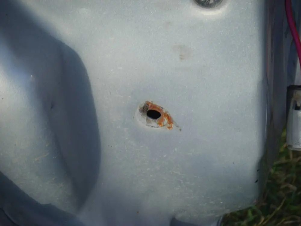

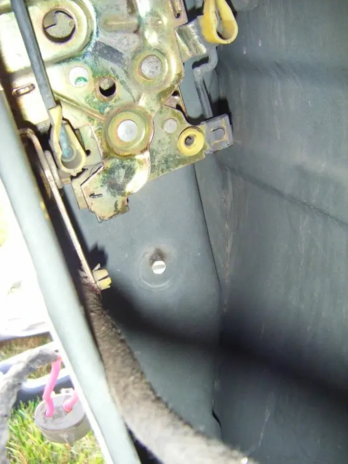

Here are two pictures of the locking area.
I beleive that hole in the side of the door...is where the actuator use to be rivited/screwed into the door.
Am i correct?

IF your old actuators froze up, someone probably removed them (when they freeze, you cannot use the key to lock or unlock the doors). I would recommend doing the JRichker aftermarket lock actuator retrofit. The actuators are like 5 bucks each and the retrofit takes maybe an hour and a half for two doors.
Do be sure (before you start) that when you put a test light across the terminals in the actuator plug, that you have the light illuminate while the lock and unlock buttons are depressed.
Anyhoo, it's not a big deal to get it fixed up.

So is that hole in the picture I posted indeed where the actuator is normally rivited to the door?

Since your rivets and the plastic mounting brackets are missing, it would be easier to just mount the lock actuators to the door skin itself. I installed my aftermarket ones that way when I put in new actuators a few years ago, after going with a couple of sets of "good" used Ford ones. I used one of the existing holes (the silver screw on the left) and drilled a new one (the silver screw on the right) to mount the actuator parallel to the lock rod. Plus I used spade connectors on the ends to plug into the Ford harness plug.
