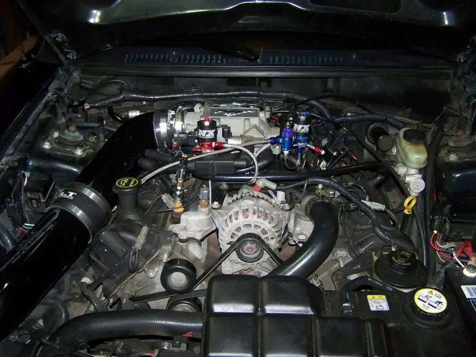

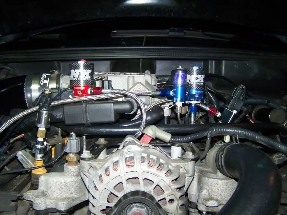

Well I finally got around to installing my NX 2v plate kit system. I must say, that kit is sweet. I was thinking of sticking the 100 jet's in, but decided to not be a :taco: and went with the 150's :D. I must say, with the addition of finally putting some 4.10's in (vs stock 3.23's), that plate kit hit's like an EFFIN FREIGHT TRAIN compared to my old Zex kit. Anyways, here's a picture of it installed:

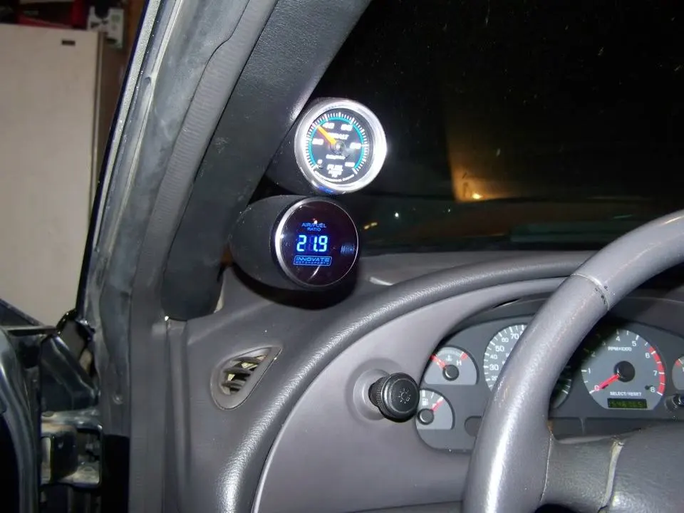

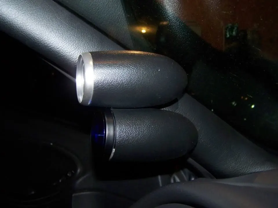

I also called up Alan at Speed Of Sound and he hooked me up with a gauge pod. I then called Mike at Quarter Mile Mustang and got me a killer deal on an Autometer cobalt electric bottle pressure gauge, fuel pressure gauge, and an Innovate LC-1 wideband.

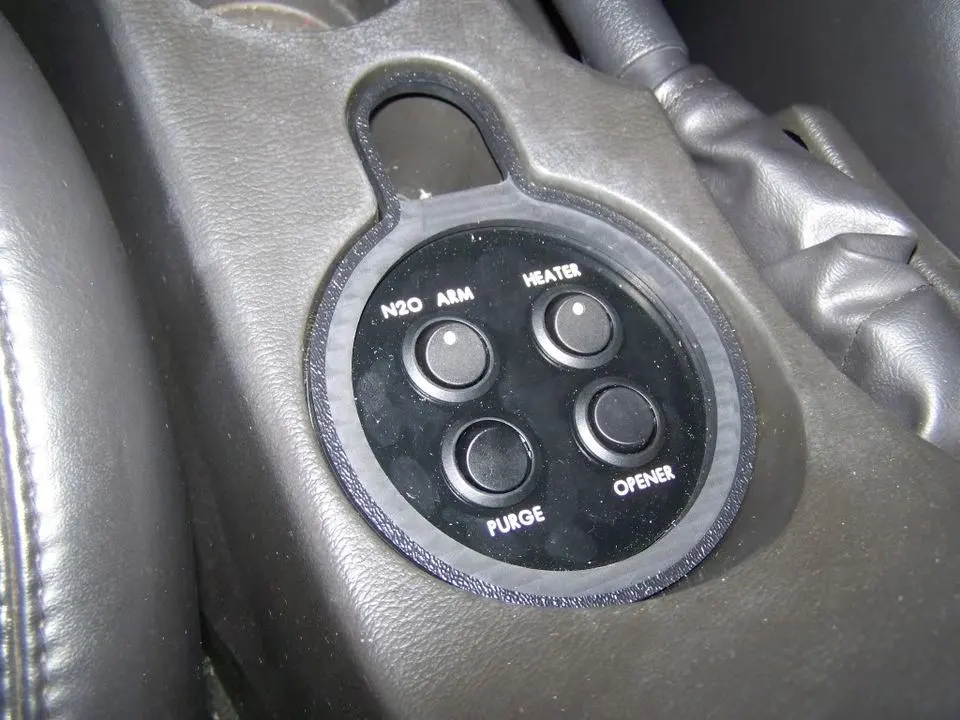

Last but no least, I called Alan at Speed Of Sound again about a switch panel for the nitrous. Needless to say, he sent me a switch panel that is probably one of my favorite parts of the car.

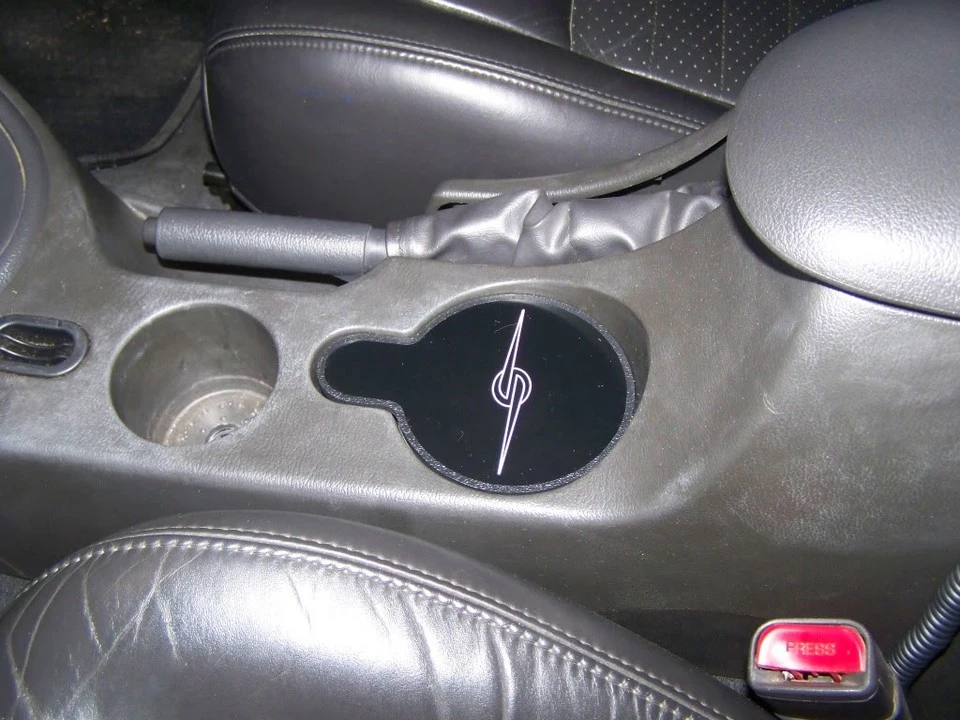

The switch panel is not something that he manufactures. They are custom made to order. It comes with a protective cover to keep anyone from accidently pushing any buttons, or spiling something on it. The quality of that switch panel is perfect, and fit's very snug compared the the switch panel I had before from Steeda that went in the front cup holder.

@ Green&Gold - The part where the shradder valve used to be is the fuel pressure sensor for the Autometer. I am using an SVT focus fuel pump and NGK TR6 spark plugs

The Zex was rated at the flywheel and the NX is rated at the engine. Even if you pill the plate for 125 you will be making more power.
I'd personally back it down some and put it on the dyno. I know on the 2011s that a member picked up 140 to the wheels when pilled for a 125 on a plate kit. I'd hate for you to get greedy and pop the motor
