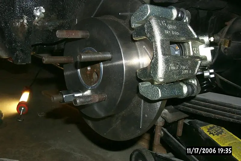

mocked these up last week, thought Id post a pic while the car is still getting the cage installed:
Since then, Ive bent/plumbed the rear hardline and so on. I'll post a few more if I can find the camera again in my rat's nest :rolleyes: The brackets and calipers fit perfectly.
Im also taking pre-orders on my snazzy, custom-made axle housing support stands. Guaranteed to take 2 seconds off your lap times :rlaugh:

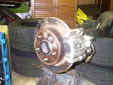

Looks good LMan. I'm doing the same on my 69. No splash shields for me although if I had them I would likely run them. I should have under $400 for my setup including the slot rotors and braided hoses. I also fabbed a simple emergency brake mount tab I think will work.
-Stephen

joncash said:
Are you planning on using the splash guards?
Nope, car is track-only. I plan to use the splash-guard bracket provisions to mount brake-duct hoses.
Also, have you worked out adapting the brake lines yet?
Already installed. Ultrastang gives all the details in his instructions...basically, 95-96 Mustang GT rear brake hoses and a pair of muffler clamps. Simple and effective, two qualities I am fond of.
I'll post some pics of that in the next day or two.
I won't make any more jokes about your "workstands":rolleyes: .
Ah, go ahead! I started it..... :D I pick on other folks here (all in fun), its only fair I get poked also :nice:
10secgoal said:
What's it going to cost you when it's all said and done ?
Well, Im kinda a cheater cuz I got the calipers for only 25.00 :D I wouldnt expect every set to be that cheap but they are widely available with all the late-model Mustang sTuNNa bOYz taking them off to 'upgrade' to Cobra rear discs....
but otherwise
Ultrastang kit 150.00
hoses/clamps/line/fittings ~35.00 total
total 210.00
time- cpl of hours to mount calipers and bend a little tubing. I was slow since there was a good college football game on that afternoon :p
-Stephen
Nice! I have a restomod buddy who's doing the Ultrastang kit for a 'vert in his shop...I will pass along the e-brake info to him since he was asking me about it yesterday (Im not using an e-brake so I couldnt help him).
First off, thanks to you guys for using my setup when you could have used anyone else's. I appreciate your business.
Secondly, you don't have to use the splash shields. I designed the brackets to be able to mount them if the installer so wished. The shields would be more important on a vehicle that's driven on the street than the track --and besides that, the shields are less than $11.00 each, brand new from Ford, so they are very cheap if you do install them.
If you do not connect up the parking brakes, I would suggest getting underneath your car every few months and manually actuating the parking brake mechanisms through several cycles to keep the pistons adjusted to compensate for pad wear.

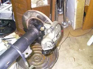

Are you planning on using the splash guards? Also, have you worked out adapting the brake lines yet?
I used the stock '94/'95 V6/GT rear caliper hoses. I used a heavy-duty 360-degree muffler clamp to attach the bracket of the hose to the housing's axle tube:
1. http://img171.imageshack.us/img171/2553/360degreeclampps1.jpg
The photo for this display setup shows the original regular muffler clamp I used to mount the brake hose, before I switched to the 360-degree type clamp in the link above.
2. http://www.ultrastang.com/images/2006/cobraantimoanbracket0117at_.jpg

Ha ha! Actually, the 360-degree clamps were less than $2.00 ea., so I don't guess that makes me too high of a roller.:D --They just look a lot better than the regular style muffler clamps I started with.
I see you left the "tail" on your brake hose brackets. I cut them off on the hoses I was "experimenting" with, during the time I was trying to figure all the modifications out. http://img91.imageshack.us/img91/1922/cobrabrakehosemodtailgt3.jpg

I like how those brackets are set up for the soft lines to the calipers, but I'm still stuck on one part: How do you connect the soft line from the axle to the hard line on the chassis? Aren't the late model lines a different thread pitch?
The threads on the '94/'95 SN-95 caliper hoses are for 7/16"-24 inverted flare fittings --not bubble flare.
The junction block, where the hard line from the chassis ties into the block that splits off to the calipers, is also 7/16"-24. (or, at least it is on my '68 with the '80 Monarch 9-inch rear end I have). :)
