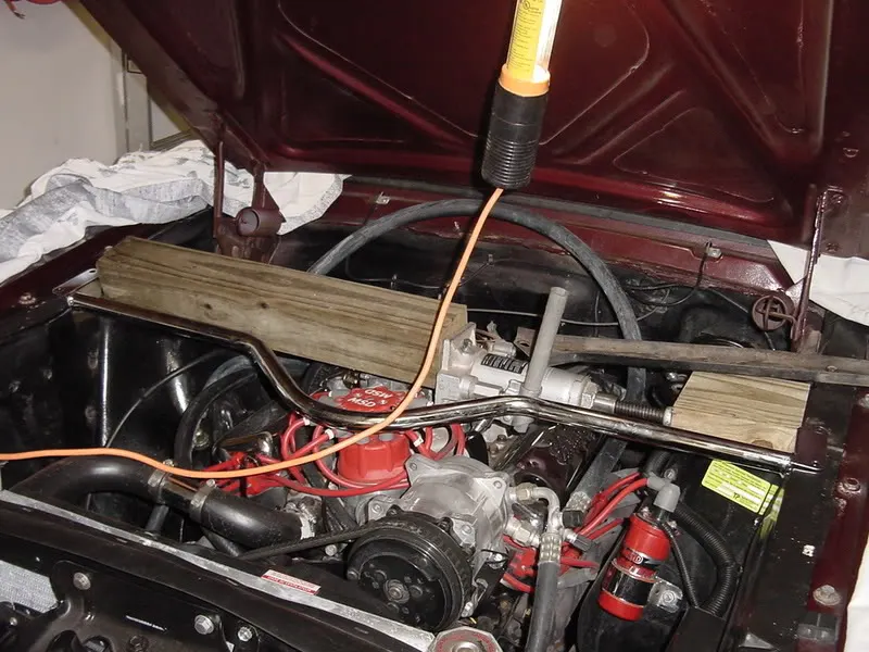

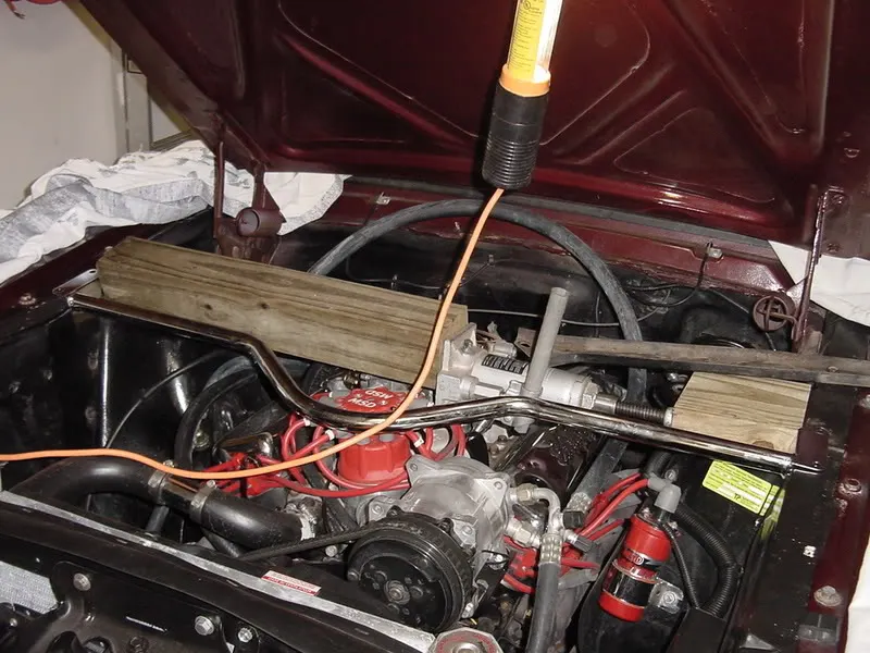

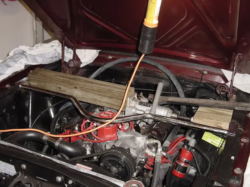

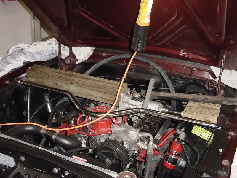

I spread mine about 1/2 to 3/4 of an inch with this arangement:
I tried that as well, but your picture describes it better then words.
I used this method also, plus had to force the RH shock tower a little farther from the firewall. The neat thing is that after driving the car for a year, I had to R&R the export brace to freshen the motor. When I went to reinstall the brace, it required no additional work. It fit fine, even when the motor was installed. The car must have been re-tweaked to the correct shape after the year of driving.:nice:
