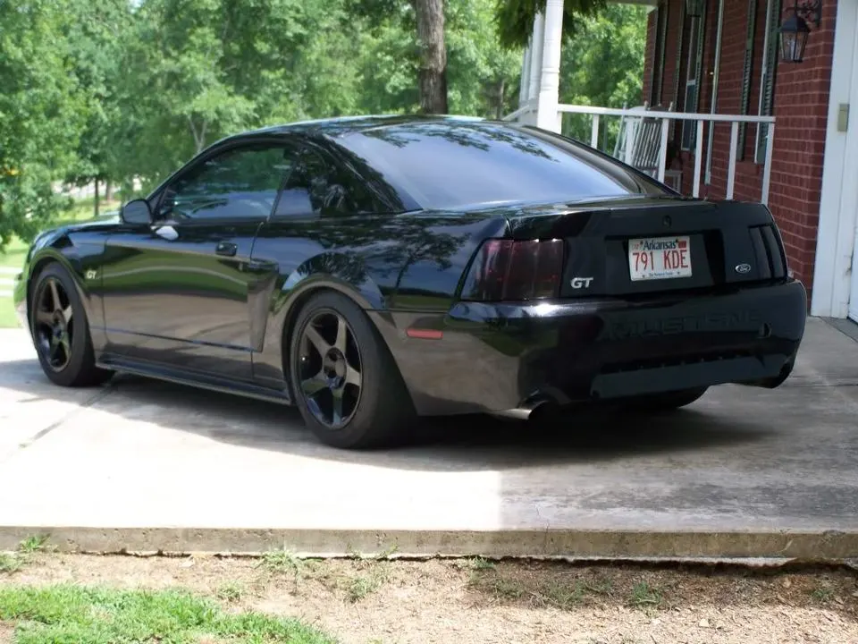

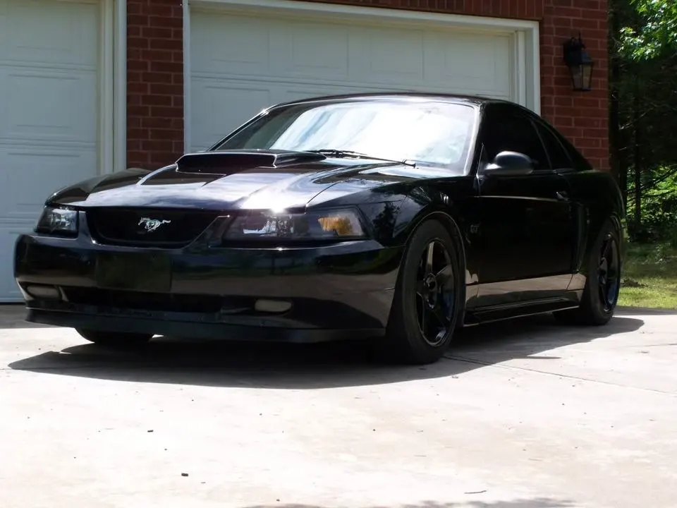

Got bored this past Saturday so decided to go ahead and install my Chin spoiler and Tinted tail lights. Let me know what you think.
Haha thanks man. I really appreciate it. I really need to get that bumper fixed. I am supposed to go pick up some Bullitt side scoops this week along with an HID kit. I think the bullitt side scoops will go with the look im after. A sleek, sinister apperance is what im after. It's starting to come together. Now all thats left for me to find are some 03/04 cobra side skirts and 03/04 cobra mirrors. After I get that done, 3" cowl hood and she will be finished on the exterior.
It's a pretty custom stance...and by custom I mean hacked up stock springs :D I cut them 1.5 coils in the front, and 2 coils in the back, no isolators, no quad shocks, and fox body shocks. The shocks for an sn95 will bottom out a lot with if you lower it as low as mine. A fox body shock is actually a little bit shorter of a shock, so it wont bottom out. Once I replaced the rear shocks, it rides almost like it did before I lowered it.
Thanks for the compliments by the way!

all i need is the black wheels.. tinted the tails over the weekend.. wrote up the how to n all... gotta check for the pics tonight... and I have 5% all around the windows. gotta peel the gt decals on the side tho... and i love our ass ends with tinted tails... especially the cobra spoiler...mmmmmm
Wow, thanks for all the nice words.
It actually sit's level, it's just that the car is parked on a pretty good decline and it's making the car lean to that side. If i can find a good spot that is level I will snap a few more photo's.
Once again, thanks for all the complimants on the car. :nice:
