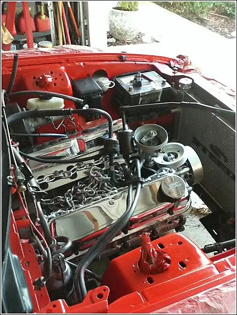

More Progress Pics
Pics from my phone.

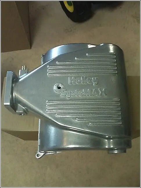

Just got my Holley intake, MSD6AL and Auto Meter Ultra Lite oil pressure guage. My exhaust is the issue. 1 3/4 ceramic coated long tubes for our cars is not easy to get.

Ok, so I layed the Holley intake on the motor today because I've heard that it would need a spacer. To my suprise I have a tad bit of clearance. I don't have the PCV nipple on it though.

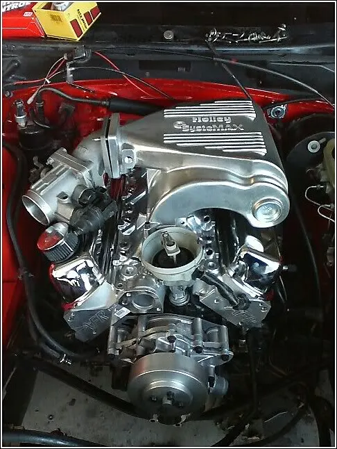

Let us know how the holley lines up with the afr's.
I think the holley was the better choice but on your particular combo since you had said the camshaft was more on the mild side, the ported rpm would probably do better to 3000 rpm but the holley should beat it where it counts, after 3000 rpm. If the camshaft was more aggressive and designed around the holley, the holley would be better over all IMO.
Everyone has an opinion but the proof's in the puddin Mike, and unfortunately we are not gonna make puddin this time.
Actually the Holley mates up to the AFR's a ton better then the Eddy lower. The intake ports don't even compare. The Holley is a better choice after working with both of them.
I layed everything on the motor to see if I would need a spacer and it doesn't look like I'll need it.
