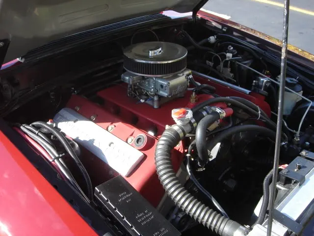

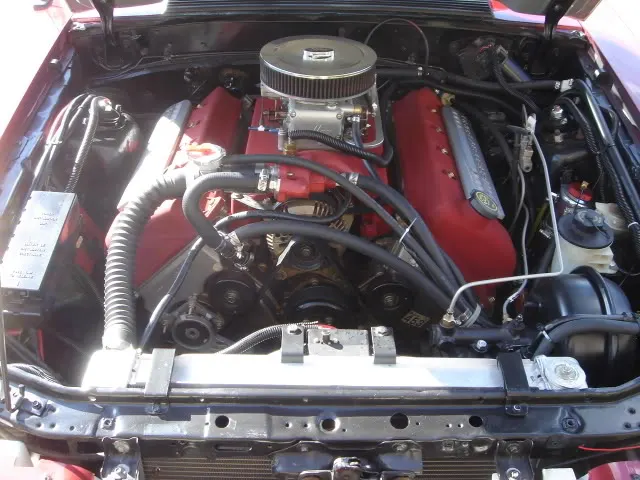

Remember this??? SVT where you at dawg? :p
Yup...that's my buddies dad's car. 32V 5.4L Navi motor. Hand made intake.
