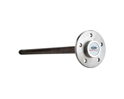

Here's some really nice Ford Racing ones for $245. A lot of times you can find people who are selling Ford Racing parts for less than MSRP so you may not actually have to pay $245... That price of $185 for the install sounds like a great deal.
http://www.fordracingparts.com/parts/part_details.asp?PartKeyField=5548
