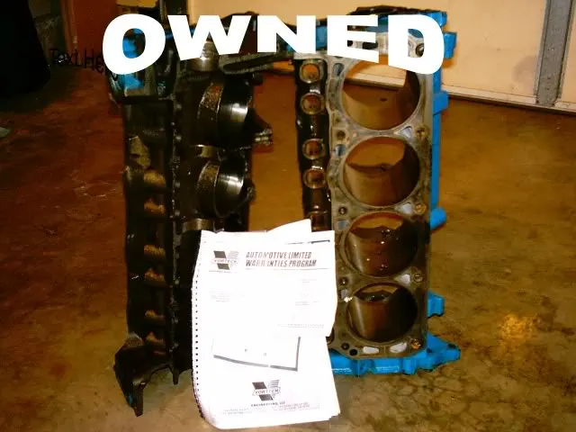

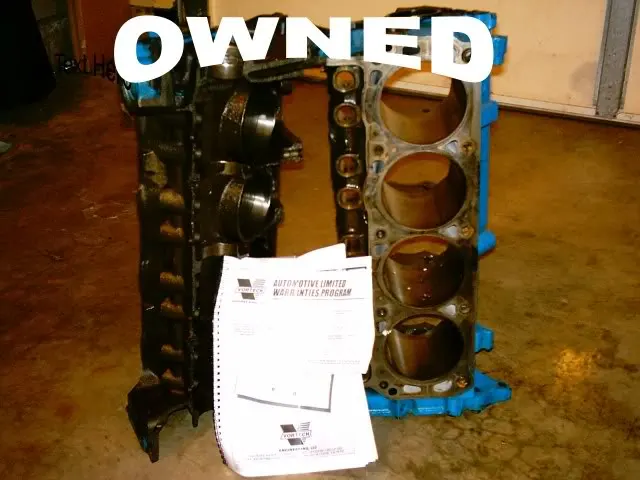

88_GT_5_oh said:
boost till she blows :shrug:
:stupid:
im sick of posting that pic
