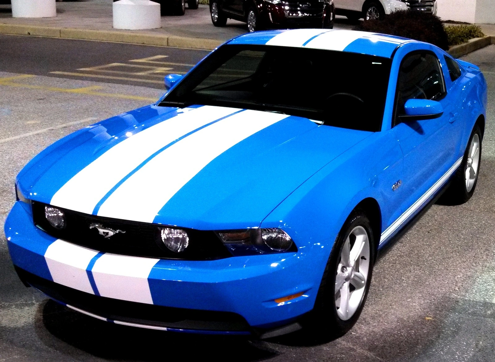

haven't been around here in a while so the pic is of the last car. just bought a '12 GT 5.0L too. 1st of all, congrats!
