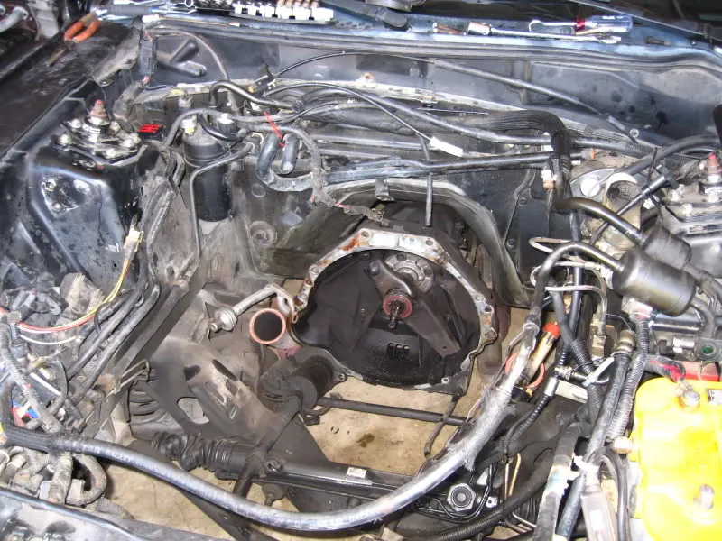

Take your upper manifold off and you can get to the top bolts from the engine bay, it's very easy, i did it on my 94 and it's WAY tigher o work on than a FOX
