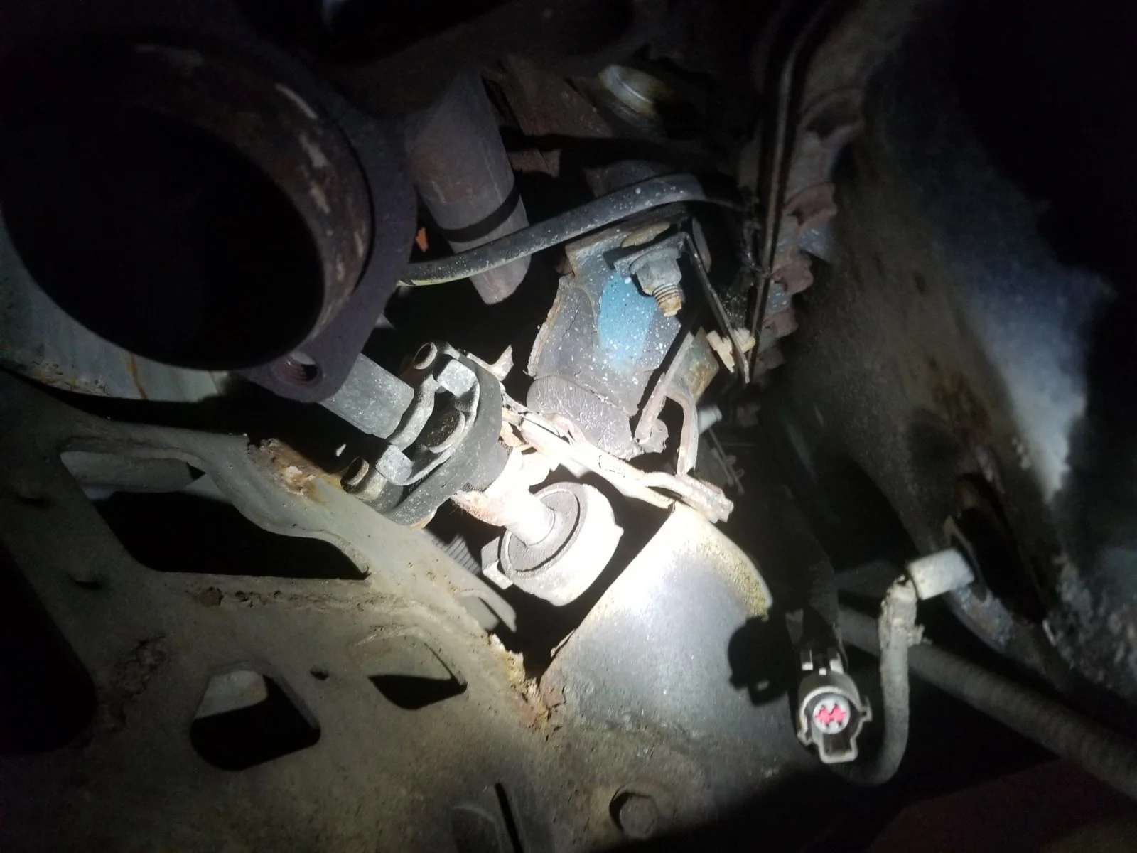

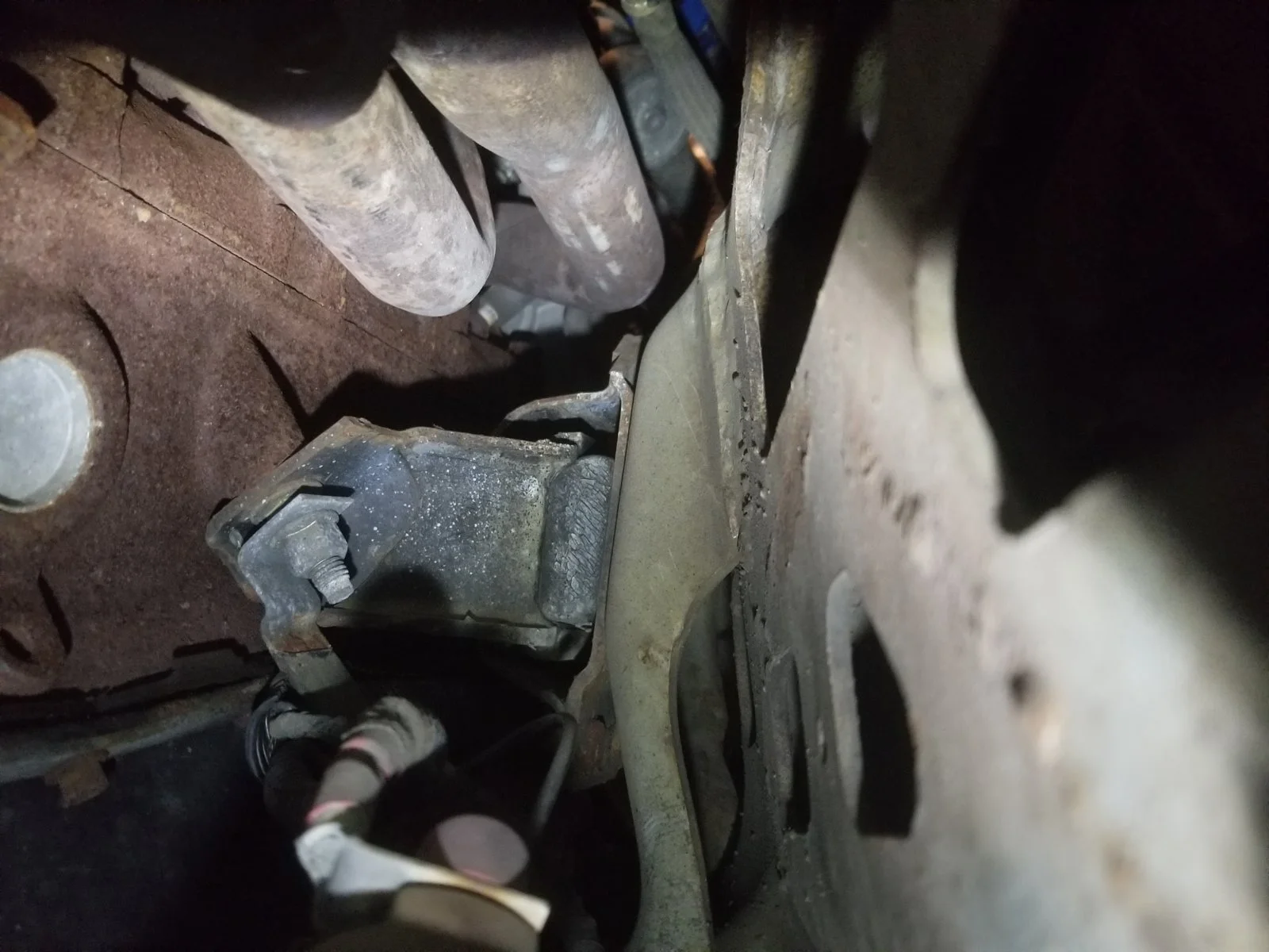

So I have the transmission and all the clutch components and flywheel out of the car so I can replace them. I noticed the motor mounts are much more accessible now. Is it safe to change them without the transmission supporting the engine or will it be too unstable?

Having the transmission out is not a big issue. However, having the transmission out does not make much difference on changing the motor mounts. Put a block of wood under the oil pan to spread the load of the jack. Should be fine. Do one engine mount at a time, and you should be fine. The engine usually settles back to where it came from. You can always jiggle it back into place.

My bad, was thinking of how I did it. I would consider doing it with trans in. Wont the motor wobble a little by itself?.With the drivshaft on it goes strait up. If it moves two inches to one side how easy can you get it back?
Should be fine as long as one side of the motor is still attached. What kind of mounts are you putting back on it? I hear a lot of negative stuff about the current rubber mounts on the market. I replaced mine with Energy Suspension poly mounts.
I'm going to use MM urethane transmission and motor mounts. I can almost pull the transmission mount apart with my hands so I figured I should replace the motor mounts too. Also grabbing the MM firewall adjuster too for the clutch cable. Might order new parking brake cables too now that they are accessible...
