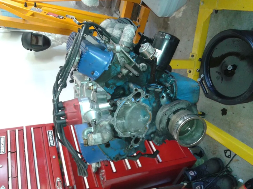

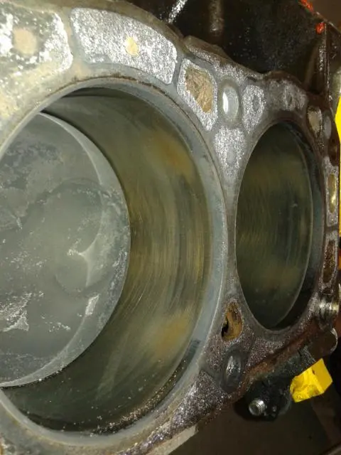

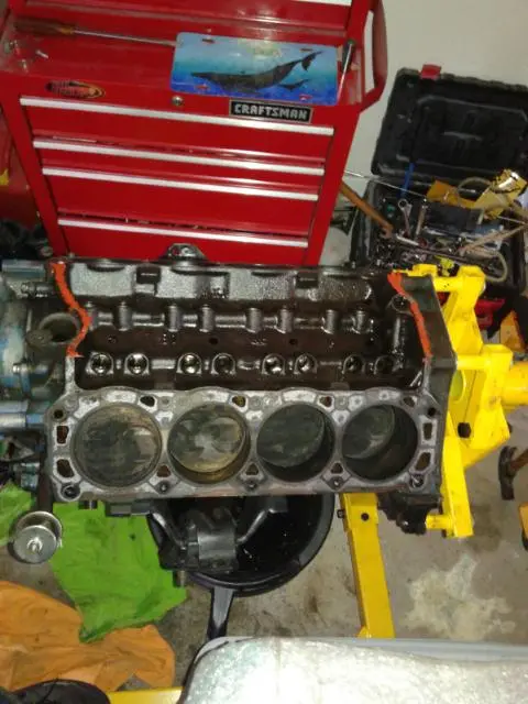

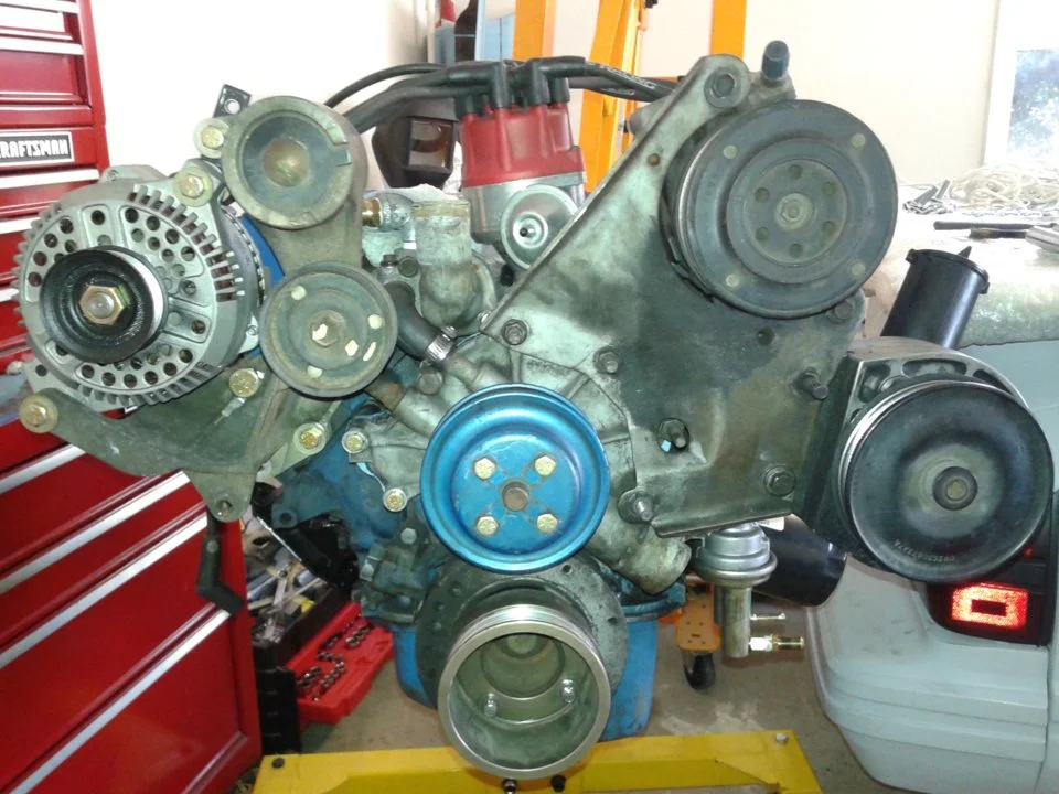

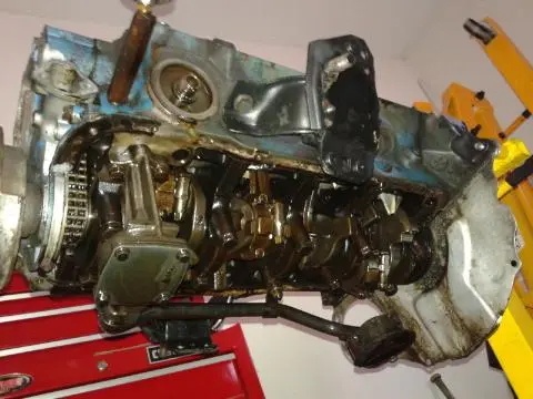

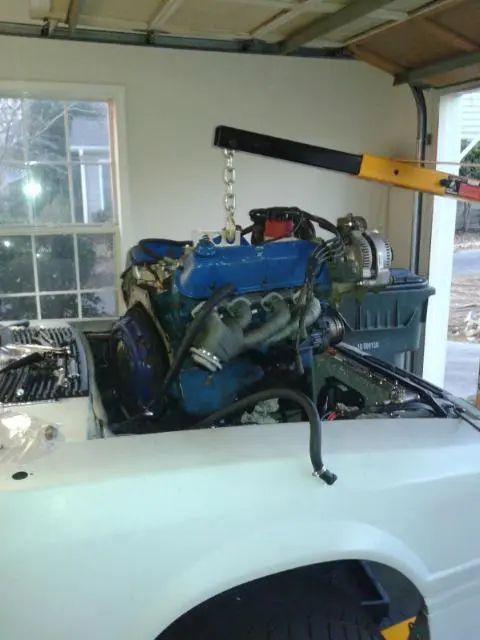

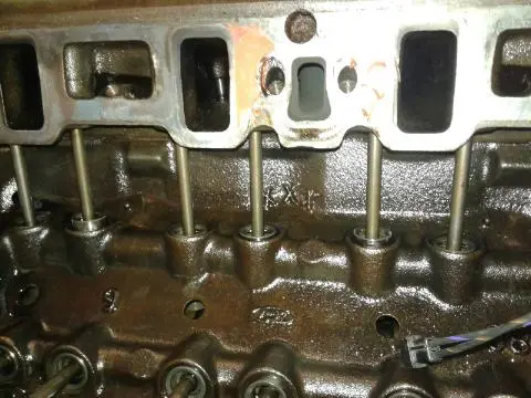

I pulled my motor out this last weekend. Tore it down. This is a 1980 302 block out of a Full Sized Ford. It has cross hatching that looks good! I was glad, but to my surprise the pistons have two valve reliefs. What's up with that? Not sure if it matters but the reason I pulled the motor was due to low compression in one cylinder. Squirt a little oil in the cylinder and the compression jumped back up. Bad Rings. Anything look different on this motor than what would come standard?

On the picture the cross hatching doesn´t really looking like a cross hatching????
What's it look like?
thats an 80 block? why would that be in there? thats not a roller block. what heads were you running?
Yepper. E0 block. PO installed it. Nope not a roller, as for the heads I'm not sure. I assumed E5's.
