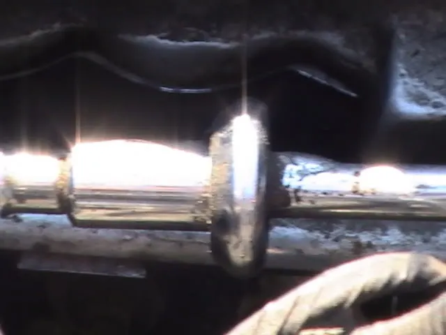

from what i can tell those ^^^ are the fittings. there are two of them right under the car right next to the block.

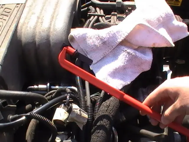

this ^^ is the tool i bought. it also comes with a 3/8ths "wrench" as well that is blue.
are these the right tools and right fittings? or am i retarded? i'm really pissed because i've been running around trying to figure this **** out for about an hour and a half now.
mello out and smoke a bowl! the fuel lines are a mother to get off even with the tool. it's hard to see in the pic if thats the right tool or not? IF you really dont need them then just cut the f'ers with a pair of bolt cutters then you can work on them easier out of the car to disconnect them? Did you tell them you need a ford fuel line remover tool? I have been able to remove them with a really small regular screw driver. Theres a spring around the radious inside the connectors i was able to get the screw driver inside and under the spring pulling as i worked the screw driver around it.peace

Max, I don't think you have the right tool. I've never seen one like that. The ones I've seen are round like this. View attachment 316607
these are the ones.
