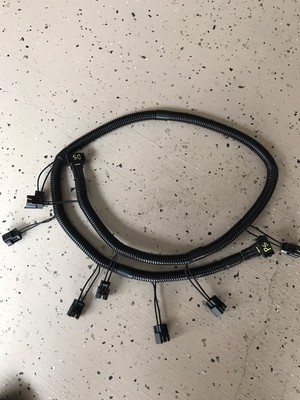

Should you be interested in keeping the COP ignition instead of swapping to a coil-pack ignition then a conversion harness such as this will be needed:
Coil On Plug Conversion Harness. Plug And Play 96-98 Ford Mustang GT 4.6 SOHC V8
This harness makes an easy adaptation from the original coil-pack motor harness to COP style ignition. The harness works by wiring the COP cylinder pairs back to back in a waste spark arrangement.

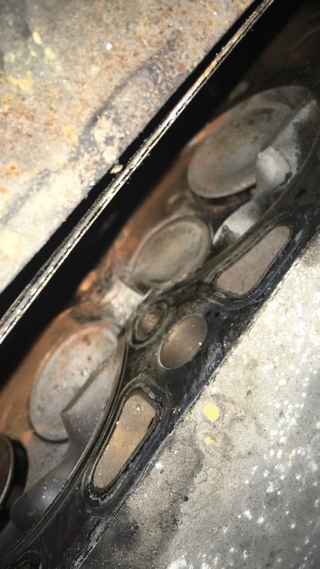

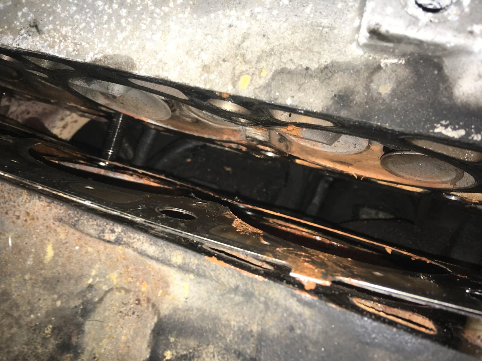

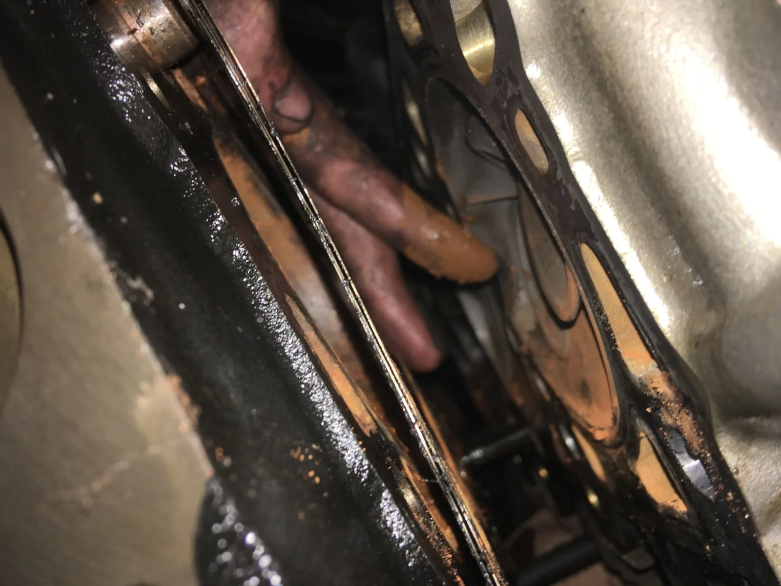

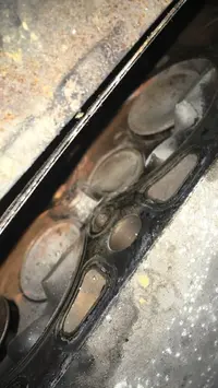

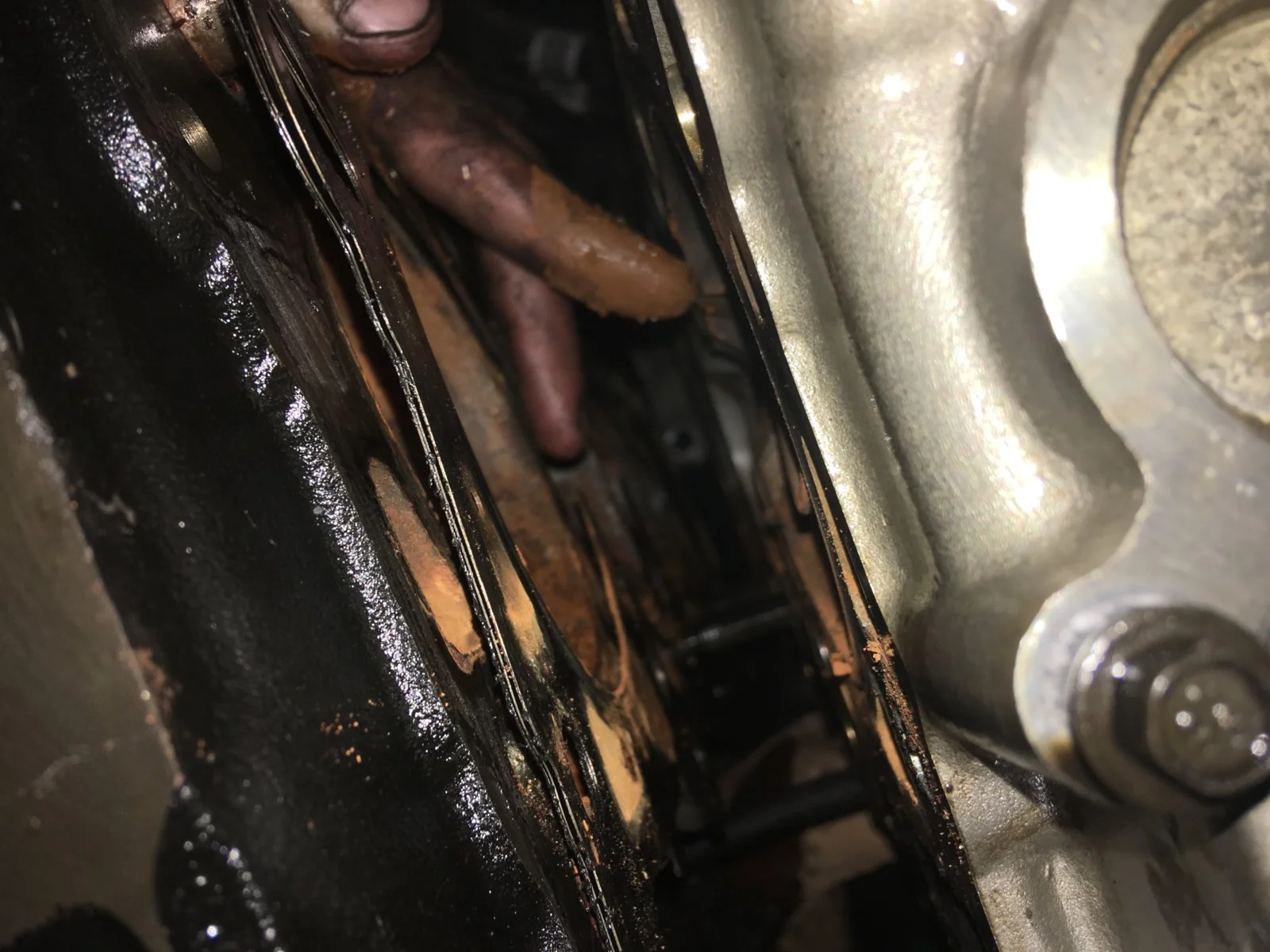

So I took a new route and just wanted to replace the head gaskets but the driver side head is **** and has a hole between the cylinders heads the block looks fine but everyone is telling me new block but I’m not sure the block looks perfect but I’m looking for a better answer it’s hard to tell but the front two piston heads have a hole in them I just want to put new heads on and call it good but I’m not sure please tell me what you think

That's not a hole, that's a damn archway... :eek:
Why are people suggesting you replace the block? Coolant in the bottom end, if allowed to sit, could be bad news, but that does't look like a break over a coolant port.
