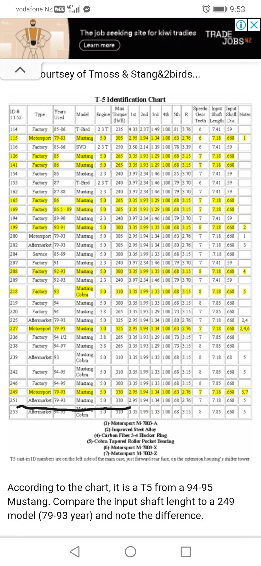

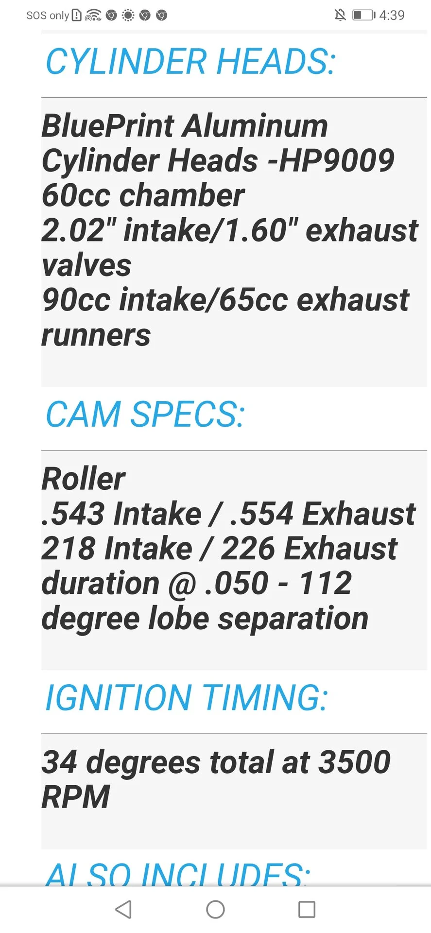

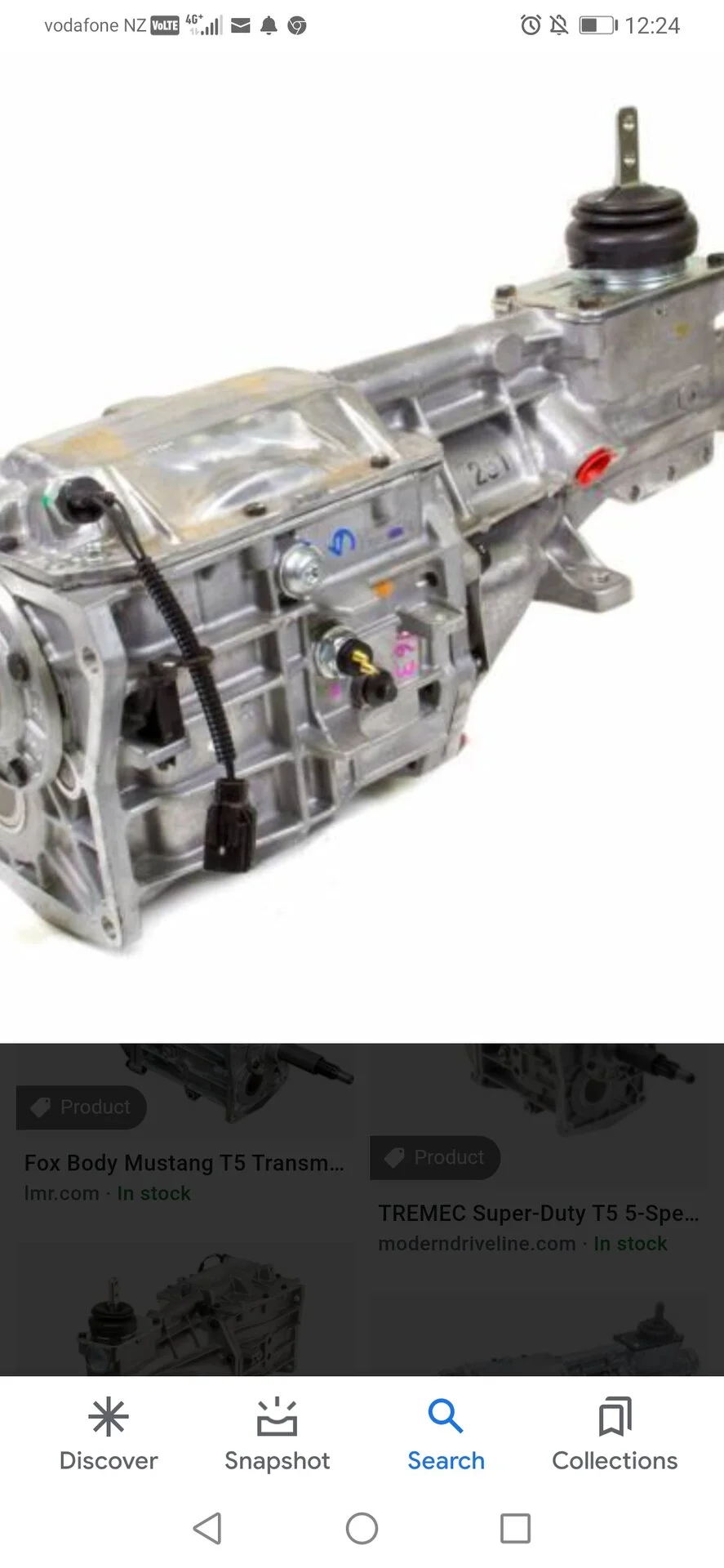

Couple photos added of specs on my crate engine imported from blueprint engines & T5-Z chart

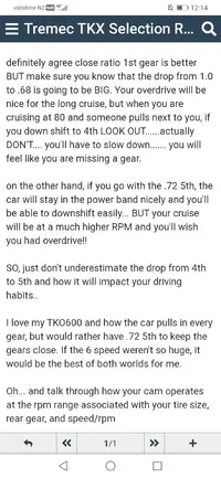

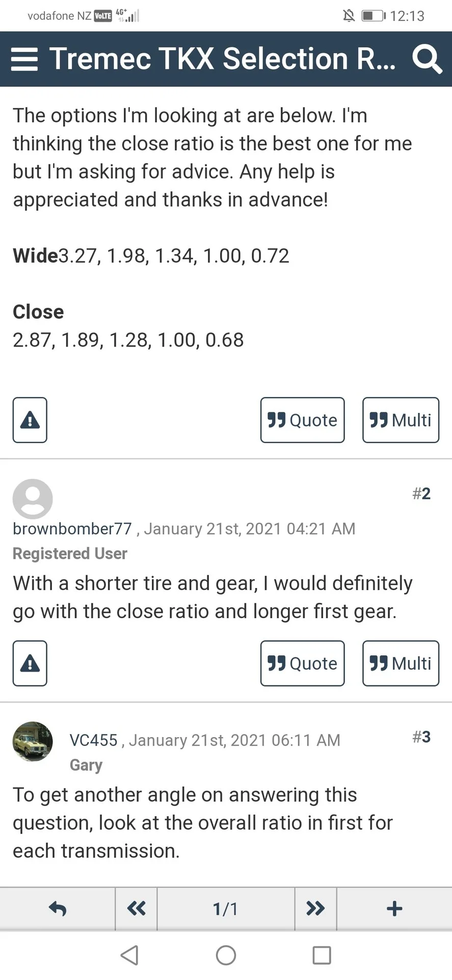

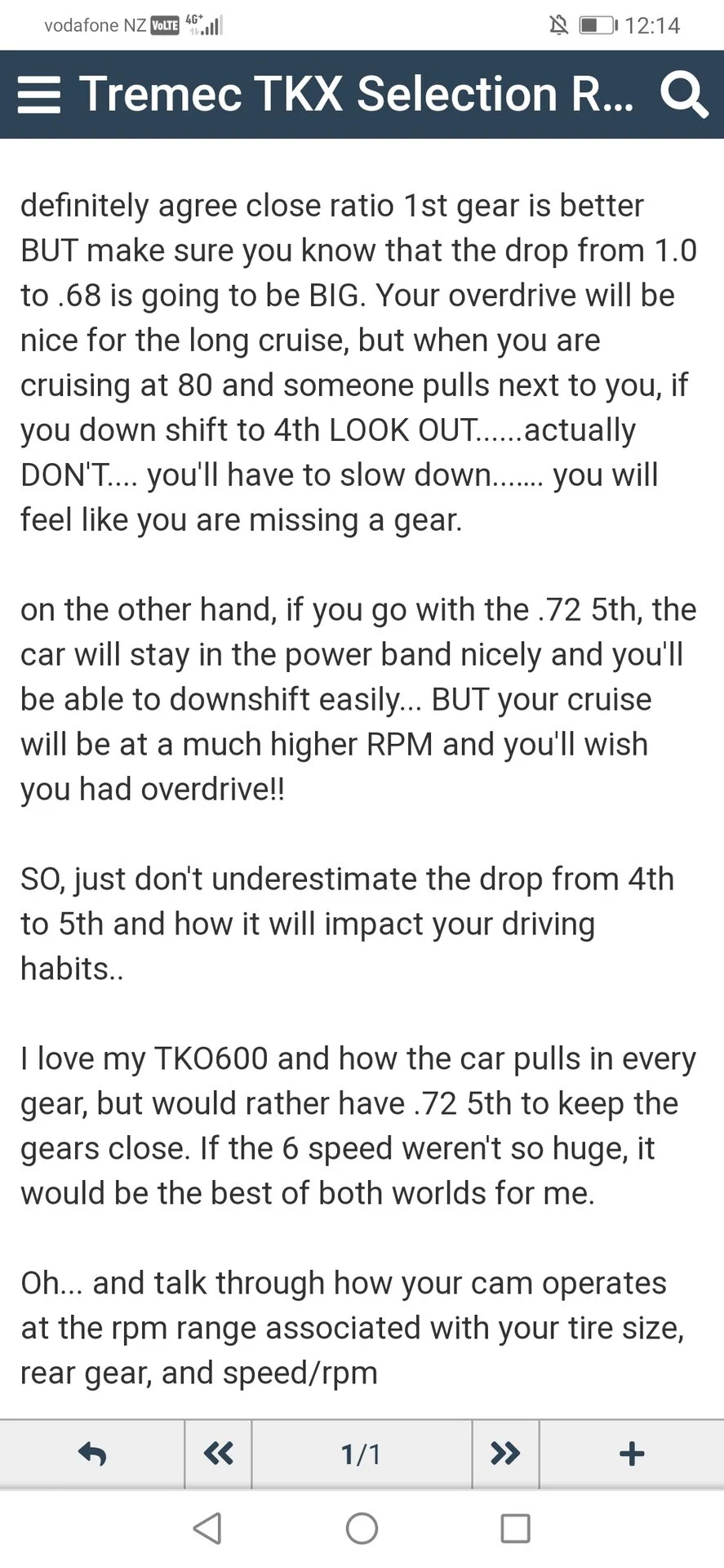

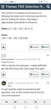

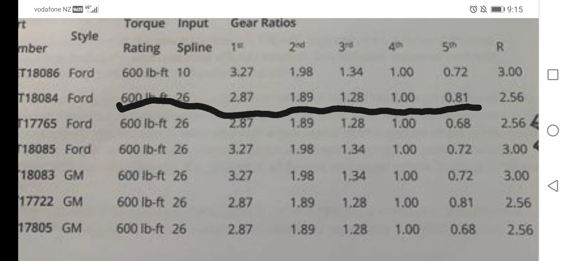

Have added couple more pics regarding wide ratio vs close ratio & thought the wide ratio might have suited me better as would be doing a lot of highway cruising & the over drive. 68 wouldn't be suitable changing down to 4th (1.0) at 80mph.
But the author went onto say. 72 would be OK.
The TKX that will land in New Zealand end of October will have . 81 over drive, photo attached..

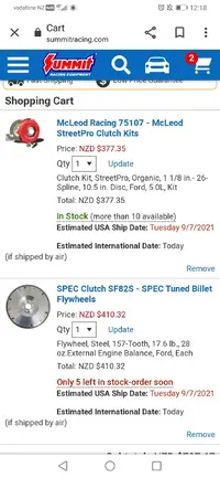

It was a combo purchase but I've decided I'm going to buy my own flywheel & clutch kit etc
I've got about 475 hp/450 ft lb.

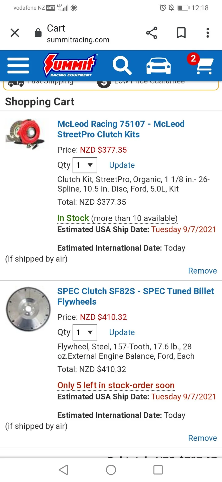

I'm looking at 10.5" 26 spline street pro Mcleod clutch kit #75107, rated at 400hp, surely this is going to handle the jandal as long as I don't thrash it.
There is Super pro Mcleod rated 475hp but the taxes & shipping from USA to New Zealand is a bit of a killer to be honest.
I've also be looking at Spec - SF82S flywheel 28oz 157T, surely I can't go wrong there as bolting onto 351w, another option was Ford performance FMS - 6375 A302B but doesn't come with dowel pins etc

While it surely may feel like i'm just spending your money at this point (good choice going with the better trans). It's not really wise to buy a 400hp clutch to be installed on an engine that you just said makes 475hp.
You have gone this far, i'd just skip to the RST.
Trust me, you do not want to do this twice, i've driven through a clutch, it's a sinking feeling.
The flywheel i worry less about. As long as it's the right size, balanced right and you break in the clutch properly, most would do.
Thanks for your input, I've got too much time on my hands at moment with lockdowns etc.
I ended up buying Mcleod super street pro rated at 500hp, the RST way to expensive & then the taxes & shipping to NZ is pretty extreme.
