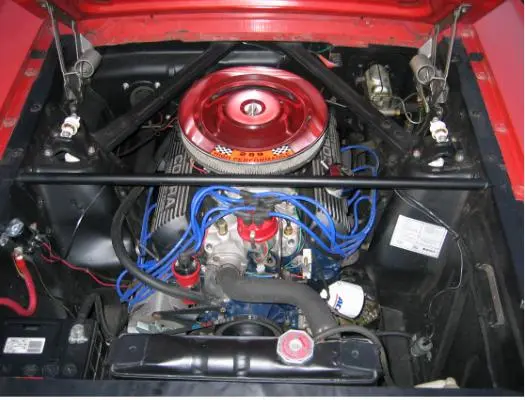

Why not swap the upper instead? Then all you need is a new hose.
Check out mine, nice and easy and works great.
