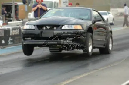

Here's my car launching last weekend with the 2.2 KB.
Would she not also pull the front end off the ground with the Paxton too?
Not like the KB. My best 60 foot with the Novi was 1.442. With the KB, it is 1.358.
