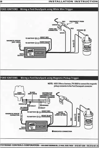

MSD 6AL Wiring Question
89bluegt
Jun 21, 2003
95
SC
Do I use the diagram on top or bottom for my stang? Thanks
Mine has a blaster 2 coil, like the one in the diagram I posted. I'd rather just wire it up instead of buying the harness because I'm gonna mount it under the passenger seat.
Doesn't matter what coil it is, you still have a TFI ignition. It's easy to hook up without the harness, only advantage is the harness makes it look a little cleaner.
