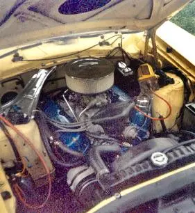

You can use the 75 "Solid State", or 76 Duraspark 1 distributors too.
They are same as the Duraspark 2!
The boxes are different is all. You don't need to run a box with the MSD6 though.
They are all magnetic pickup. The MSD distributors are actually based on the DS design. Magnets don't go bad, so they are perfect in this application.
The bigger cap used on later DS2s fits any distributor.
It just comes in 2 pieces. A bottom part that clips to the dist and a top that attaches to the base. It is a very good setup. Uses better wires and you can even go to the junkyard and get a fancy rubber boot to cover it all up.
The big cap will even fit your points distributor if you just want to upgrade to the better HEI style parts.
Good setup you are putting together.
Dave
Edit: I attached a pic of the big cap and boot adapted to an older stock distributor... Sorry for the grainy pic. It was an old pic I scanned in.
It is good enough to see the dizzy though.
