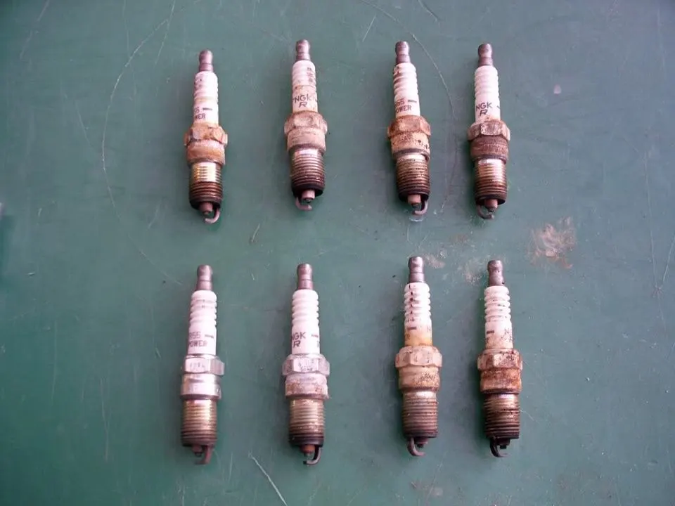

Here's my spark plugs starting with 1 on the top left, 8 on the bottom right. They don't look terribly happy for being a few months old.
