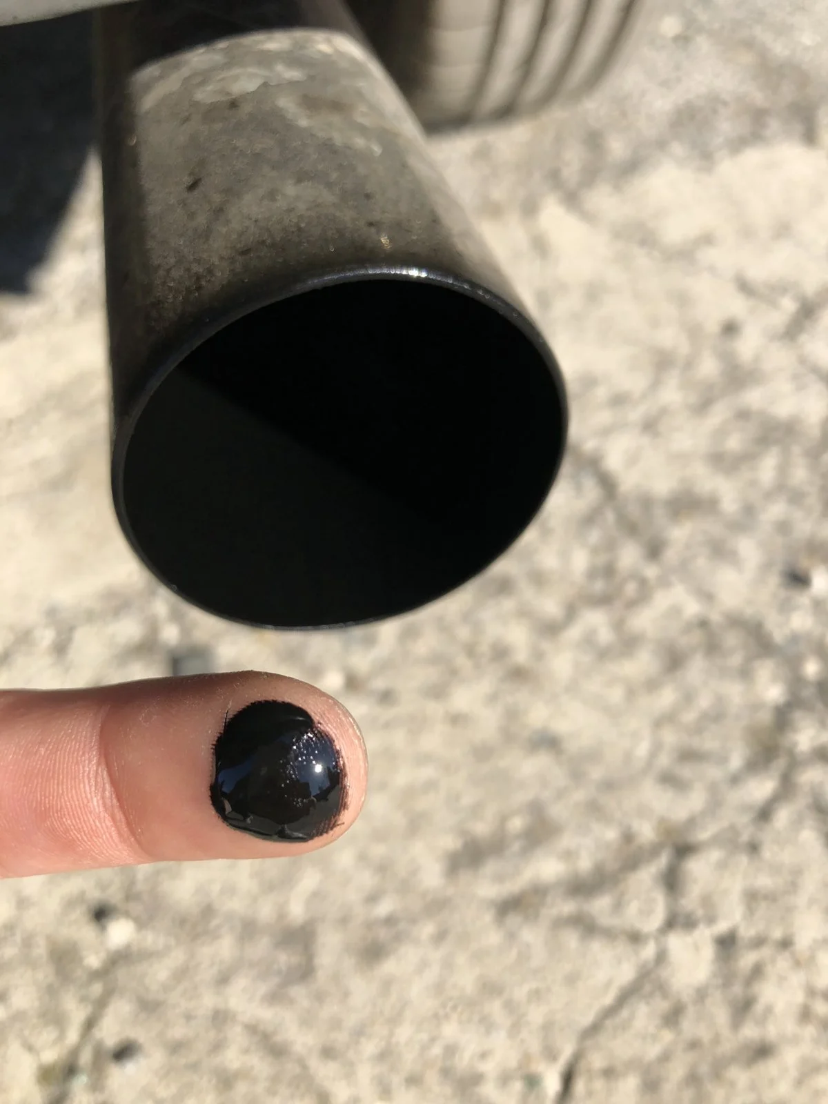

My problem is blue smoke from exhaust.

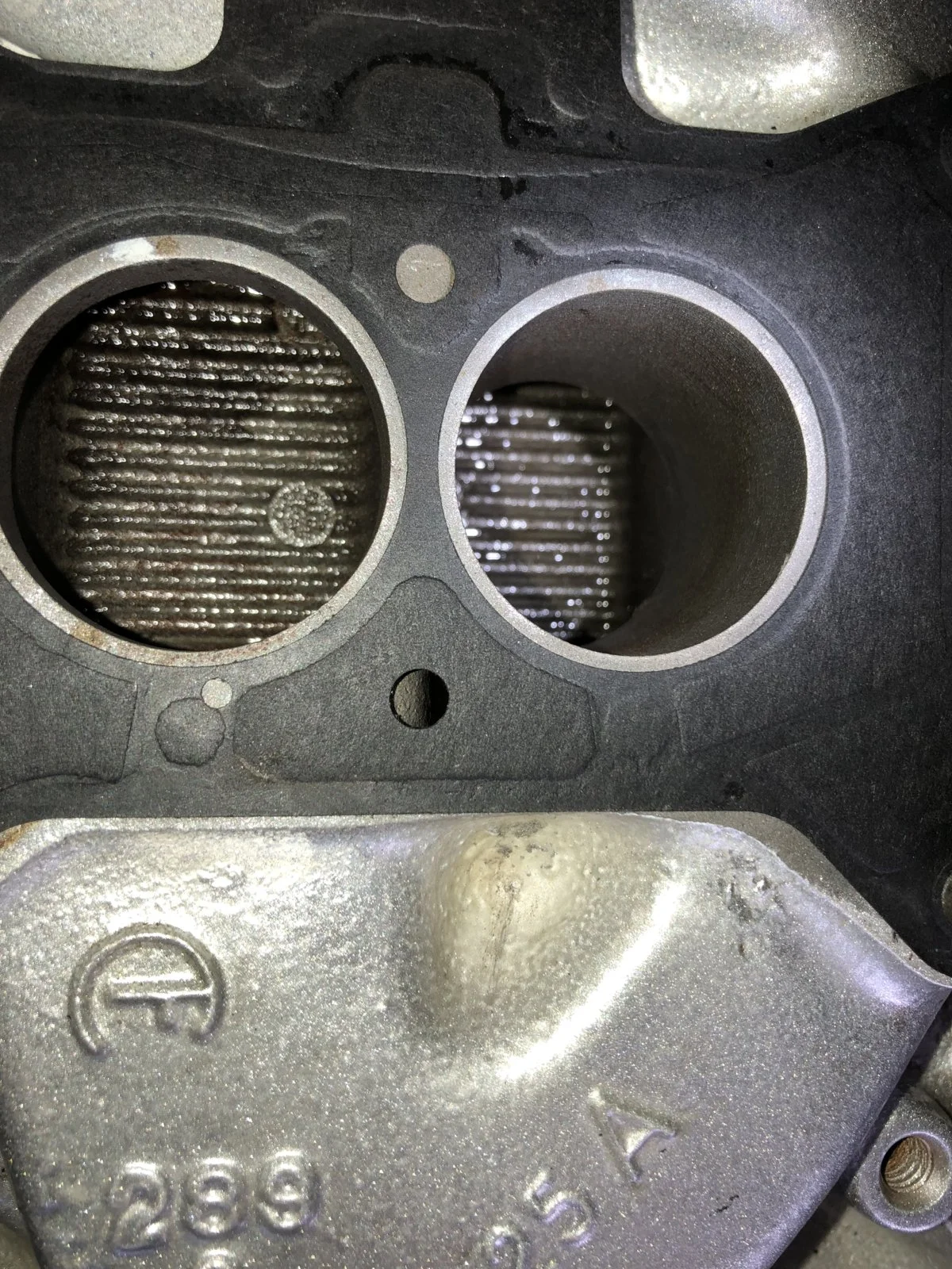

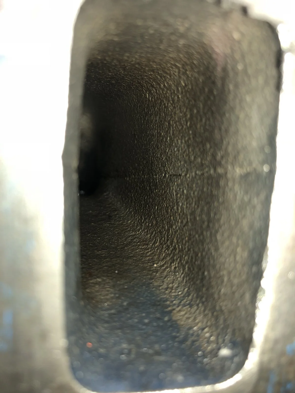

I have taken off intake manifold found lots of oil in intake ports.

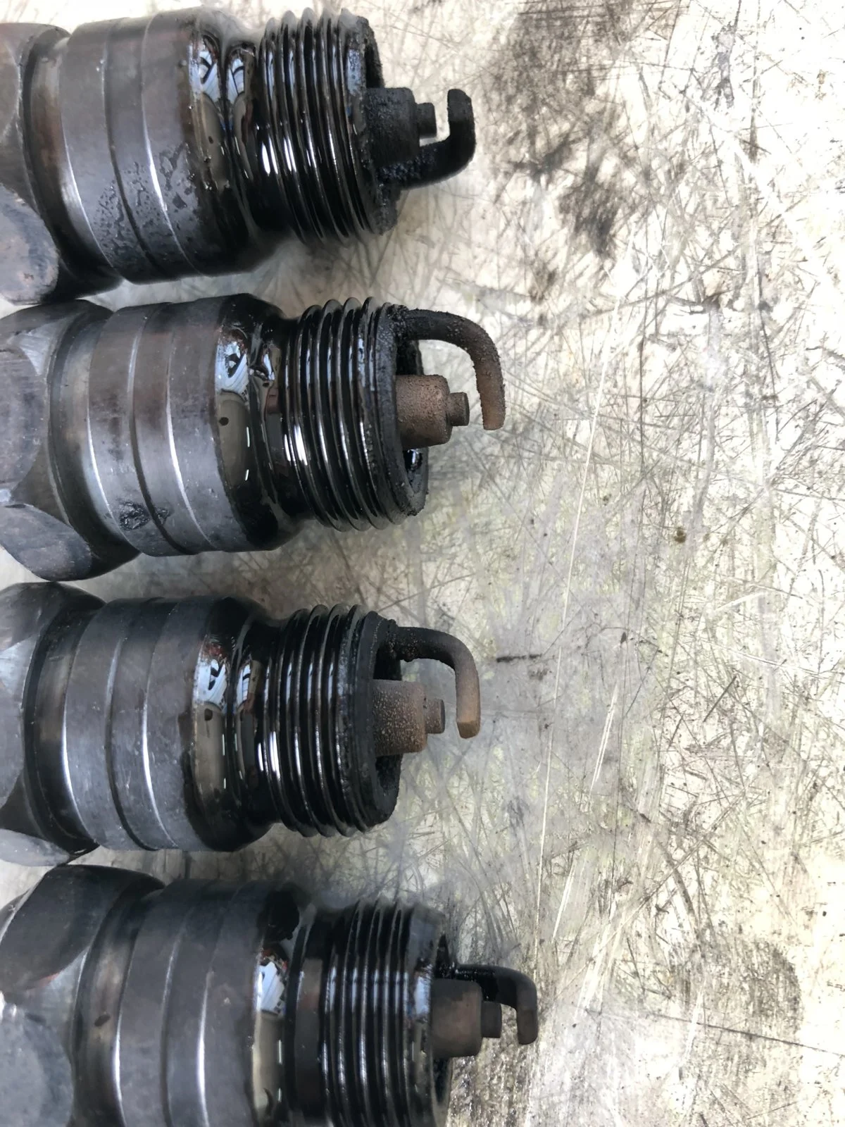

spark plugs are wet with oil.

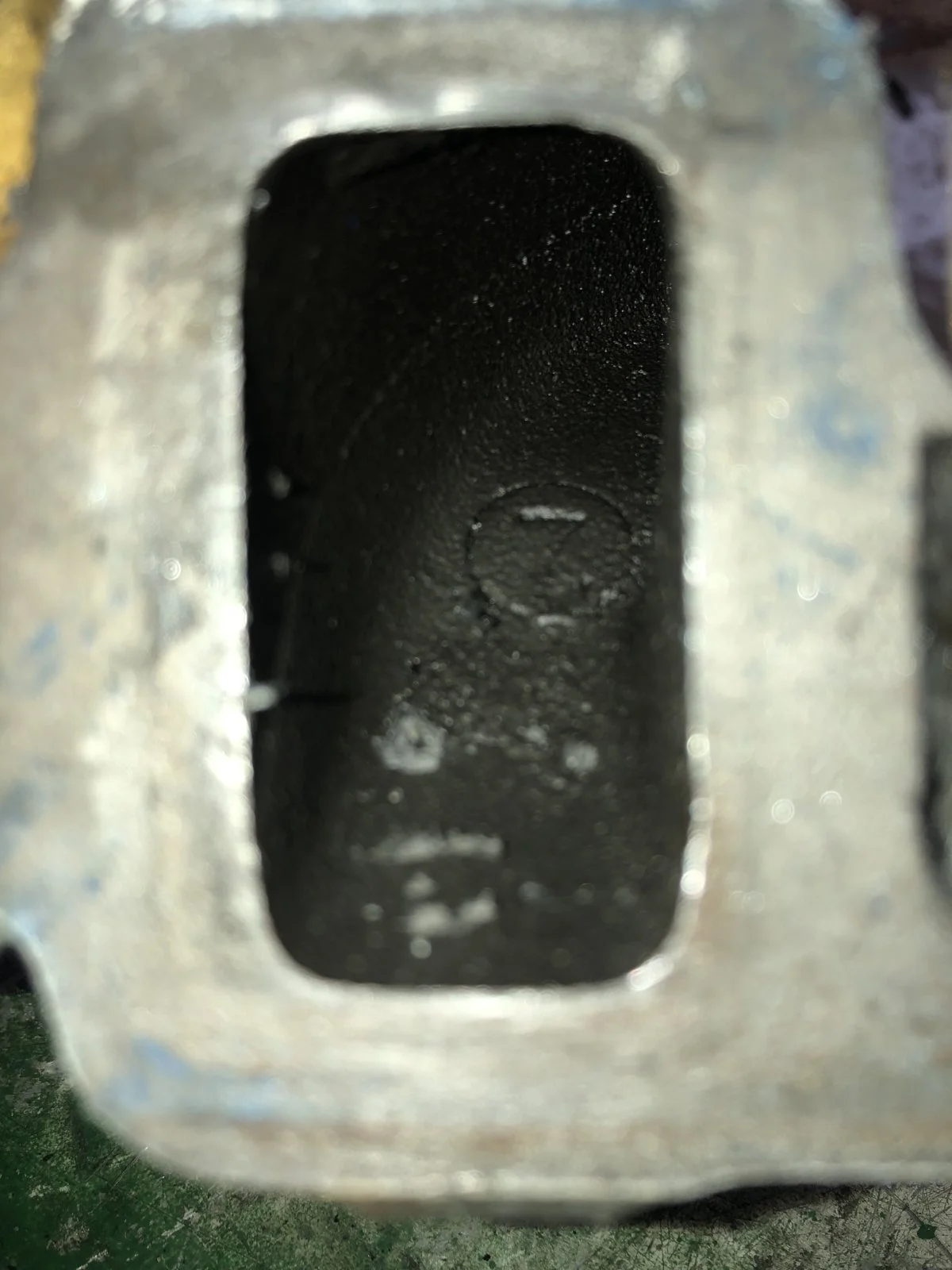

here are some pictures of intake ports and spark plugs

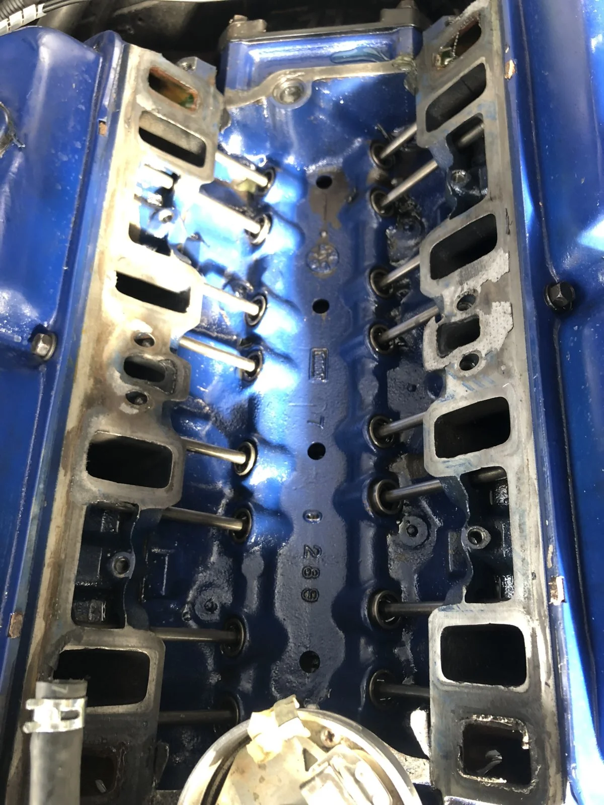

I installed diffident intake manifold today, tried fast test drive.
No smoke on startup but after 2-3 mins it started smoking from exhaust and some smoke from pcv hole and from oil cap (runing with no pcv atm to eliminate it as a problem)
Is it possible I am burning buildup oil from exhaust?
Is it possible that my original intake manifold is bad and not sealing? If so why no false air?
and if the rings are not sealing why is there oil in intake? it can go to exhaust but not in intake as i understand it.
