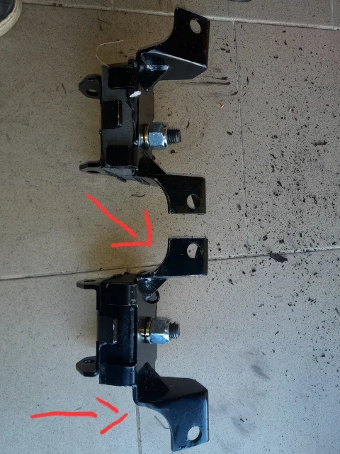

I'm currently converting my Mustang II to a V8 and ordered these engine mounts from Classic Repro.
They're made slightly differently and have different sides.
Can anyone tell me, or provide good pictures, how to install the engine mounts correctly? Unfortunately, there are no signs.

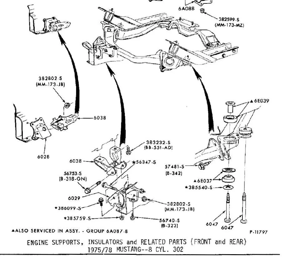

The mount with the slotted hole is for the right side. You will also need the frame brackets for a V8 to be able to attach the motor mounts to the frame, 6028 (RH) and 6029 (LH) in the illustration below.

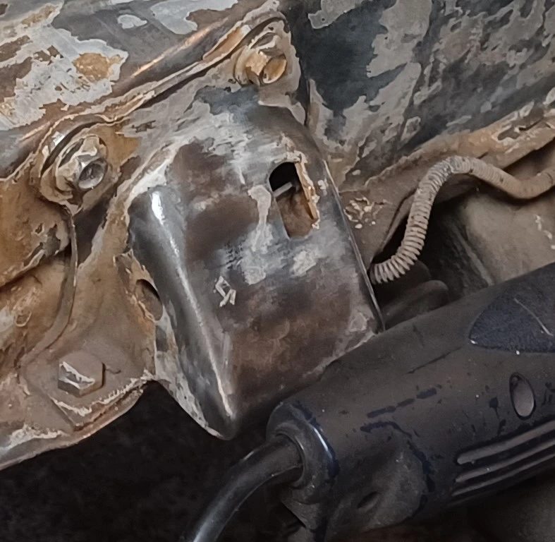

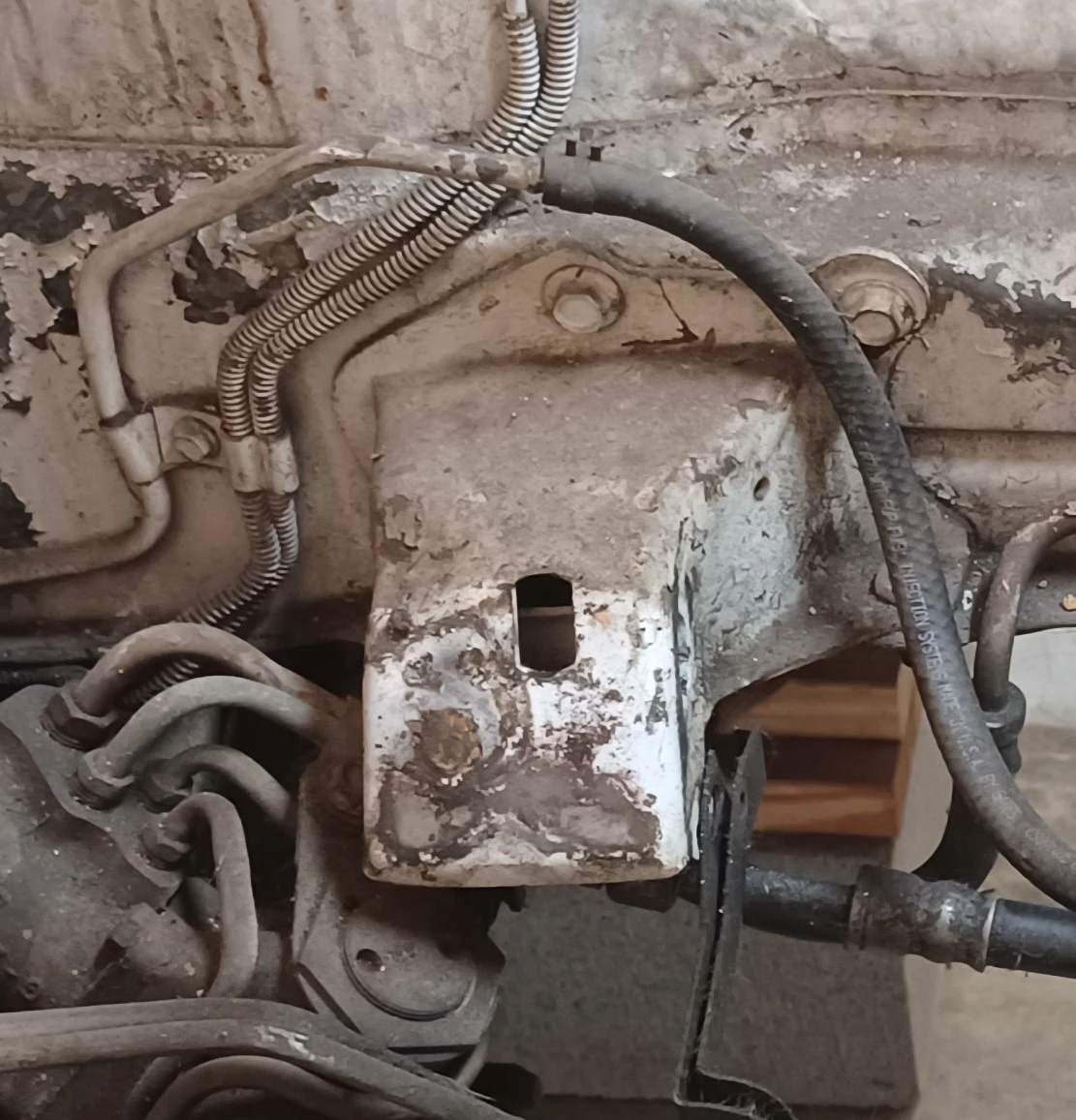

As far as I know, no one reproduces the frame mounts. So your best bet would be EBay or a specialty supplier/salvage source such as Phil Schmidt in Alabama. Unfortunately I don't have any contact info for him, but I'd suspect it wouldn't be too hard to find if you did a search. I believe he's on Facebook as well, so that may be your best bet to get a hold of him if you have a profile. Look in the Mustang II groups, I'm pretty sure he's active there.

Now I have a minor problem. My motor mounts are from Classic Repro and don't have markings like left and right, but there is a longer and shorter side.
How do I install them so that the motor is positioned correctly?
