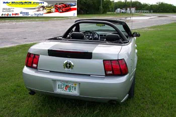

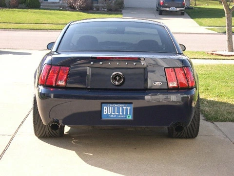

It has been done a couple different ways. The first one I saw was several years ago, but, if I remember right, it was a nightmare. Basically, they took the Cobra rear, and cut out the portion that said COBRA, and cut out the part of his GT bumper that said MUSTANG. After a lot of urethane filler, wire mesh, and backing plates....but he had a cobra bumper that said mustang. The other one, and I have seen this more than once, is to fill in the cobra lettering to just leave it smooth. I think it cracked at one point because someone leaned on it, but, again, it can be done. The last, and most interesting way I have seen it done, was that they cut out the COBRA and put in a license place indention where the Cobra was originally located. It was complete with lighting. For the trunk lid, they filled that area in, and smoothed it over.
I am trying to find pictures of all of them, but it was years ago. Here are some that I have found.....
Here is a link to a google search that shows A LOT that have the cobra smoothed over....some good, some bad!
Here is another with a photoshop of the moved license plate. The one I saw was similar, but the recess in the trunk lid was filled in and contoured.
and another...
