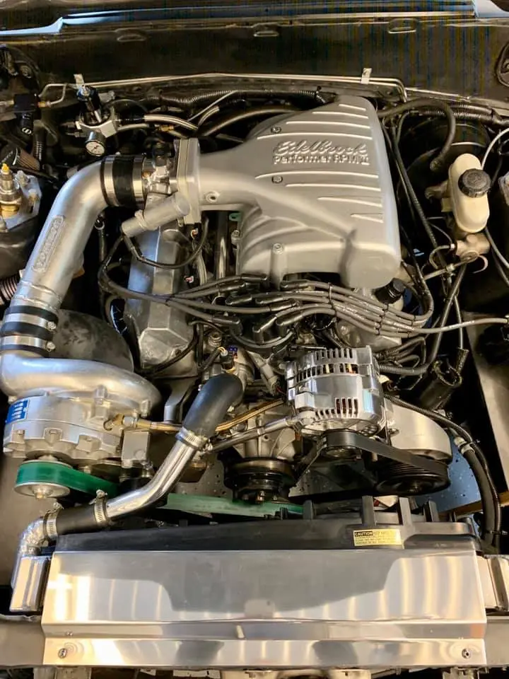

Engine Mustang Drivers Side Alternator mounting
Put the Vortech on the driver's side. That's how ProCharger has done it for 25 years. Battery box goes to passenger side, mounting holes for tray are already there for the 4 cyl cars. You trim about 1/4 inch from one side of the tray. Now plenty of room for an intercooler which all forced induction should have.
