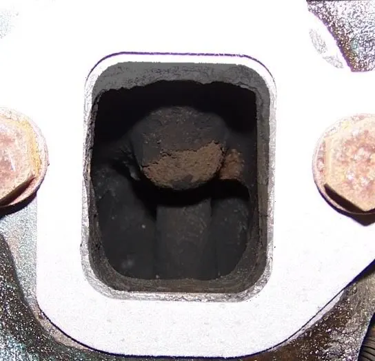

2 1/2 inch pipe is NOT over rated. Ford's traditionally had a problem with their heads on small blocks (I don't know too much about big blocks). The problem was that the exhaust ports didn't flow well enough. If you have a modified set of heads that have good exhaust flow and you run 2 inch pipe, you are choking your motor. I wouldn't run a 351 or larger motor on anything less then 2 1/4 inch if it was stock and certainly not less the 2 1/2 inch if it was modified.
Manufacturers will use the pipe that is cheapest to give them the results they need to sell cars, thats why most of them use crush bent pipe instead of mandril bent and the cheaper 2 1/4 inch tubing.
Without fixing the exhaust port problems, big pipes and fancy cams are a complete waste of money. Lotta people can't afford a couple grand for aftermarket heads, so they have to make the stock ones work for them.
The early 289 heads were pretty clean, although port matching helps. When the smog systems came along, the stuff was added to the exhaust ports, basically could not have been worse for performance if they tried. Bad foundry quality control just made it worse. Here's an example showing both. The blockage around the edge is not buildup, it's cast iron. The big "nose" shape blocking the port is the smog pump outlet. Proper port matching produces dramatic results on these heads:
