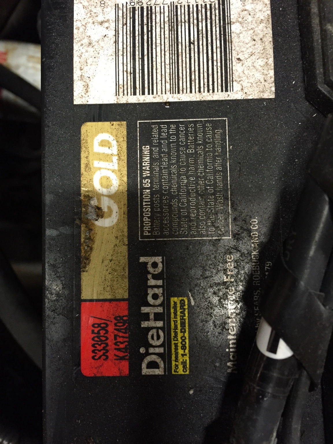

Every time my battery dies, I always replace with a Sears die hard gold. I've had great luck with them and the one in my fox is from 2009 and still kicking.
Never really had a problem finding one though.

I also have a Die Hard on my truck, and it has never given me issues, ever. Although they dont' have one that fits my Mustang. Wish they would.
