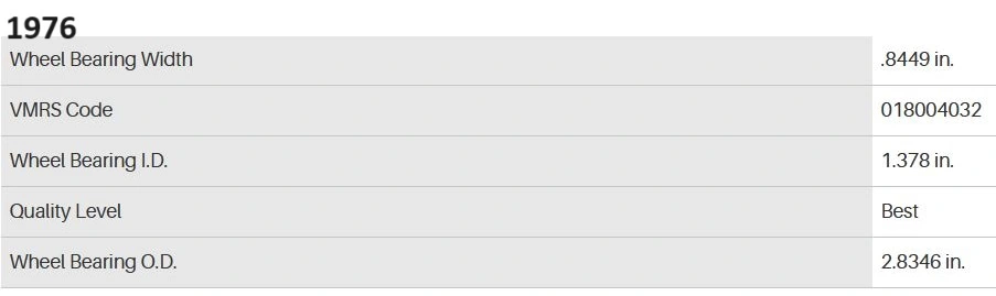

I have done this swap using new Yukon axles and the 65-66 axles will fit, but it is not a straight swap. A spacer is needed between the bearing and shoulder to make the axle flange line up with the face of the brake drums. Otherwise the axle does not stick out far enough on each side. Might be OK with a rear disk brake swap, but I have not tried it. Seems like I had to machine the axle diameter smaller to use the Mustang II axle bearings. Not sure if the 65-66 bearings will fit inside the bearing cups on the MII housing. I'll be swapping the gears out later this week unless we go out of town, so I'll get some photos and dimensions for you.
Edit: The axle bearing dimensions are the same for 66 and 76. This may have been an issue with using the aftermarket Yukon axles. I's only been about 20 years since I did the swap.

Thank you for all the great advice. I really appreciate the spec sheets. You have removed much of the mystery. I am considering re-drilling the stud plates . That will give me a chance to compare the axle bearing diameter, distance from the hub, and length to the 65's.
