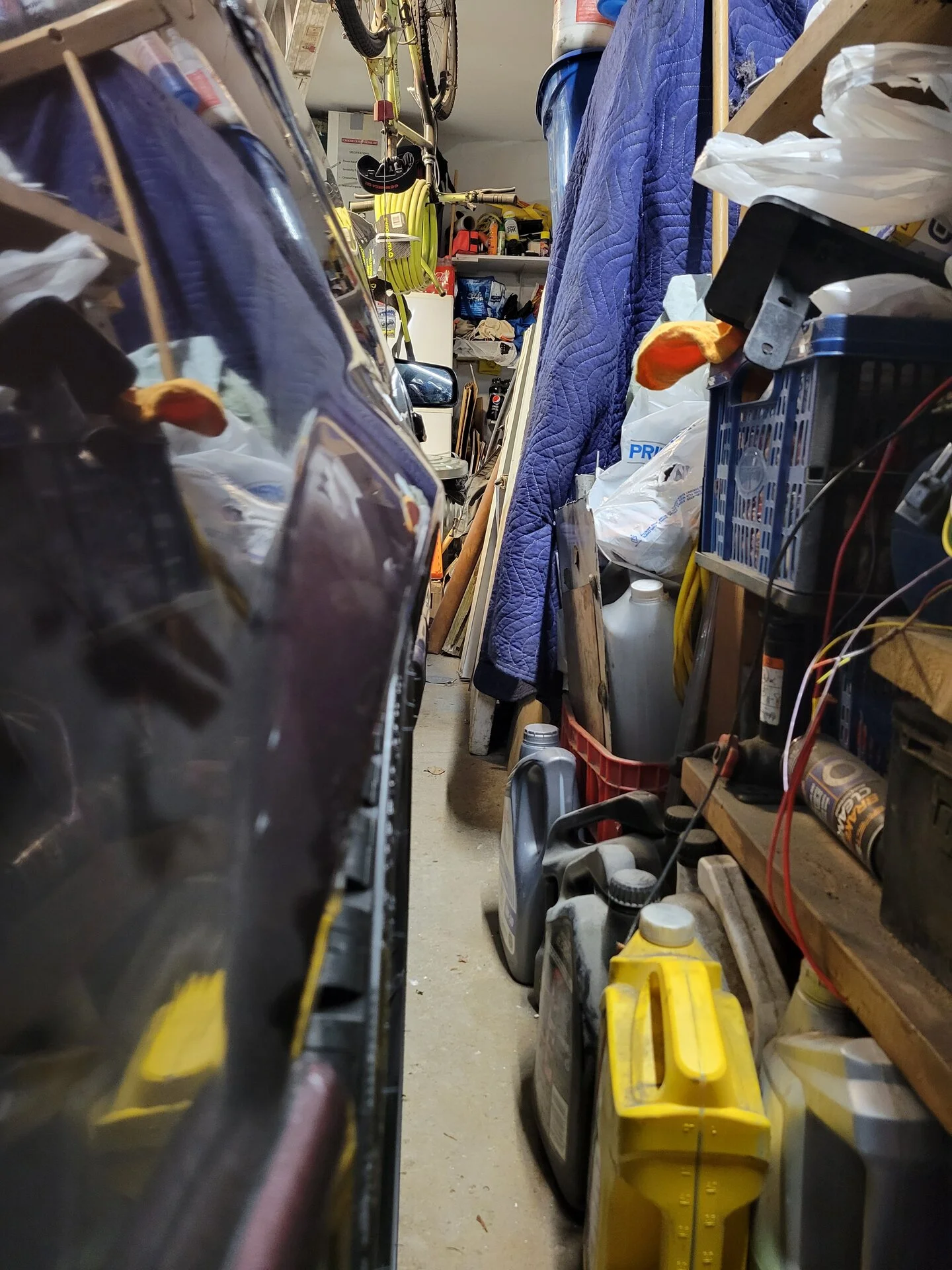

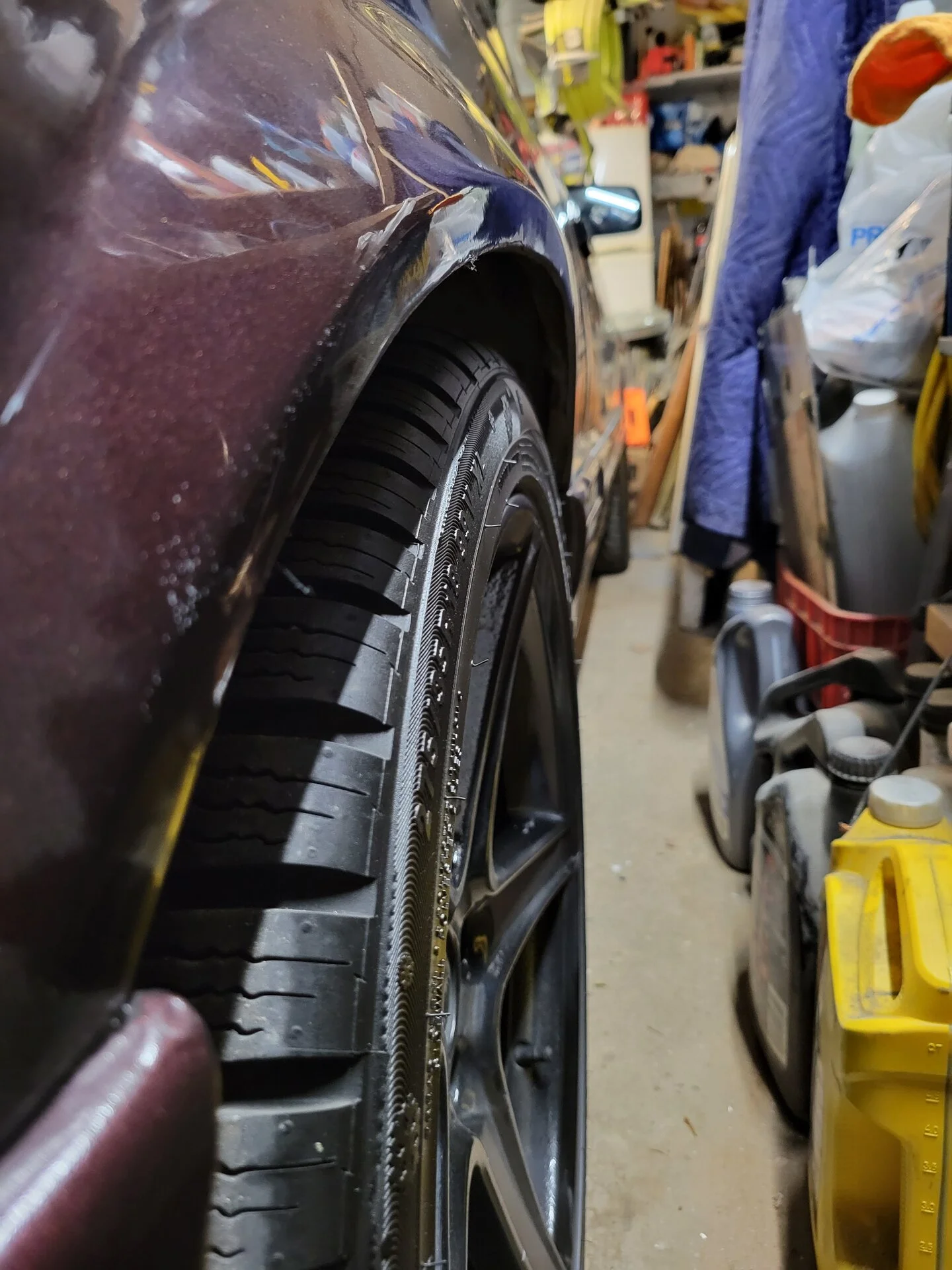

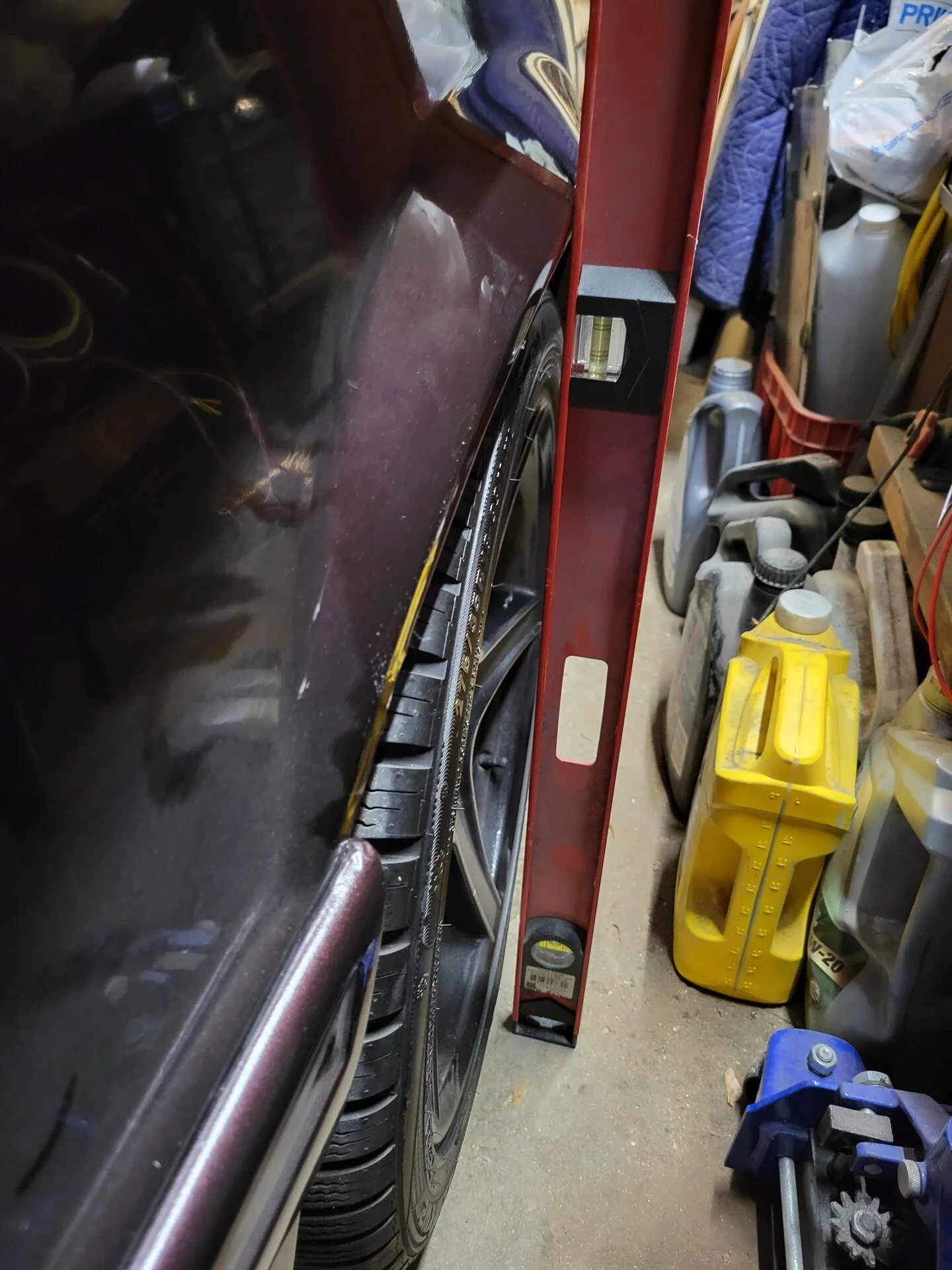

The best way to know would be to test fit the wheel you would like. Saying that, here is my thoughts based on my current wheel setup.
My wheels are 18x9 with a 24mm offset. I am also using a 5/16" wheel spacer (8mm). I have fox length axles as well and I rolled the fender lip when I was doing body work before I painted the car. So what is shown in the pics would be equivalent to an 18x9 with 16mm offset with no spacer.
You want to run a 17x9.5 with an 18mm offset on fox length axles. Those rims would put the rim edge approximately 4mm (5/32") further out than I current show in the pics above. The level in the third pic is vertical based on the bubbles and is touching the outer fender edge.
If you used the ET38 offset rims with 94-98 axles you would be almost the same position (only 3mm - just under 1/8" - more outward than my set up shows)
Just my thoughts, hope it helps.

You would be 22mm (almost an inch) inward from what my pics show. I would be concerned with rubbing something on the inner fender or shock ( I have not looked at mine lately to know how much clearance I have to compare).

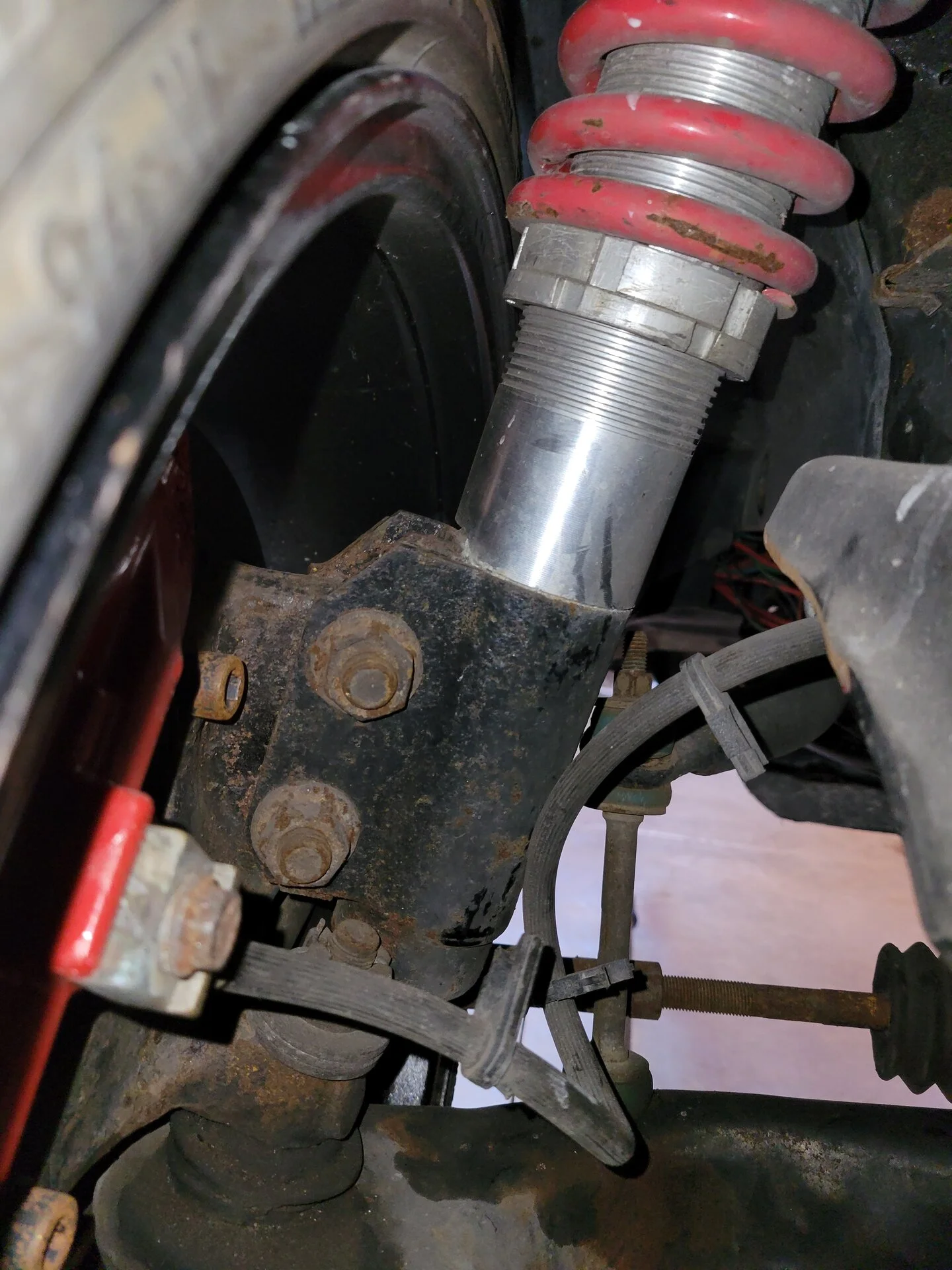

My wheels are 18x9 ET24 all around. I have a 255/35/18 in front and a 275/35/18 in rear. I have coil overs in front and needed a spacer to not have the rim rub the coil over.
Driver front with spacer, otherwise bottom coil rubbed on inner rim lip. Because I am using a tire that is shorter than stock (25.2" diameter vs 25.8" OEM) I don't get rubbing on inner fender like my 245/50/16s used to.

Coil-overs up front might create a clearance issue, depending on the backspacing of your wheels. I don't use coil-overs on my cars, but I suspect my current setup would hit coil-overs up front.

Yes, front MM coil-overs in that pic, with conventional springs and adjustable height arms out back.
With the 235/45/17 up front, i have no rub, even lowered. However with 245 i have slight rub but livable. I'd rather have the extra rubber up front for braking
