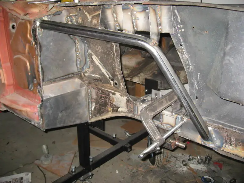

2. I'm still looking for suggestions on extra bracing for the front end....maybe I can run a brace from the firewall, under the fenders, then down to the frame rails? any pictures of any extra bracing would be cool.

Here's what I did to reinforce the front end in my 67 coupe. I ran the brace from the corner of the firewall to the frame right in front of the springs. I also fabricated some additional bracing that connects to the inner fender so there would be something substantial to attach an export brace to.
There are more pictures in the MII thread that Reenmachine started last year.
