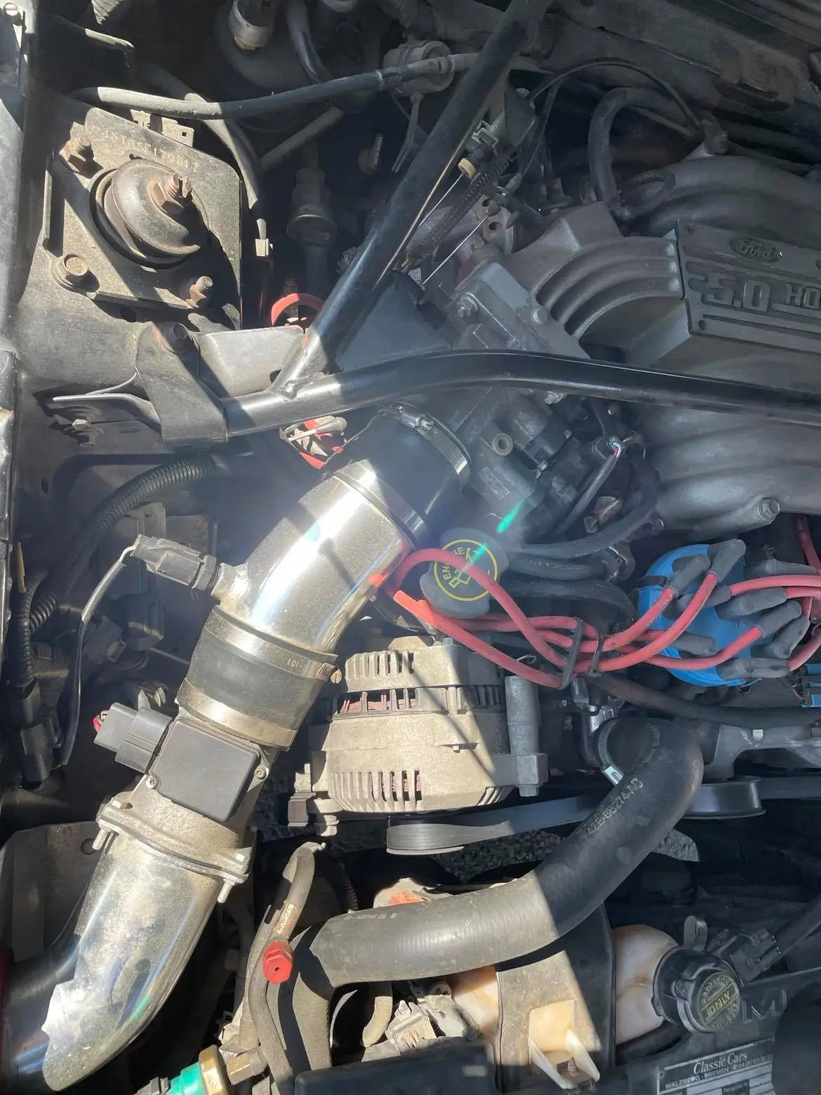

Hi all, One week ago I fulfilled my long dream and bought my first Mustang (1995 GT). I have searched on internet but can't find out what is wrong. Maybe someone of You who are wise, have more experience and knowledge than me, can help me find out whats wrong? I am forever grateful for any ideas and advices
View: https://www.youtube.com/watch?v=Cw7CEVvVPZM
It is time for a mechanic’s stethoscope to narrow down what you are listening for.
So to say what the General said, but with more words, the whistle/whine in the first part sounds like an aftermarket throttle body with a functioning IAC. The second part sounds like noises from the accessories and water pump, fuel injectors and who knows what else.
I can hear this high-pitched noise in the first part, then what sounds like a chirping bearing in the second. But those are just guesses, so you'll need to narrow it down. You can buy a mechanic's stethoscope, or you can do the cheap route and use a long cardboard tube - the one from a roll of paper towels will work. Stick one end up to your ear and hold your hand over it and your ear so you can't hear anything else but what's at the end of the tube.
Move the other end around the engine bay until the sound gets louder, and you'll be able to narrow down where the noise is coming from.

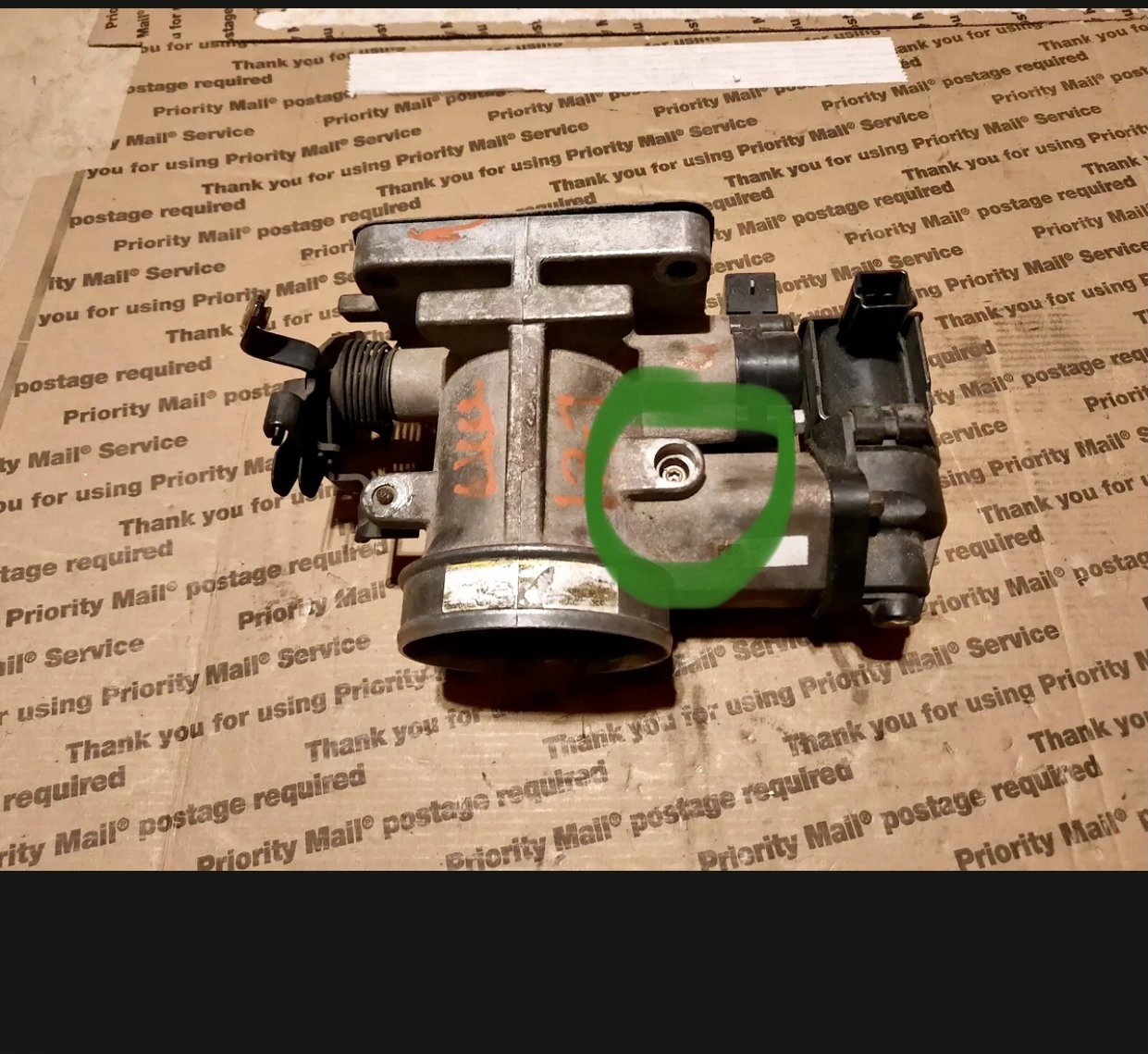

I would clear throttle body and discover an odd solution but do not understand what the self-made part does by someone and i thing this makes a strange voice - you are right :). I don't understand why someone but a metal piece on throttle body (what does it help) . Could you help me please to understand need of aluminum piece on throttle body.
View: https://www.youtube.com/watch?v=UelDzQRzx6k
That is a home made restrictor plate, a way to reduce the Idle Air flow. It is likely they do not know how to do a base idle reset, or the IAC was stuck open.
You are right again :). I've removed the "home made restrictor plate" but rpm start with 2000 :(. I wonder how can i base idle reset ( i've been searching almost 2 hours but can't find anything except "there is not a stop screw on 94-95 mustang") . Shall I need to replace throttle position sensor and Idle air control valve, if i can't reset?

OK, now you have gone through the list and eliminated most of the possible problems. Now your mechanical and electronic problems are fixed, you can set the base idle speed.
