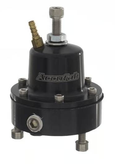

That's a pretty solid price on the accufab, especially when the aeromotive is $250+.

FastDriver said:
Erm... I thought mine was an aero when you mentioned it, but it's an accufab. Can you send it back? Just tell em it didn't fit a stock setup. You might like this one more:
Damn! Thats a nice piece. Wish I would have known.
That price was from my order email from maybe late '24. Bought from Lethal Performance and its $159, now:
Accufab 86-93 Mustang 5.0L Fuel Pressure Regulator
Accufab has developed this fuel pressure regulator to optimize your fuel pressure needs. The regulator is crafted from high quality billet aluminum and anodized black. Then, each is assembled using only top quality internal component parts. Also, each regulator is adjustable and boost sensitive...
www.lethalperformance.com
Regardless, it's still way cheaper.
Some companies just gouge on the prices just because they can, i guess that is aeromotive and pertronix...
Reactions: FastDriver

Well i actually did pretty good on the Aeromotive. Got it off Amazon for ~$200 from the Aeromotive store because I could get it next day.
Sold as new, arrived opened up (typical Amazon). I bitched at Amazon and they knocked $65ish off for sending me an opened part that someone had put teflon tape on the plug and vac port and sent back. So $140 was the damage. I was fine with that because there were zero signs of it actually being installed. No gas smell. No compression on the O-rings. Screws looked unused. No scratches. Had i seen any signs i would have sent it right back.
I will say, it's dead on with regards to holding pressure stable. With the kirban it was up and down 1psi or so in an oscillating manner. With the aeromotive, i set it to 39.2psi (because the 47# injector data I have is at that pressure) and it just held that. Pretty impressive.
But yeah...after the fact I kinda wish I went with the Accufab. I think for some reason I just didnt realize it had the port to install a gauge as well.
But yeah, need to start the engine and lets see if this fixes anything and then we will go from there. I got the intake back on late last night. I want to install my pressure gauge first and then we can fire it up and see.

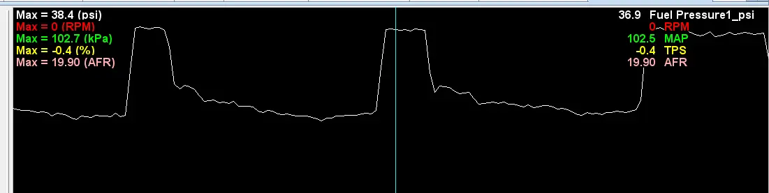

DIDNT MAKE A DIFFERENCE!
Argh. TBH is is frustrating. No change. 9psi loss in static (vac off plugged) pressure during a simple rev.
I also have about a 5 psi differential between the transducer mounted in the reg, to the mech guage at the stock location. Regardless though, I see the loss on both.

Interesting observation after the fact.
Engine running. 44psi on transducer, 39psi on mech guage down by alt.
Engine off, run the pump: both read 36psi.
I wonder if i need to play with my voltage compensation in TS. Might have something to do with the different readings at 14.4v vs 12.4v.
I gotta play around with some things before i drop the tank. I'm just going to be testing various things out right now and might not update for a while

Ha. Meant gas. Not water. Safe way of running gas outside of a tank without dropping too much coin.
Did some more testing and called it a night.
Engine off, pump running. Used a mityvac to apply vacuum. Pulled enough vac for pressure to drop from 38psi to 31psi. Released the vacuum.
Instant spike back to 38psi. No dip at all.
I gotta let this stew around a bit in my mind. That's essentially a vertical line back to full pressure. Am i chasing some sort of tuning/calibration issue?
Like said, going to play around with a few things first. But i wonder if I tore my entire fuel system apart over a tuning artifact? Thing is...car actually drives pretty darn good. If you asked me if i thought it was running a tad rich, i'd say yes. I need to check a few things, including my injector settings. I could have something way off which is causing injectors to open for much too long with the 47#ers.
I actually realized I can use the mityvac with the engine running. Would simulate no load release of vac to atm which should cause a pressure spike from 33-34 up to 39+. If that line is vertical, than it's gotta be my injectors dumping way too much fuel
