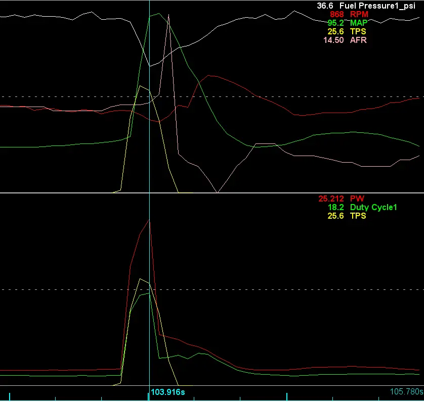

"and during the blip it drops to 11.8 and then instant 19.0. (I think this is actually a excessive rich condition)"
Not likely. This is ovethinking. A lot goes on when you blip the throttle:
1. tip-in/accelerator pump fueling
2. every cell in your Load/VE table that you travel through.
3. dMap enrichment on acceleration
4. dMap leaning on deceleration (probably causing the spike)
5. Compensation for voltage regulation (injector data)
And whatever else that's not top of mind. What makes your claim unlikely is that I've never seen an AFR gauge that was unable to drop below 11.8:1. You'd get into the 9s, probably, before having spark issues. So, it's more likely that your dMap is commanding a pull back in fuel that's too severe. That said, you cannot hurt the engine on decel like that. There's just not enough fuel to result in detonation that can hurt anything.

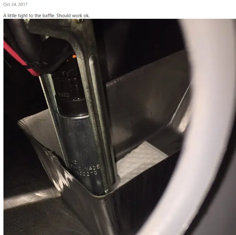

I had to search back in my posts and found this pic.
Pump does sit tight to that baffle, and the sock in the corner is bent up slightly.
Why i didn't think much of it was because at the time (2017) i had a mech fuel pressure gauge on my cowl and was chasing a hesitation issue. It ended up being the accel coil, but i have some posts where I state it holds 39psi at wot fine.
Obviously now I need ot go back and check this.
EDIT: also, i did have 3/4 of a tank in the car when this all started. I remember grumbling about having to siphon that all, so I don't think it's fully a baffle issue.
I wonder if my comment from 2017 is accurate. Wouldn't it be something...

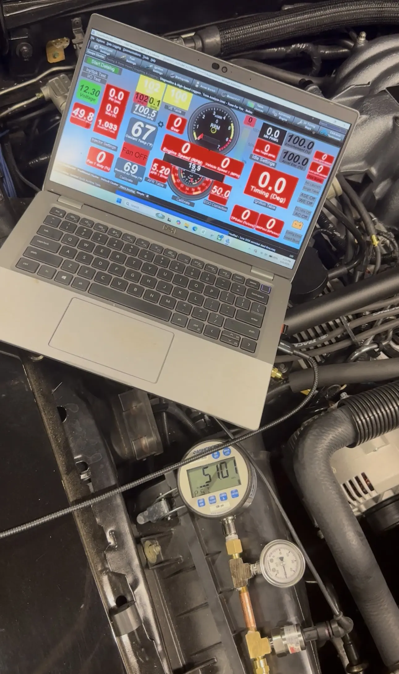

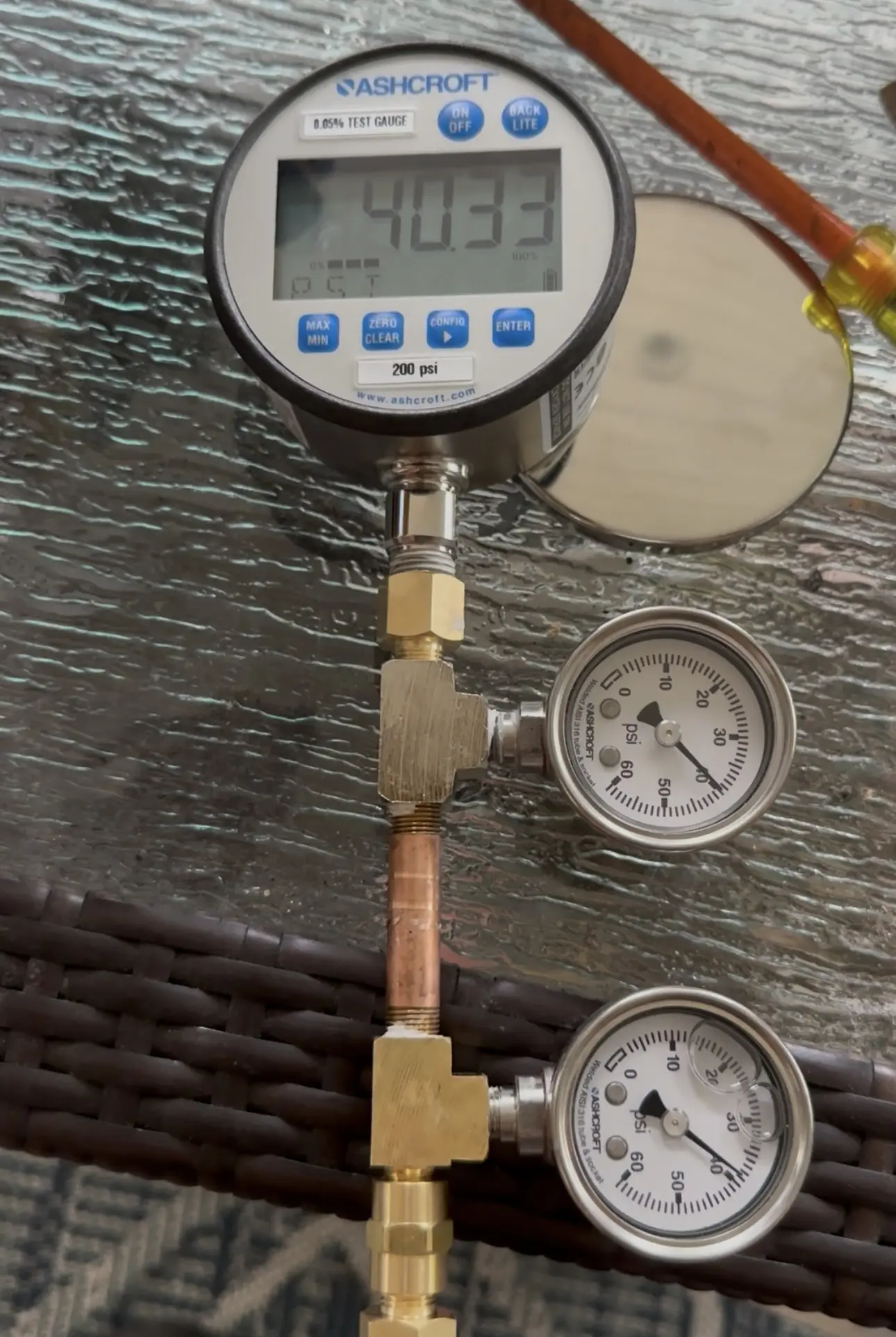

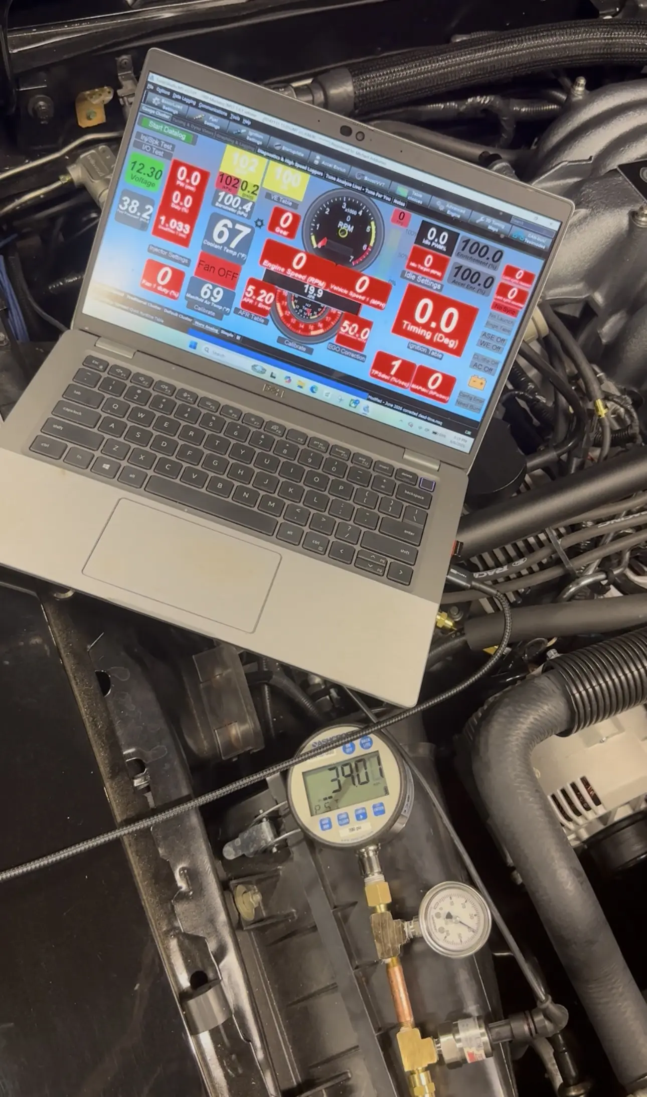

Ok. Another mystery.
I wanted to triple check my guages. Borrowed a test guage from work and setup this little rig to verify. I ran it from 50psi down to 20psi taking a video and then comparing pressures. Bottom liquid gauge was off, so that got retired but top one was spot on.
So take itto the car and add the transducer. I'm using pressurized air at this point but do the same thing. Fill to 60psi and bleed it down to 20psi.
39psi on my nice gauge was 39psi on the mech and 38.2 psi on the transducer
51psi on my good gauge was around 50psi on the mech and 49.8psi on the transducer.
SO lets call it 1psi low on the transducer. Knowing that, i figure i can set the pressure to 40psi and that's good enough.
So i set up the gauges on a tee at the regulator. You can clearly see them in the pic. I fire up the engine
Mechanical gauge is reading 37psi and the transducer is reading 45psi! WTF? Remember, i ran them both up to around 50psi and down and they were within 1psi of each other.

And the data log.
Pressure sitting at 45psi. Quick rev and it drops to 36psi. AFR goes lean and duty cycle goes from 1.8ms to 18ms trying to add fuel.

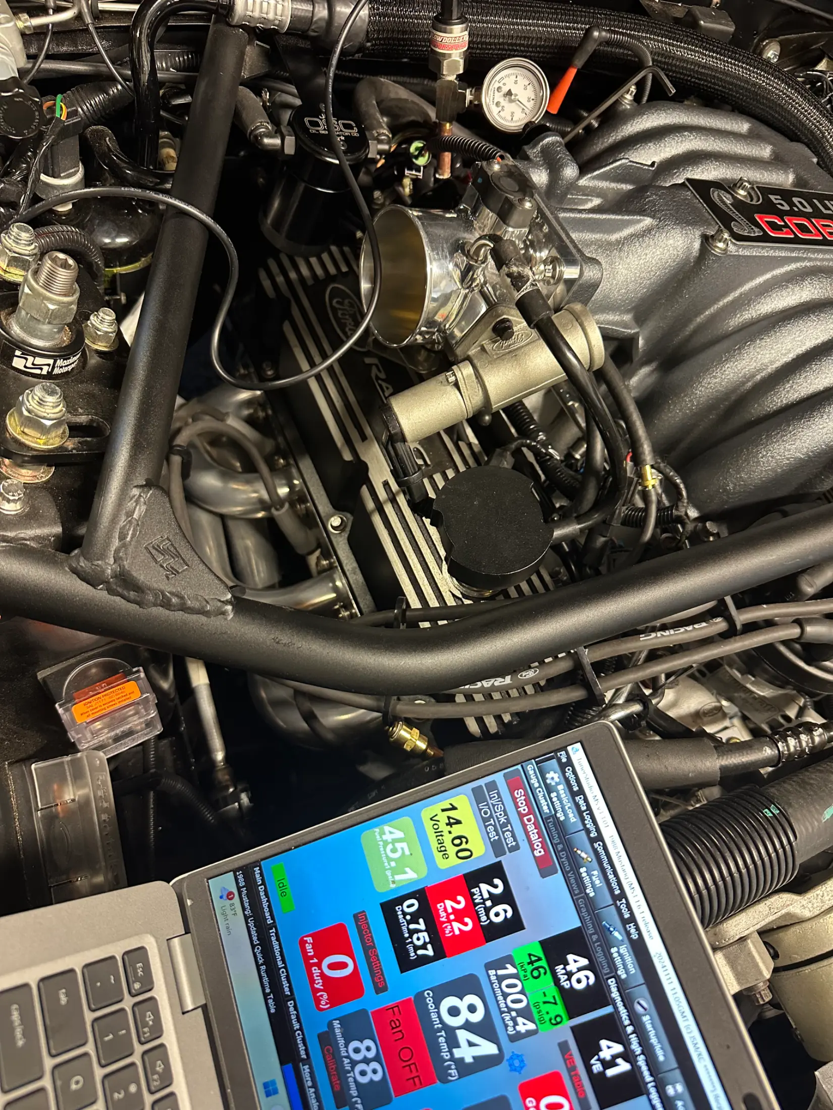

  • #440
FastDriver said:
Put a multimeter directly on the transducer signal wire while the engine is running and compare voltage to what MS reports.
Took me a min to figure out how to get what MS is reading from that sensor which is Analog in1 that i have it set up as. I can set it to display volts, but not at the same time as pressure or i get conflicts. Requires a key cycle. SO next time i run the engine i'll see what MS is reporting for volts and manually convert that.
But, 12V engine off. I cycle the pump. 37psi on the transducer, MS is reporting 2V and i see 37psi on my mech gauge. SO far so good.
Too late to start engine now so i'll fire it up tomorrow and see what happens. Maybe i'll swap the transducer and guage and see if any difference.
