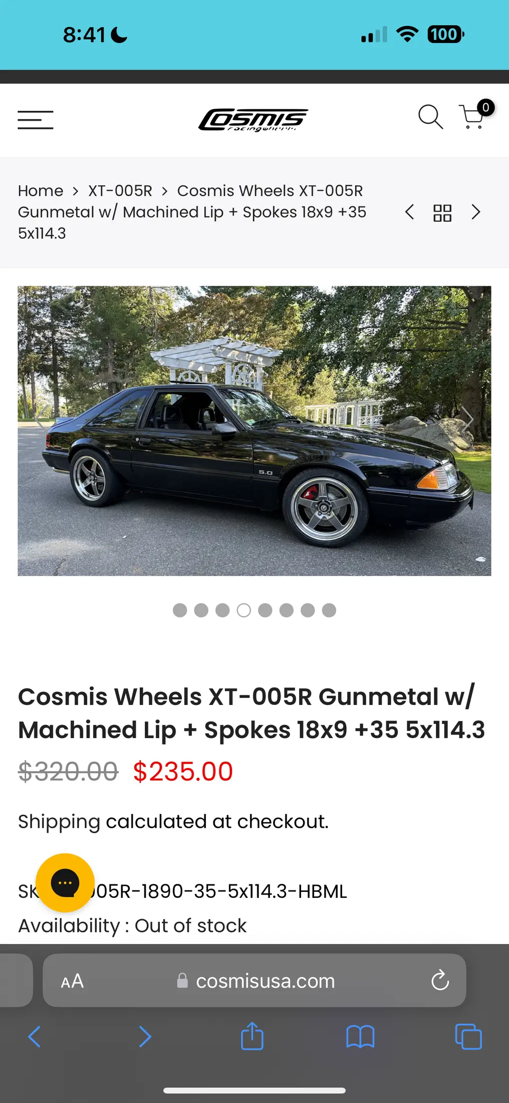

These wheels also got cheap… hmm…
I admit. I like them, but I’m not in love with them.

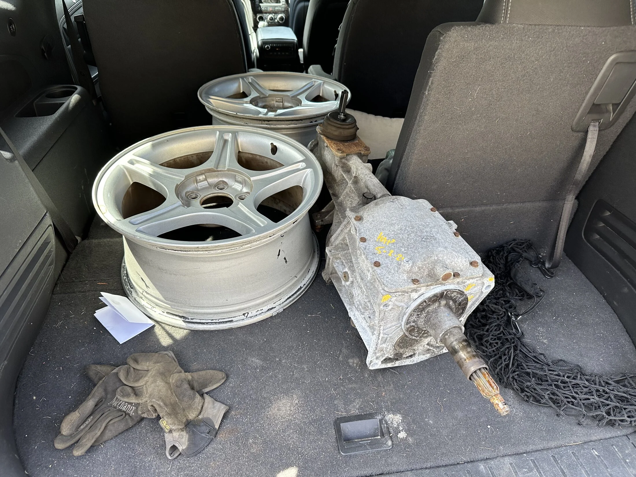

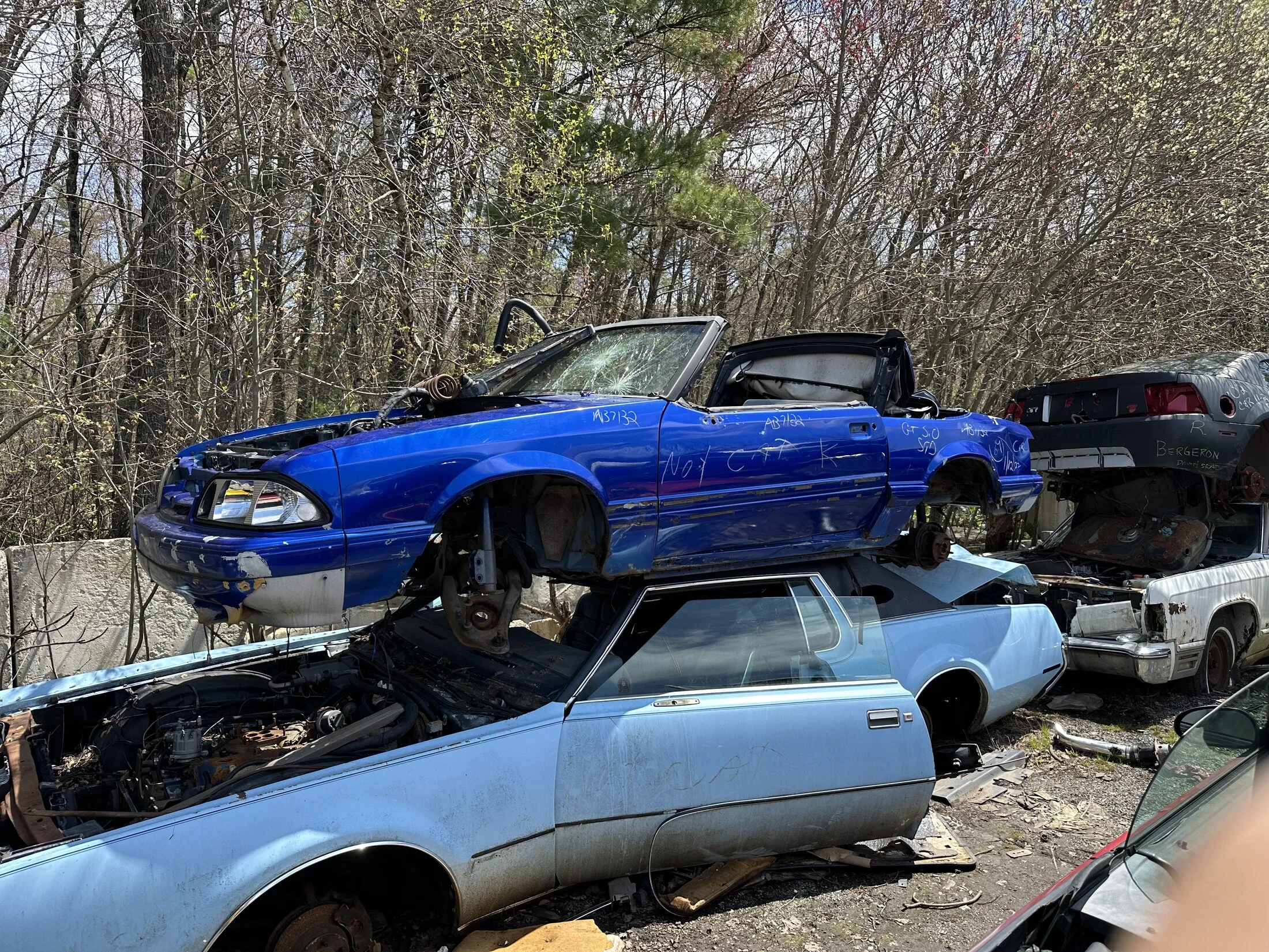

Driving past a junkyard today. This one is out of the way for me so i had a perfect chance to stop in. Wanted to see if i could locate a 01-04 black trunk lid. They had a 99-00 trunk lid but i passed.
Saw some cool stuff. A few 5.0 Fox cars there. Nothing really left that caught my attention as something i'd want to take.

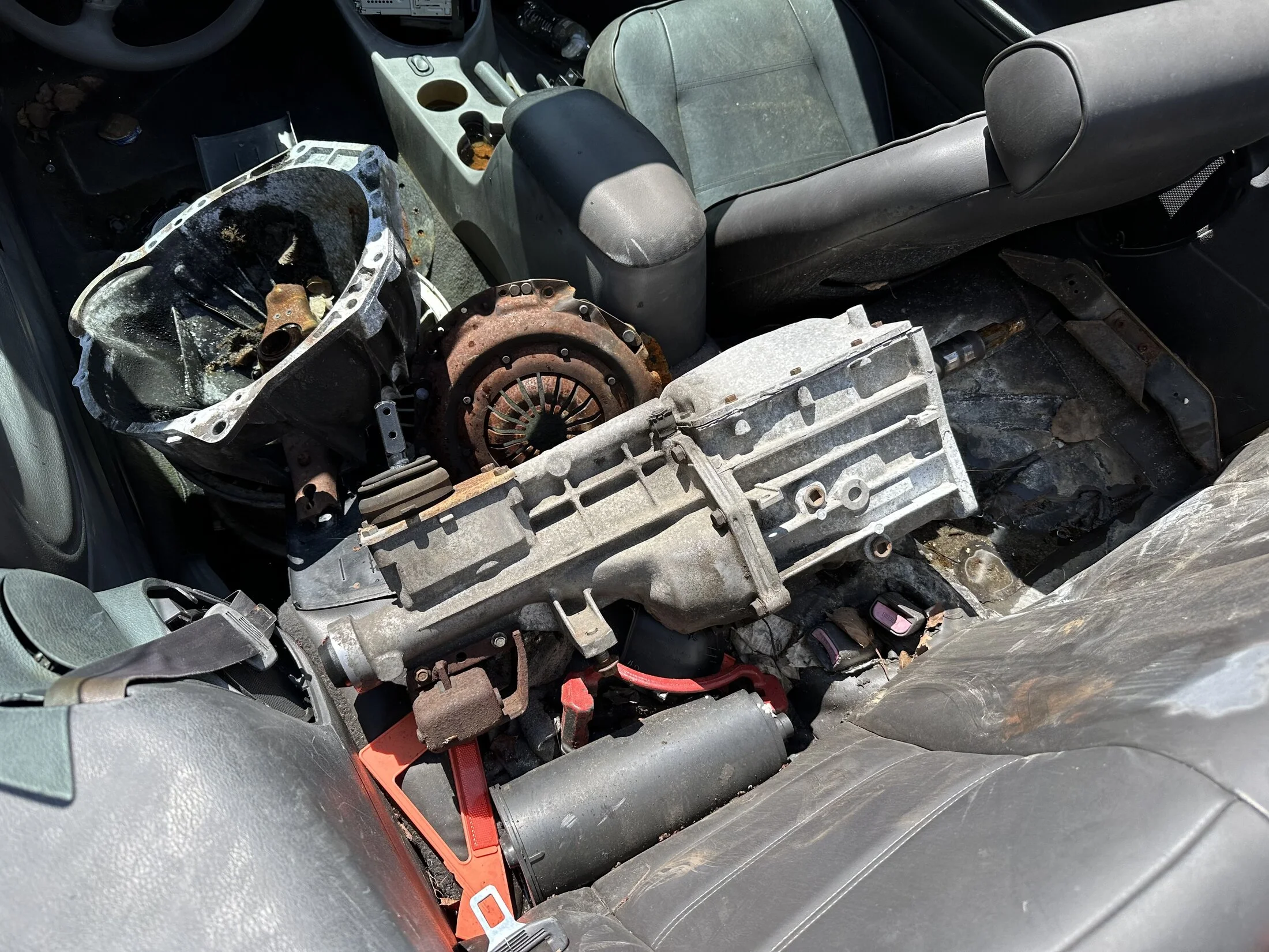

Heading out, i walk through the back looking for SN95s. Low and behold!
$100 later and a LOOOOONG walk back to the front carrying this thing (it was in the back). It's mine.

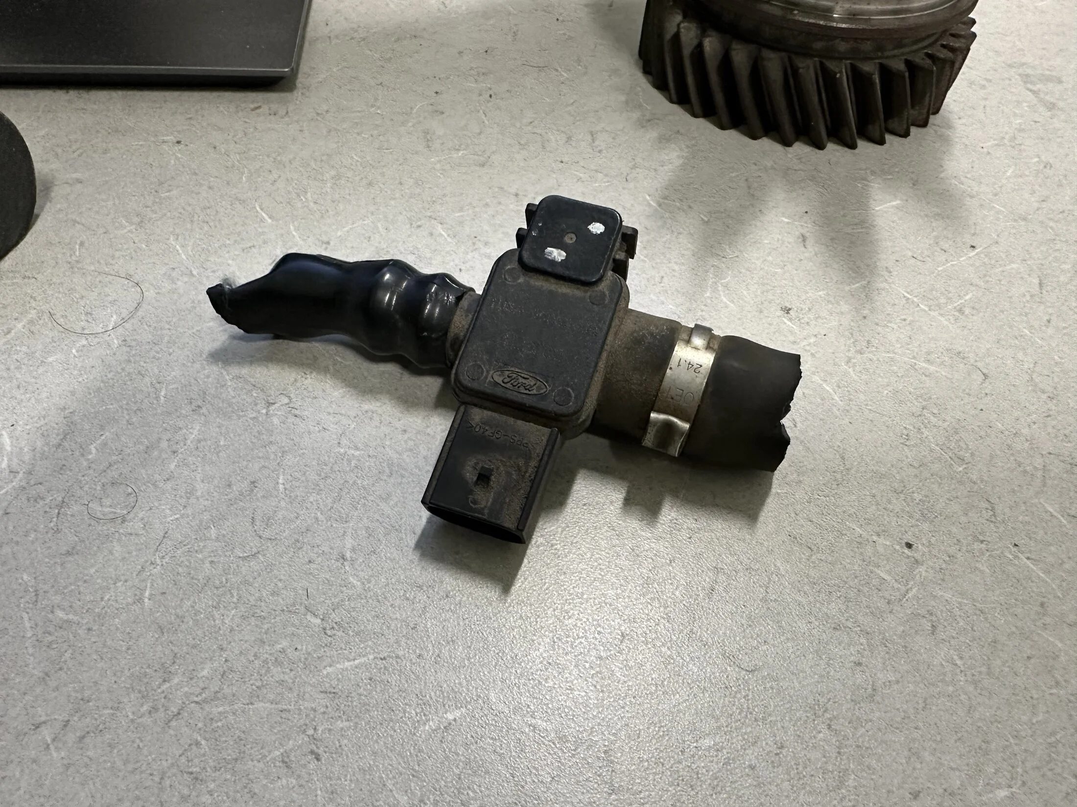

Also snagged a 99-04 fuel tank pressure sensor since these are unobtanium now. Tank was on the ground so i just cut it off. Scoring all around.

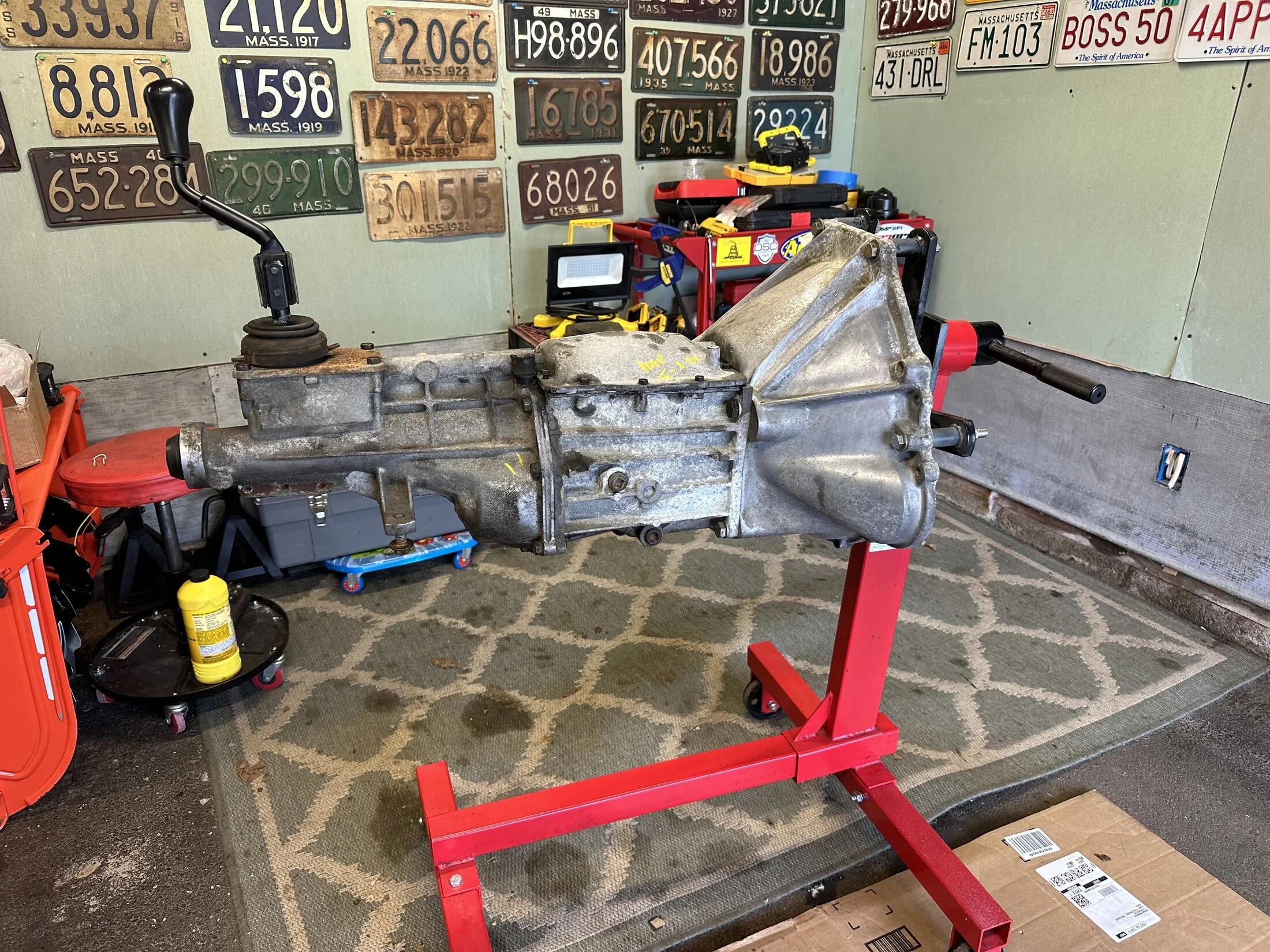

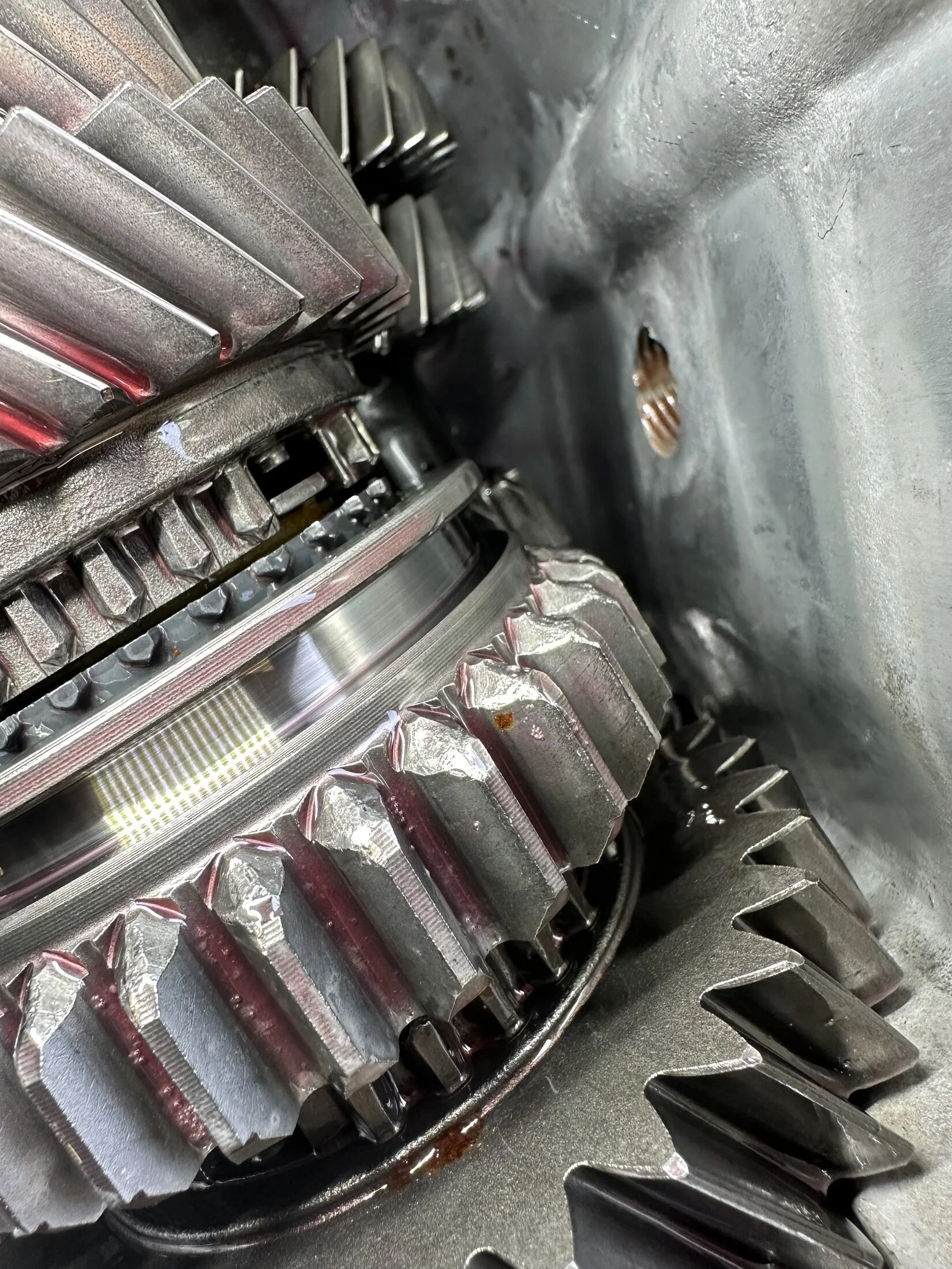

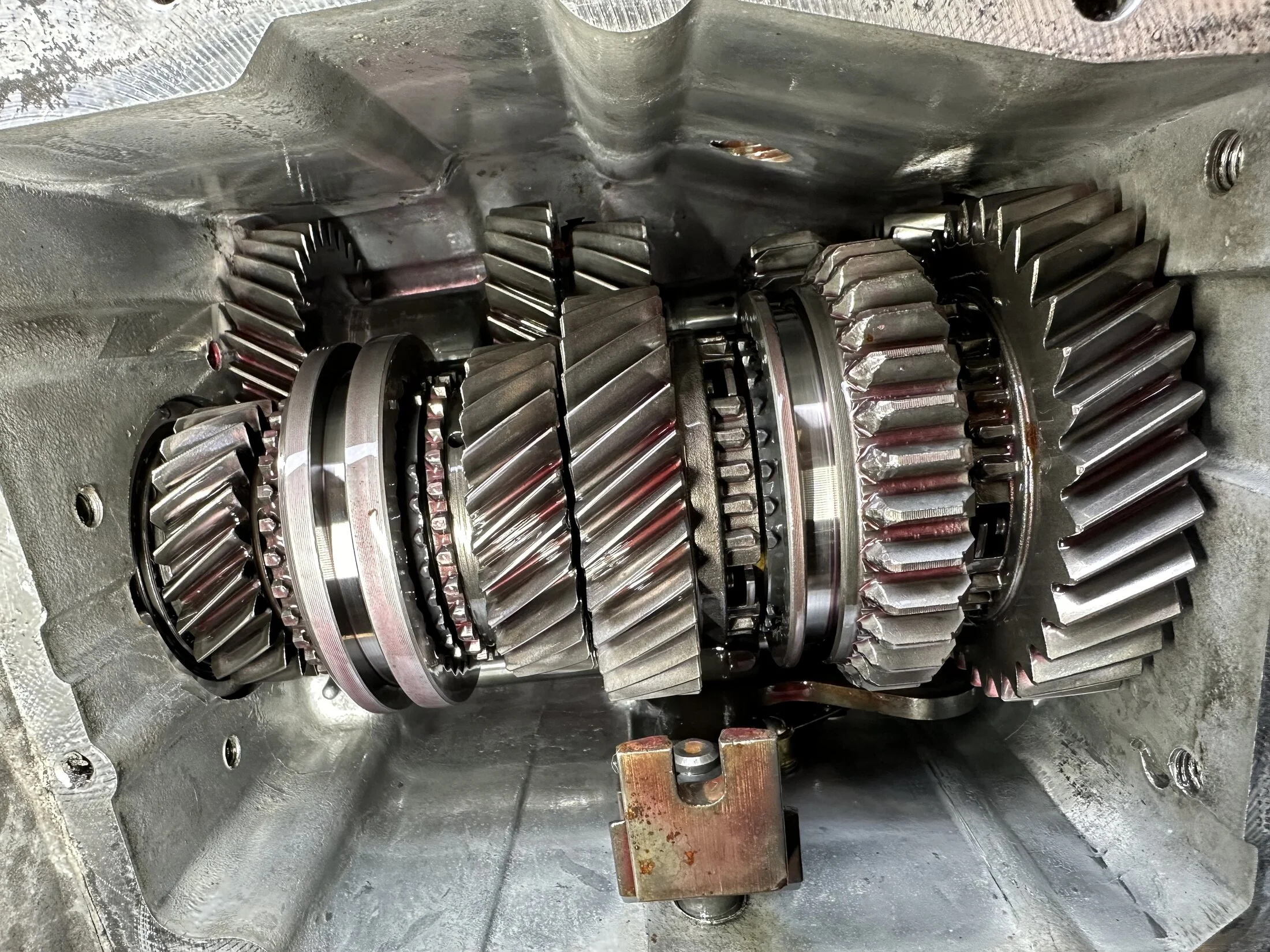

tosses it on my stand and pulled it apart to inspect. A little water inside but it hasn’t been sitting long so no rust. Flushed it all out with atf and checked everything over
Everything looks good in here. Will have to disassemble further to really inspect, but no chipped teeth or mashed up blocker rings/dog teeth.
Only real damage is a mashed up reverse slider. Guess the original owner liked to grind into R a lot, even though this trans has the reverse brake. But as you can see all the other gears look nice.
Sealed it back up, added 1 quart of ATF and will stuff it in the corner. Will be a winter project to make it fox compatible.

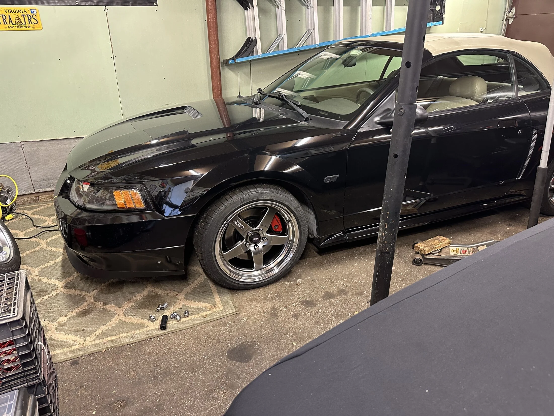

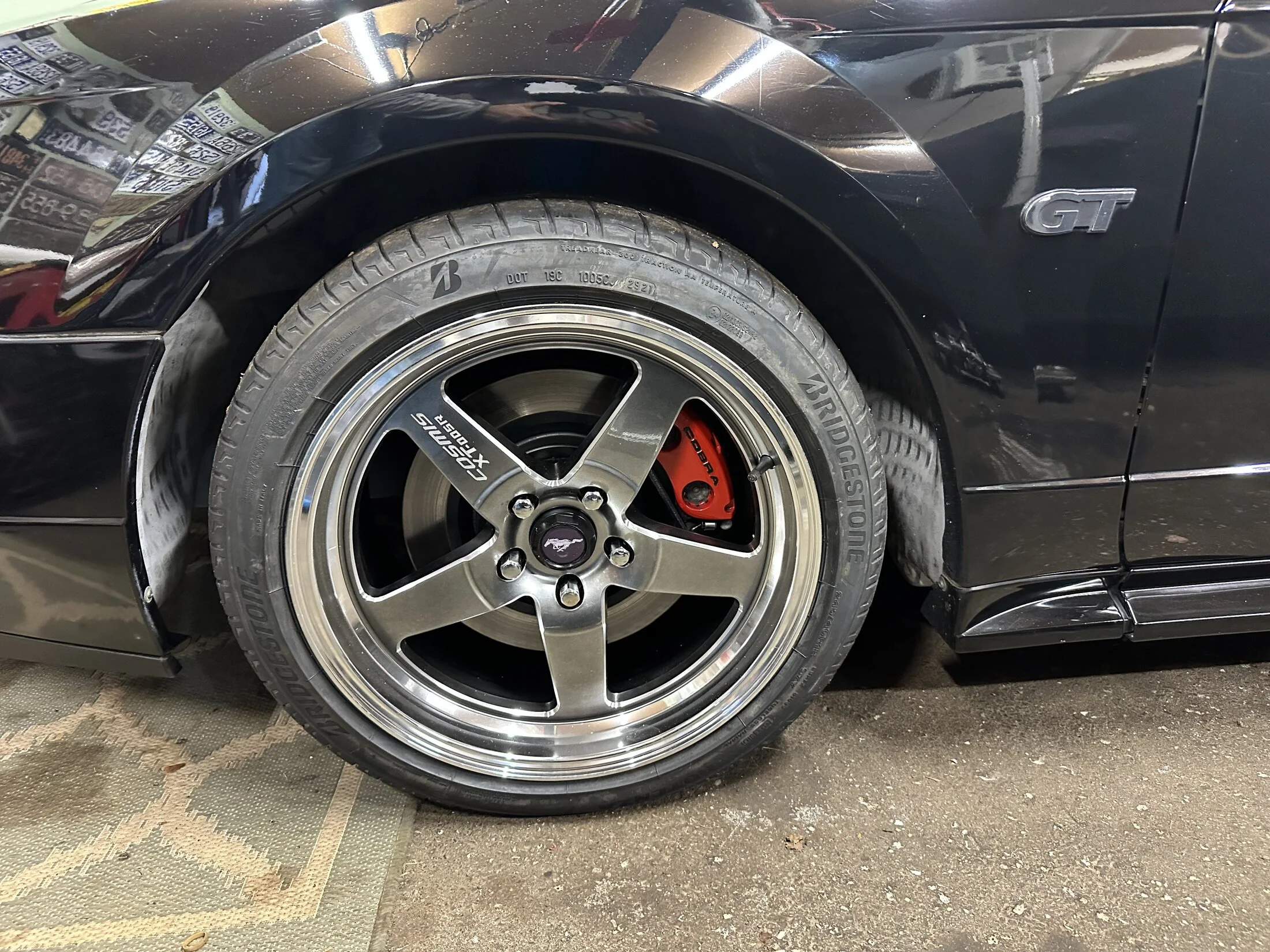

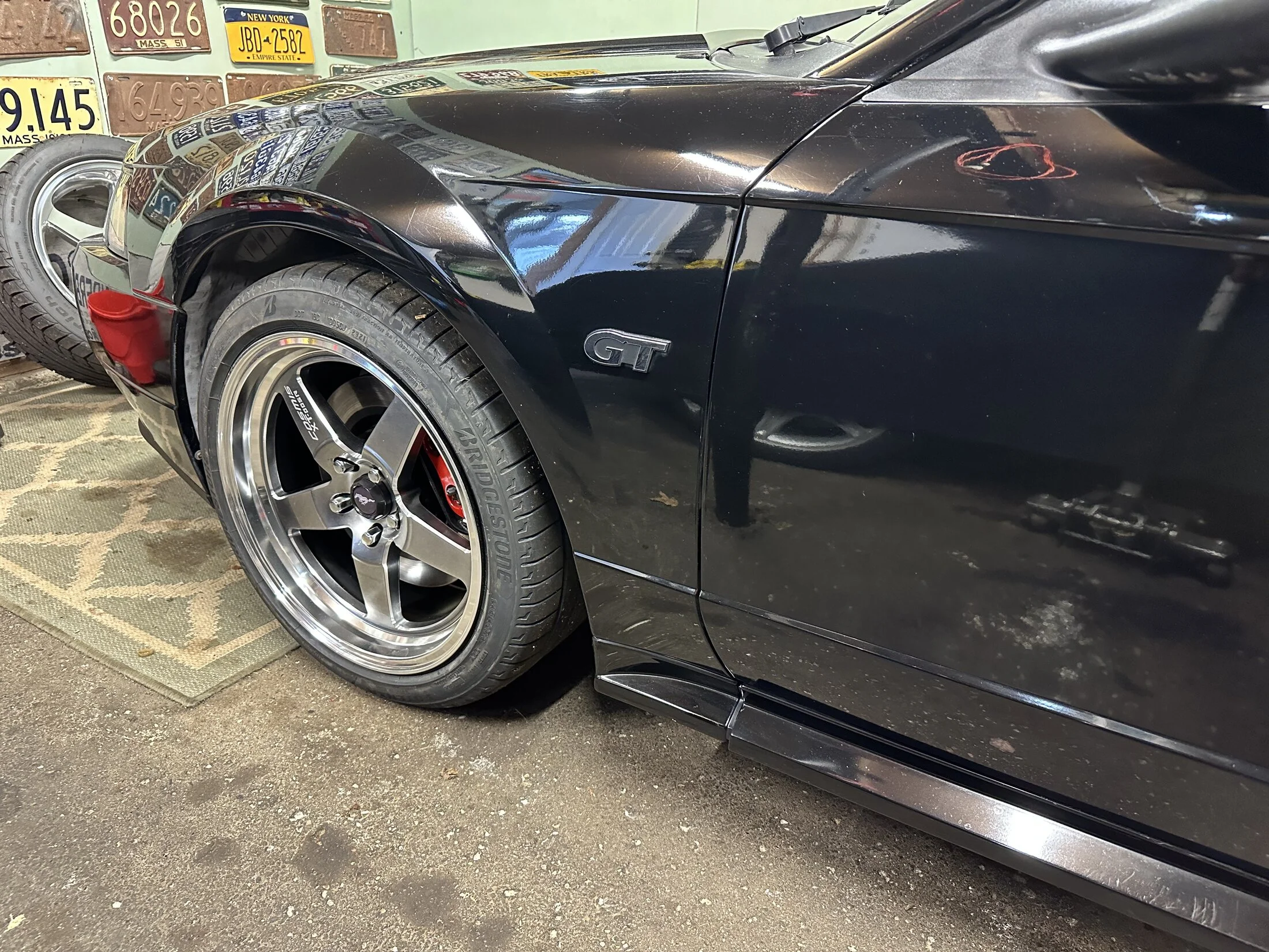

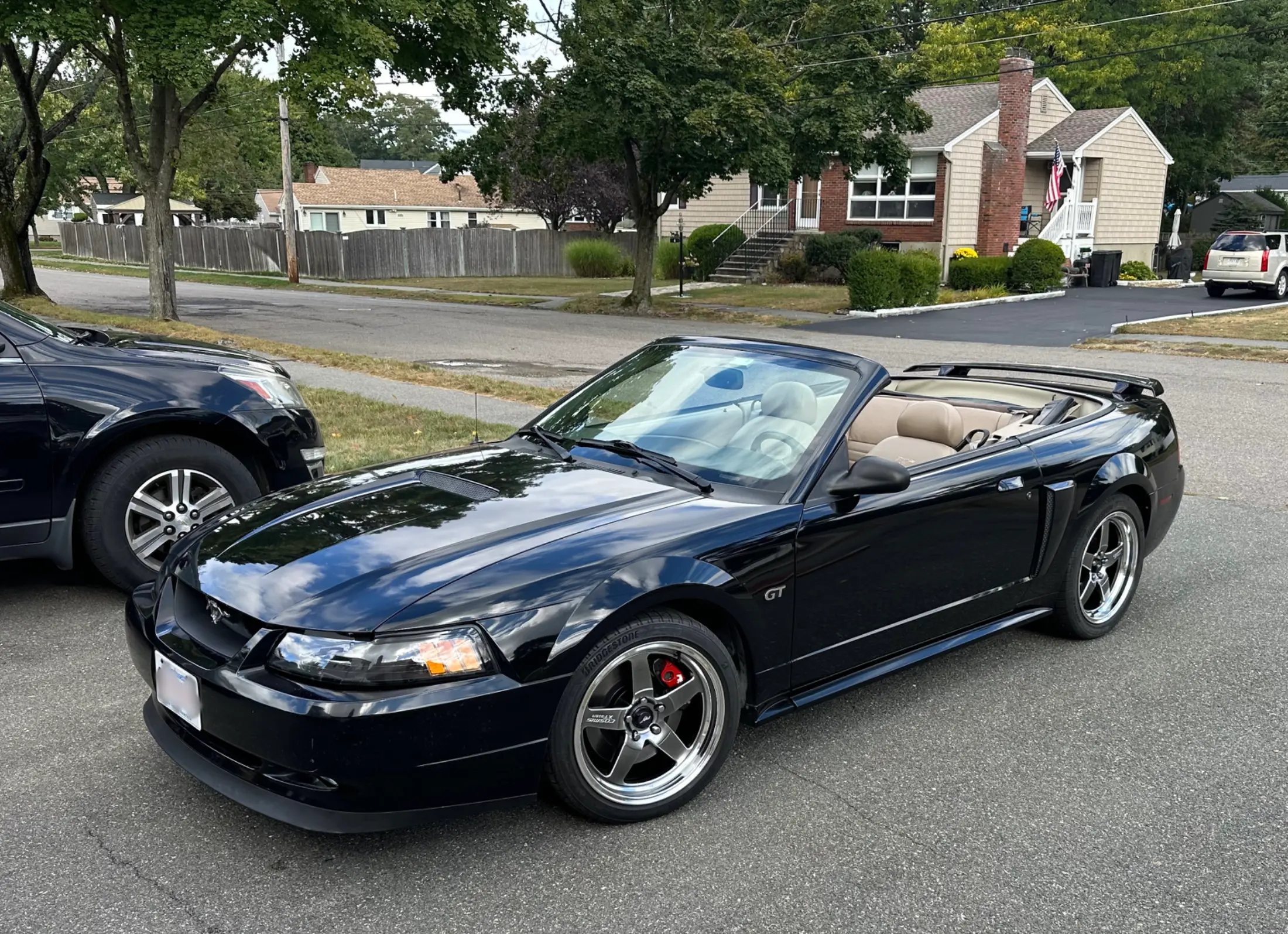

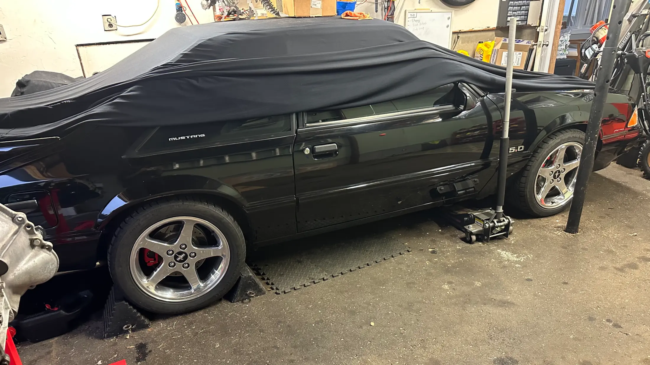

Swapped my wheels back
Wasn’t feeling the 18” wheels. They looked great in photos but in person I felt they were too big for the car. Looked like 4 giant blocks under the car.
Stuck then on the SN95. I like the proportions better. I think I’ll be looking for a new wheel for the fox…
Ok, well this works nicely on the SN95. I really like the wheel on this car. The proportions match perfectly, and the car still rides nice with the 18s. I ceramic coated the wheels and took the car for a nice ride. Still need to install the hood scoop
That means I’ll be looking for a new wheel for the Fox for the spring. I’d like to at least run a 9” out back, and something that will clear ATS brembos up front so I can put those on.
I kinda want to stay with my “It could have been made by Ford this way” theme with the car. The new wheels will be 17”, and prefer a wider tire out back. 17” pony wheels are something I’d consider, but I’m also considering something like a 17x8/17x9 1998 Cobra wheel setup from LMR. I really liked that look when I have my 98 cobra wheels on the car.

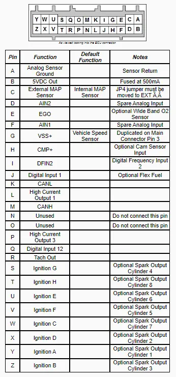

MS3pnp is on my bench and im sorting through wiring diagrams. Really my only question is wiring in the 2nd wide-band O2 sensor.
Pin E is for one wide-band, so really I need to figure out what additional pin I can use for the 2nd wide-band. I think I can use PIN D. I also need a output to use as a PWM signal for my fan controller. Not sure if I can use PIN L or P
